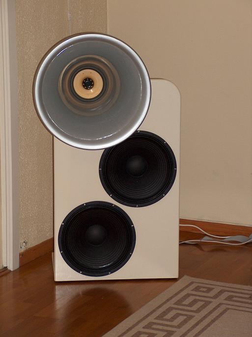

I'm going for this setup. The dipoles are finished and I'm very impressed by the sound. The drivers are Eminence Delta 15LF.
A pair of JBL SUB1500 are going to take care of the deepest bass.
Frode

Frode,
Those speakers look really nice,
I bet they sound pretty good, too 😉
And with those JBLs down below
they're probably even better 🙂
cheers 😉

After reading so much positive about OB bass, I just had to try it. It's nice that cheap drivers can be used with good results, the 4 Deltas cost me approx. the same as one of the 2226H I used before. Besides, the high Qts reduces the need for a big baffle. I'm looking forward to experiment with subwoofers in my setup.
Frode
Frode
