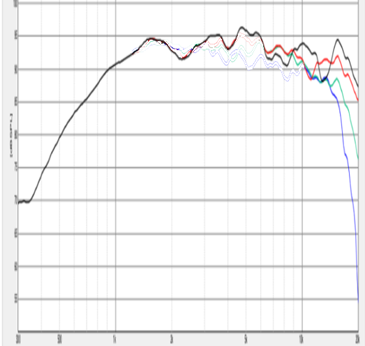

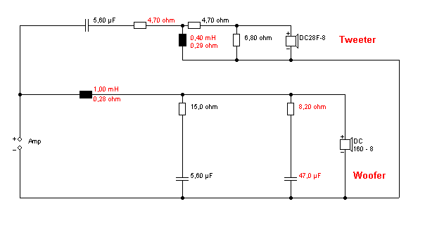

Ok,
Many thanks for the tip AllenB, unfortunately I have not so much material and experience to try doing it by "guess". I wish.
I spend the last day trying to mess with the crossover.
I changed some values from the original and so far this is the best I could came with.
What do you think of these curves? (see attached)
Are all fine, or should I try to reach other values?
How about the impedance (Ohm) is the curve good to an 8ohm output amp?

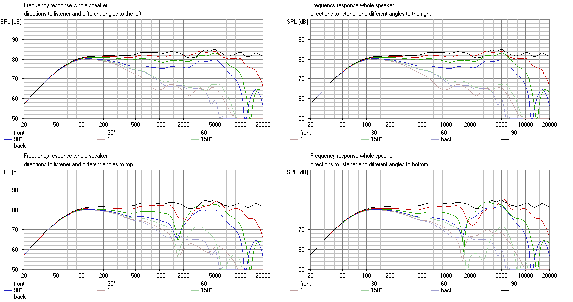

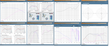

I understand perfectly, yet, this little free software I now use (recommended by tusker), includes the box/cabinet/enclosure design and wool too.
So, you can pretty much get something, virtually close to your method.
Yes, this software also reports all the graph analyses you require. (see attached images)

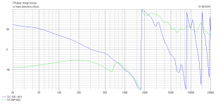

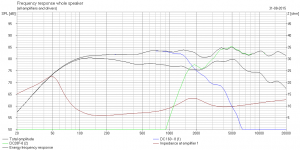

Ok, after review some "wrong" parameters I added to Boxsim (thanks to Lojzek for the help), I'm stuck at this point.
To keep the inductance and phase values sync I end creating a slope in the impedance.
Also frequencies in the xover zone are not coming very linear.
Any help would be appreciated.
See attached images.
An increase in the impedance at the crossover is not uncommon. The simple answer could be that it represents the lost power, where each driver is down 6dB ( quarter power).
Unfortuntely it isn't always that simple, but fortunately it doesn't always matter becuse although some issues will be reflected in the impedance, there are some aspects of the impedanc that don't directly relate to the quality of a crossover.
I occasionally consider the effect this will have on an amplifier and make corrections (without affecting the crossover). This isn't strictly necessary.
I would however be concerned with the wiggles around 2kHz.

Could you show the tweeter impedance on its own without crossover?

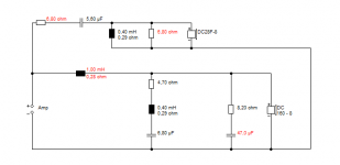

I've been trying to improve this mess. Here you have my most recent effort (crossover) and the result (response curves) to it (images in attach).

Putting all other aspects of the crossover aside for a moment, the bumps around 2kHz in the tweeter respopnse might be connected with the impedance rise. You might try reducing the value of inductance which will raise the crossover frequency and increase the Q factor. This might negate the wiggle without affecting too much else.
On the other hand it could help to use a filter to make the tweeter impedance flat to start with, especailly as it is a complex (double) peak.
In the bigger picture though, have you decided on a crossover point? You may have some work to do on trimming the woofer breakup and matching directibity.

About the xover point, I'm aiming to 2500Hz, since the Woofer does not reply very well above 4000Hz (Daytons says).
Nevertheless, I believe I can use the woofer effectively up to 2500Hz but I don't trust to it anything above this value.
The tweeter on other hand also does start responding from 1300Hz up, so, I'm tented to consider 2500Hz the best xover point (2650Hz is the middle of overlap mix 1300-4000).
On the other hand it could help to use a filter to make the tweeter impedance flat to start with, especailly as it is a complex (double) peak.directibity.
Well, if you see that last crossover image, I've done that. 🙂
Maybe the values are not the best ones?
I started by following your thread advice (formulas) and calculated the impedance equalization filters.
The result impedance was very flat, but then, I had to sync phase and mess with the frequencies SPL to harmonize the best response.
Unfortunately, this Tweeter seems to be very hard to fine-tune.
It shows a deep variable (wavy) frequencies response along the spectrum.

Hi!
I'd say the peak comes from the driver itself. If I simulate it without any crossover it shows the same peak. Further, if I were the to scale the original Dayton plot to the same X- and Y axis as the simulation, it reveals the peak is present there as well.
- My first crossover
