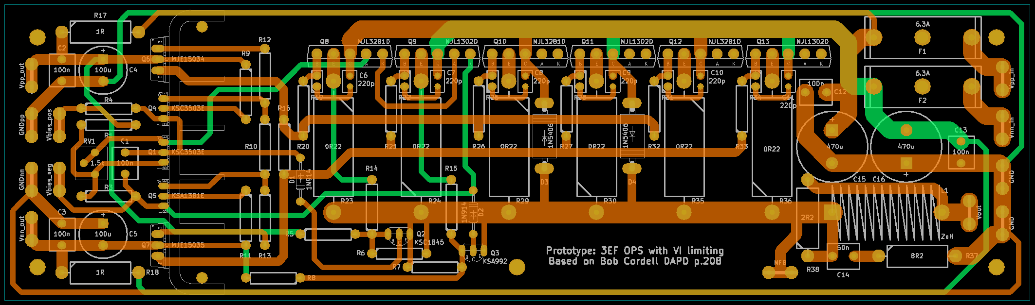

Please comment on this OPS layout
Having spent some more time reading and simulating, I think it’s about time to start some prototyping and testing, and cautious of the warnings I received about the VAS, I decided to first build the OPS in a separate board, so that I will have some flexibility on the IPS/VAS later. As my vero-board skill is very poor and printing PCB is pretty cheap (USD40 for 5 pieces of the below OPS board including shipping), I’ll go straight to print PCB for prototyping purpose.

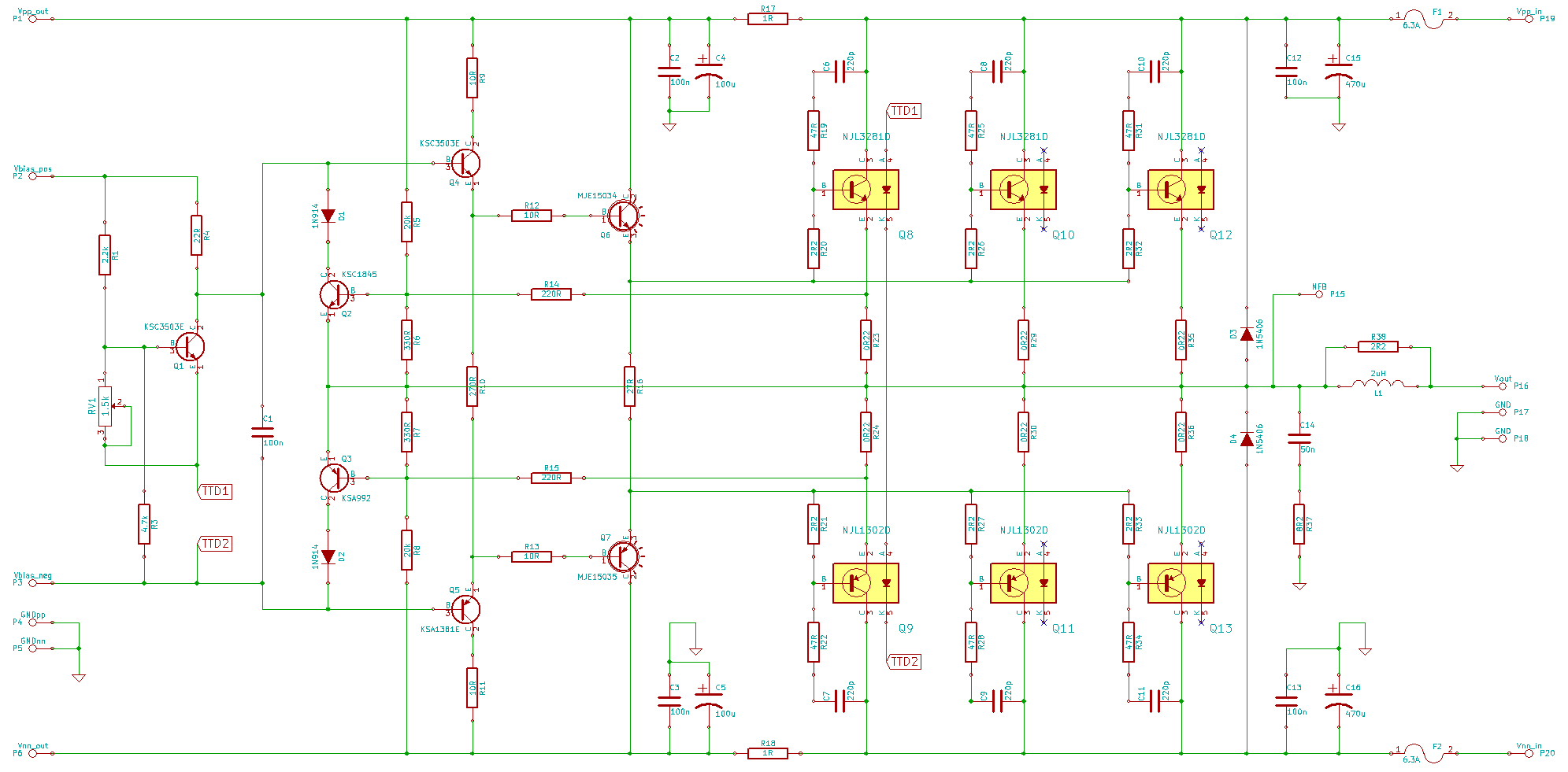

Attached is the OPS schematic and draft PCB layout of the prototype OPS board:
  • Board size is 238 x 69 mm
  • Initially I tried to make it single sided, but with the onboard VI limiter and ThermalTrak diodes, it’s too difficult for me so I ended up using both sides.
  • I put the main V+ and V- rail on top of each other to try minimizing loop area of the quiescent current
  • Not sure if it’s a good idea, I route separate V+/GND and V-/GND to the lower power (left) section of the board, again on top of each other
  • The bias spreader, pre-driver and driver transistors are mounted onto the same onboard heatsink for thermal compensation
  • Track widths are from a minimum of 50 mil to a maximum of 200 mil
  • The pad and hole sizes are slightly bigger than the standard ones, to make it easier for de-soldering just in case.
I would like to receive some remarks/comments about the layout.

I will not comment the layout, because I think tha use of separate PCBs for IPS and OPS is not so good idea.
Just small suggestion. The bias multiplier factor for TT diodes tempco is too high. From my experience R3 should have higher value, otherwise the amp is going to be to much thermally overcompensated. Ratio R1/R3 +1 defines the multiplication factor for TT diodes tempco.
It is pity not to put to good use not used TT diodes, here is very good explanation The YAP Output Stage.
Your EF3 is fast-slow-slow; I think in this case you should put the zobels around the drivers' base-collector pins instead of the output devices.
You might consider KSA1220/KSC2690 for your predrivers. Both sexes are available in the high gain "Y" grade unlike the KSA1381/KSC3503, which are more suitable as a VAS transistor IMHO. Any old cheap BD139 for the bias generator.
The output devices are virtually on top of each other and you should consider spacing them out a little more to aid assembly.
Try to move the power pins and main decouplers in between the two triplets; lose the fuse holders if necessary and relocate them to the PSU board. Increase the track width of the main rails and speaker out track. Move the output coil and ancillary parts left and take a T at the midpoint. You will gain a little space which can be used to space the outputs slightly and shorten the board.
Your IV protection component values will take quite a bit of adjusting to get protection while still allowing all valid audio signals to pass to all valid audio loads.

But semiconductor "turn on" voltages are very dependent on Tj. This can only be determined in the working prototype after you know what to look for. In the meantime omitting the two diodes to turn off the IV might get the amp working without unintended intervention of the IV.
Your IV has a DC triggering value and a DC limiting value.
You have made no provision to for short term transient capability of the output stage.
The IV should allow short term transient currents up to around 20times the permissible DC values to pass through to the valid load.
The two protection transistors can benefit from coupling to the hottest part of the amplifier. This reduces the trigger levels as the amplifier heats up.
... From my experience R3 should have higher value, otherwise the amp is going to be to much thermally overcompensated. Ratio R1/R3 +1 defines the multiplication factor for TT diodes tempco.
Thanks Dadod for your suggestions, I'll increase R3 to 6.8k then, to give (2.2/6.8+1)*3.4 = 4.5mV/degC. I also thought about making some use of the remaining TT diodes, but routing them to the left side of the PCB is a challenge (without using vias, something I don't really want to), I'll read the link and think again.
Thanks Ranchu32, I've seen people using different ways to stabilize a EF3, but I'm lacking some basic electronics knowledge to understand the mechanism behind, could you elaborate further, or point me to some relevant resources. (I'm reading D.Feucht's book to try to learn some basics, but to work through all those algebra will take me a year to finish the 4 volumes.)
Thanks for the transistor recommendations, but I already have a stash of E-grade KSA1381/KSC3503 so I'll simply use them, especially since it took me some effort to get genuine E-grade KSC3503. One thing that borders me slightly is that despite having 60 pieces of each, I can't find one single pair which are hfe matched (all 3503 have hfe closely around 165, and all 1381 closely around 132)
... Move the output coil and ancillary parts left and take a T at the midpoint. You will gain a little space which can be used to space the outputs slightly and shorten the board ...
Good suggestion, I'll try.
... Your IV protection component values will take quite a bit of adjusting to get protection while still allowing all valid audio signals to pass to all valid audio loads.
You can do much of this by simulation to show what ballpark values are required.
Thanks Andrew for your comments, could you elaborate your remarks on the VI component values.
The current values are computed so that with 1 output pair, it can handle any kind of reactive load at 10 ohm, at the same time always within the 1 sec SOA. With 3 output pairs, in theory it can handle any kind of reactive load at 3.34 ohm or above and never activates. Simulations so far also suggest the VI limiter is working as expected.
If you haven't already, I would strongly suggest you read Michael Kiwanuka's article on transparent VI limiting, featured on Bonsai's site.
Thanks, very useful article and I haven't read it before. By a quick look, the VI limiter I used is very similar to fig.1 of the article, but without the shunt capacitors. I'm aware of more sophisticated limiters from other sources, but I tried to keep it simple so just chose the most basic one (and the amp is probably already too complex for a newbie like me 🙄)
Firstly, if you are buying PCBs, these days, double layers are as cheap as single and plated through holes are essentially free.
Like your power rails on top of each other.
I would try & move your output rail as far up as possible to be closer to the power rails. It's not the quiescent current loop that you have to worry about but the yucky Class B currents at full power. The current flows from PSU, via your nice 'twisted wire' PSU rails, the O/P devices and then your output rail to the speakers then back to the PSU. Its this loop that needs to be as small as possible.
I won't comment on the triples which I don't like but suggest you look at Toni's 2stageef-high-performance-class-ab-power-amp-200w8r-400w4r for what is probably the best, most complete & tested implementation of Self's Blameless. Good ideas on layout too though like Damir, I don't like separate driver & O/P boards.
Dunno about your earth rails but I'm wary about having them on either side of the PCB. Potential for a big loop aerial with loadsa yucky currents happening inside the loop .. but dunno how these connect to the sensitive i/p & f/b earths.
Lastly, Self observes that the back of plastic o/p devices can get very hot so it is useful to arrange for a heavy duty Aluminium clamp rather than individual mounting screws if the PCB layout allows this. Hot = low thermal resistance to the die.

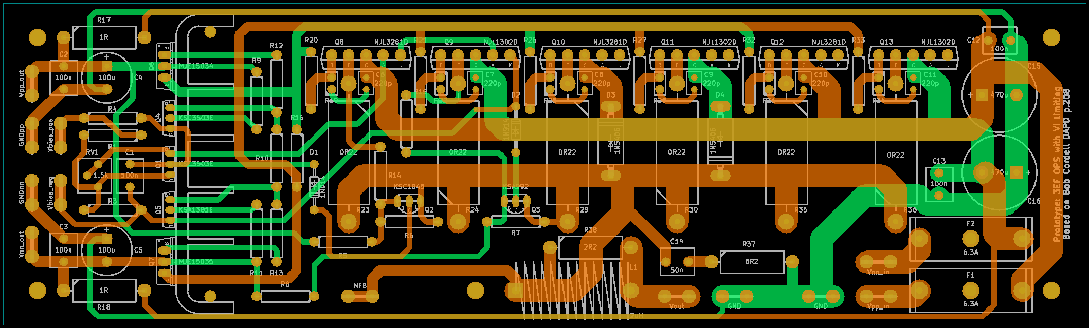

... I would try & move your output rail as far up as possible to be closer to the power rails. It's not the quiescent current loop that you have to worry about but the yucky Class B currents at full power. The current flows from PSU, via your nice 'twisted wire' PSU rails, the O/P devices and then your output rail to the speakers then back to the PSU. Its this loop that needs to be as small as possible ...
Thanks again kgrlee for your comments, very true indeed so I've moved the power rails closer to the output rails, as close as I possibly can. Attached is the revised version.
I also agree with you about achieving the results with least complexity, but this amplifier is "an exercise" for me to learn about amplifier, so a little more complexity than really needed could be fun also. True guru will seek for elegant simplicity, point taken (maybe one day I'll design a SIT based one transistor headphone amp 🙄)
