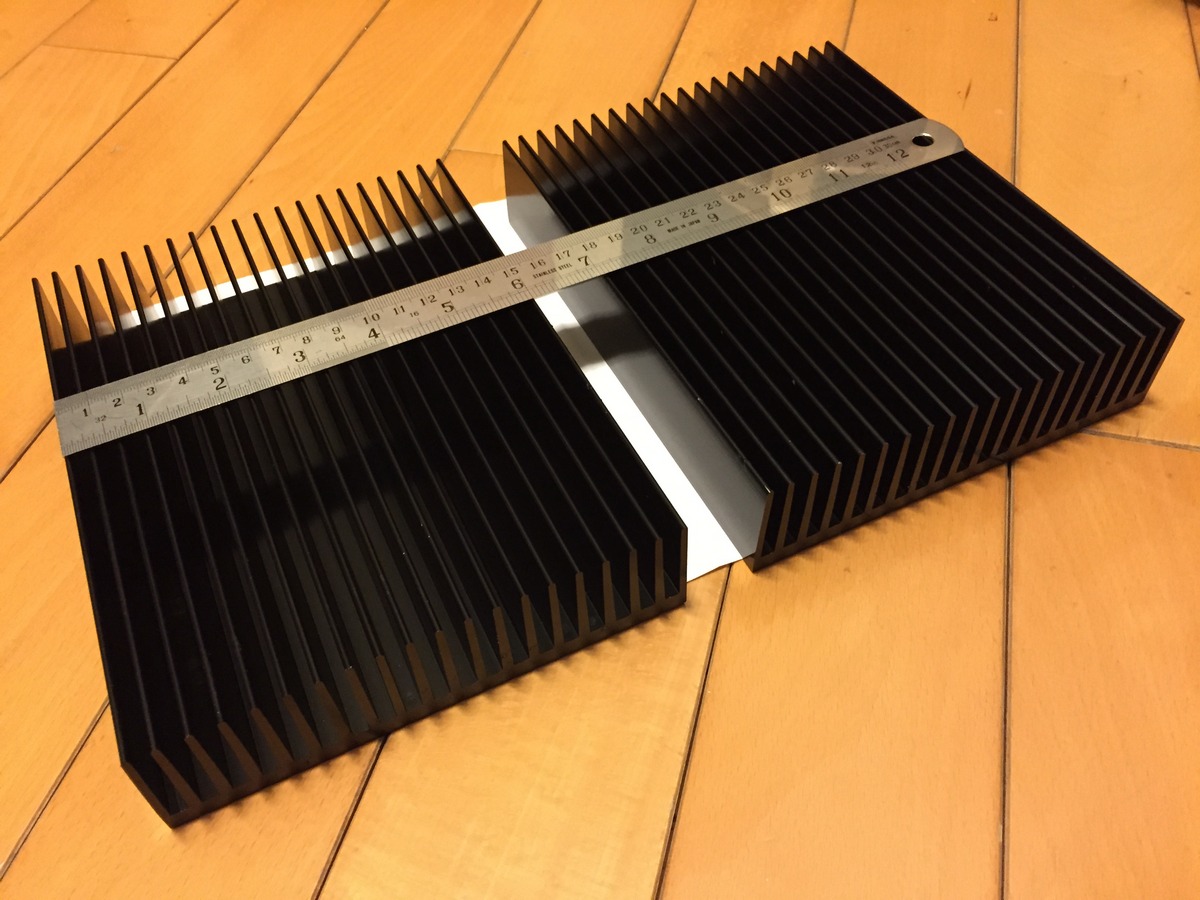

Thanks Andrew, following amptech's reminder I bought the pair of heatsinks from online stores in China (they are defective products in anodizing so very cheap), a bit smaller than I would have liked but I plan to mount a PC cooling fan on each, then add several chassis mount type power resistor onto it to become the dummy load. I also plan to parallel a cap to it to simulate the reactive load, though I'm not very sure what value of C to use (is 100nF OK ?)
