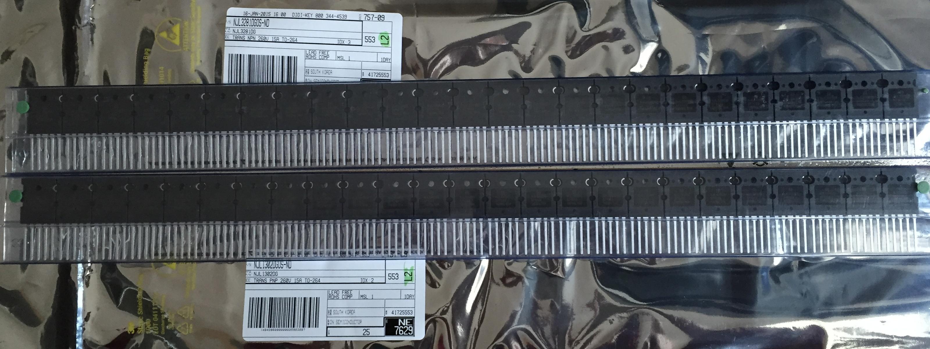

With the comment of Struth I've removed the DC blocking caps, the THD1K numbers fall to sub-ppm level straight away, but the THD20K reductions are not as significant. It also reveal another issue - the optimum bias for the OPS seems different for different output power level, this is my attention right now ...
