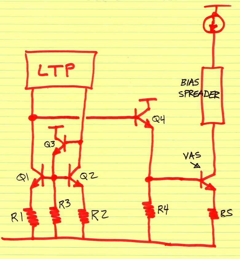

No, standard operating procedure is to design a perfectly balanced current mirror with base current compensation -- including the output current, namely, the base current of the VAS emitter follower.Is trimming R10 for perfect balance SOP? I have never seen any mention of doing this. Seems reasonable to me unless it does something bad I don't understand. Of course, it would be trimmed in the real circuit, real transistors and warmed up.
Per Samuel Groner (Comments on Audio Power Amplifier Design Handbook, Section 3, "Improved Current Mirrors"), standard operating procedure would have you make 3 changes
- Install an emitter follower (Q3) to supply base current of mirror devices Q1 + Q2
- Set Ie1=Ie2 by choosing R1==R2 (within 0.5%)
- Set Ib3=Ib4 by choosing R3==R4 (within 0.5%)

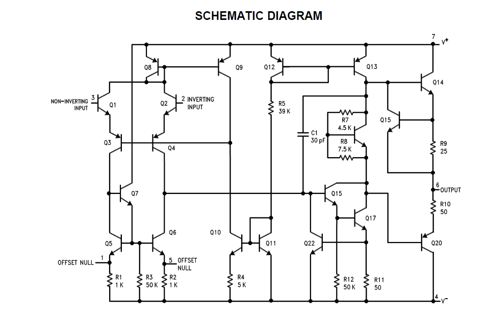

By the way, the famous 741 opamp IC used exactly this input mirror + buffered VAS, in the late 1960's. Have a look at its schematic. Q7-R3, Q15-R12.

I tried a few "improved" mirrors, and contrary to expectations, they did not seem to work well. As I will only be able to match the inputs so well, I figure adjustment is actually the best practice. Pot on the bench, then solder in the resultant value.

Mark,
I see your SOP. Makes sense and I will play with that, but it is too large a topology change for this effort. Still, one is dealing with only so close matching of the inputs. Some trim would still be needed. I have seen Q3 used to blink an clipping indicator as a secondary function.
I have R2 at about 100 Ohms, so that is very much in line with your thoughts.
