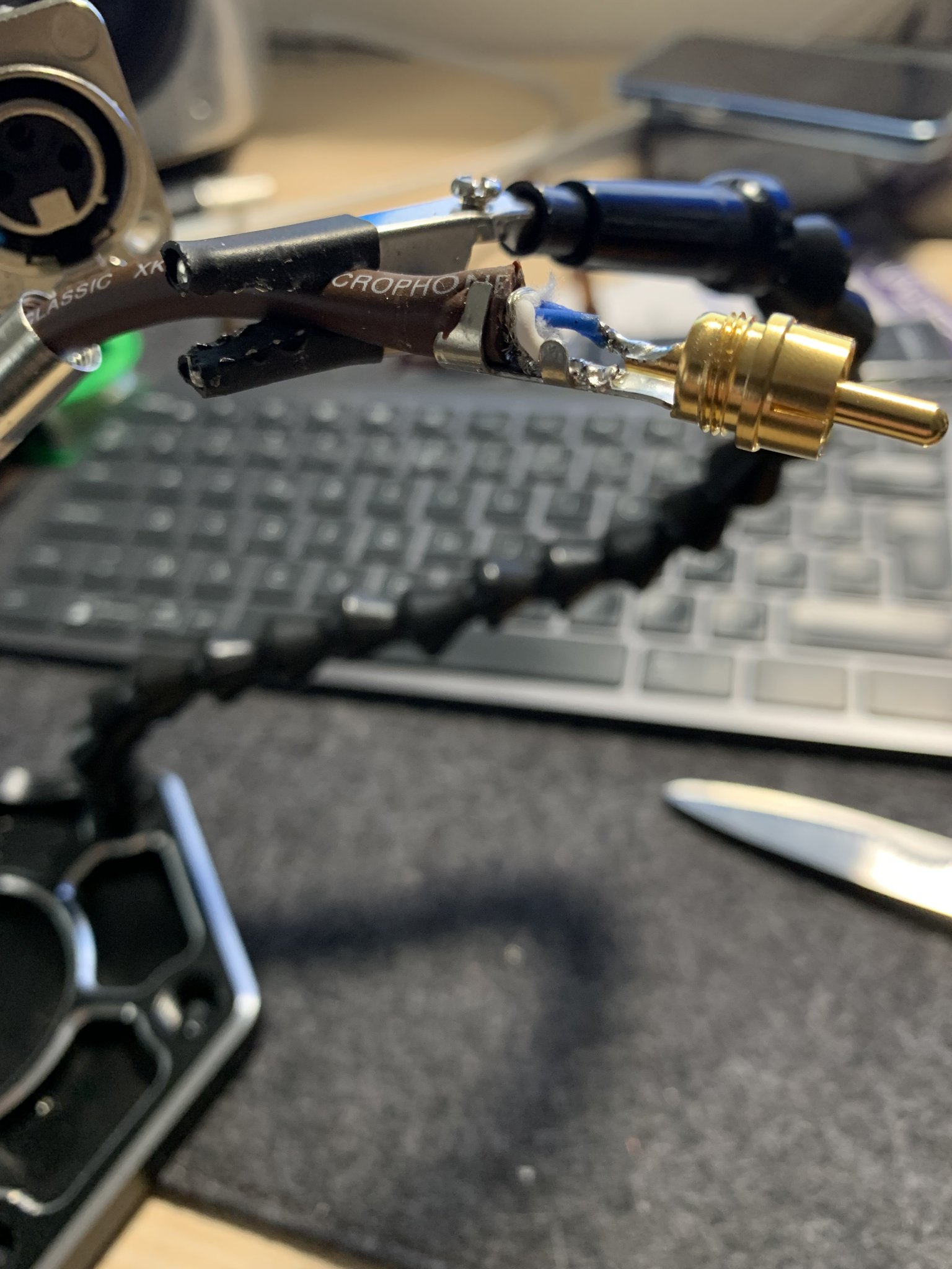

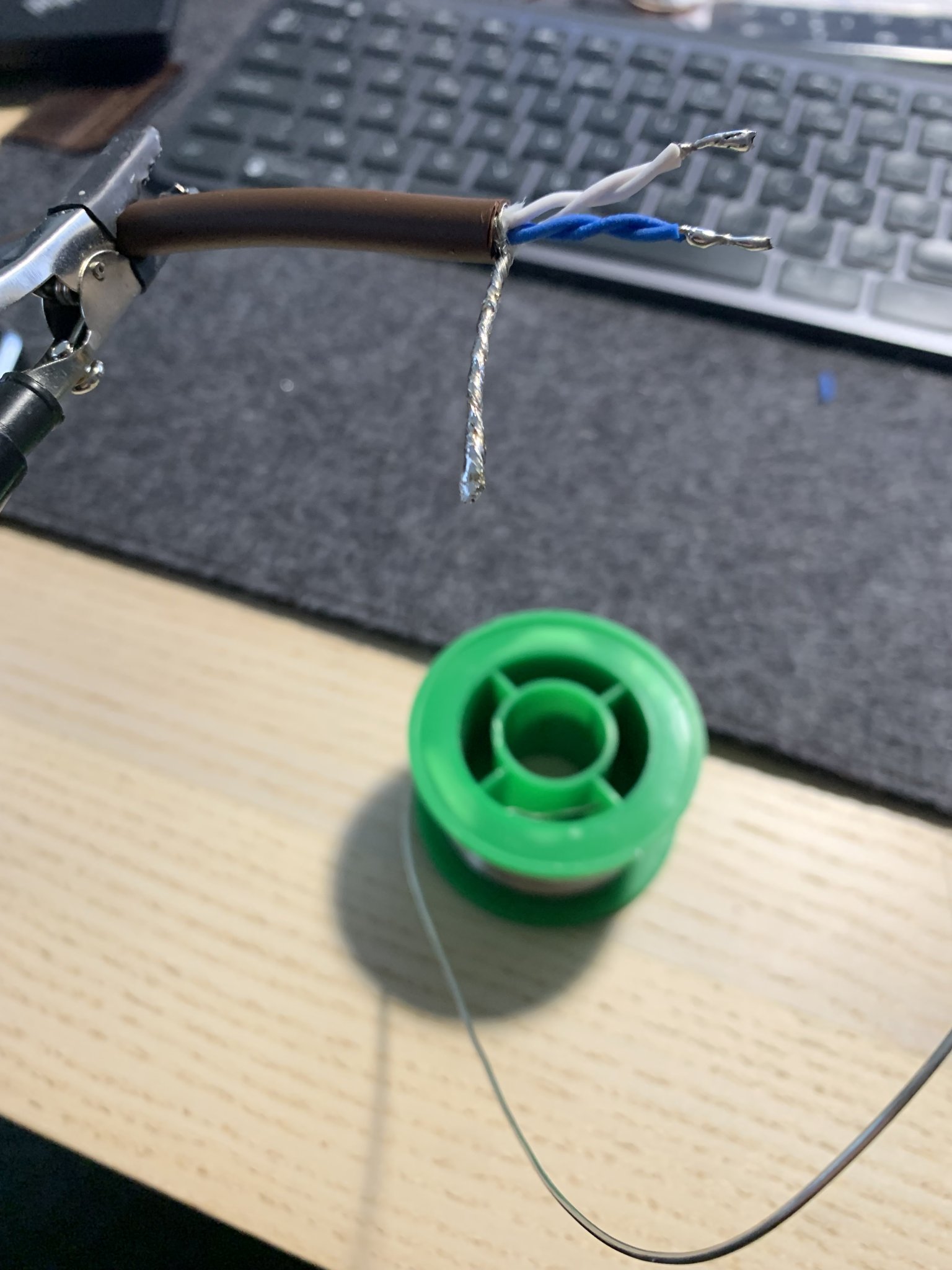

Some soldering and diy cables for the upcoming Minidsp flex eight.
Van Damme starquad, highly recommended, the braiding is a breeze to remove.
Perhaps not the best choice for single ended switchcraft connector though!
You shouldn't do soldering in front of a computer screen, it disturbs the crystalline structure of the solder and change the directionality of the cable...

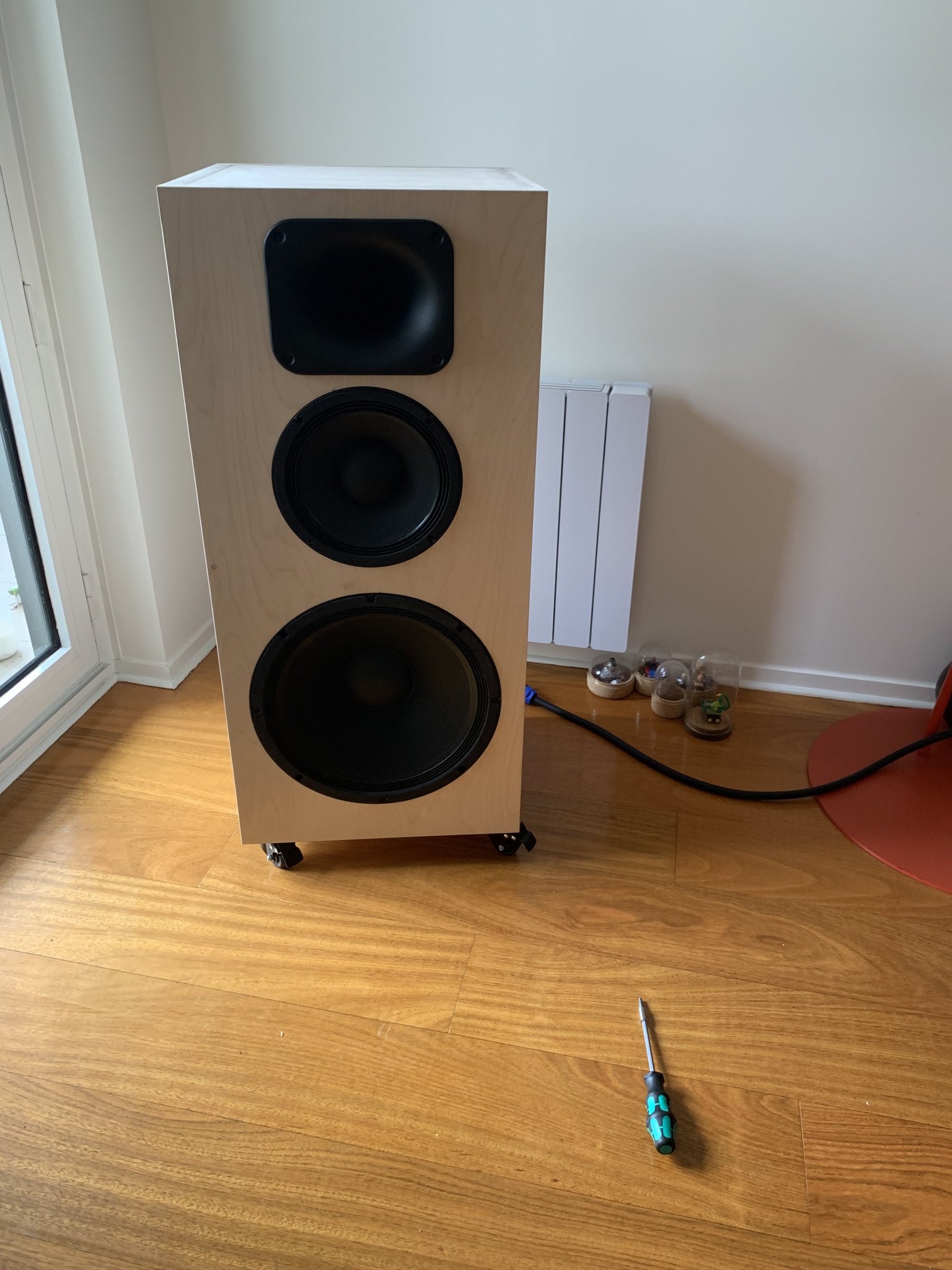

I'm also interested in the Faital pro driver. Any reason you have chosen a horn with such narrow dispersion?
The loudspeakers will be 6 meters from the couch, and no treatment possible, so I opted for narrower dispersion than the usual 80 degrees as to focus on where I will be listening.
Got some time to almost finalize one of the speaker, at least enough to start some measurements.

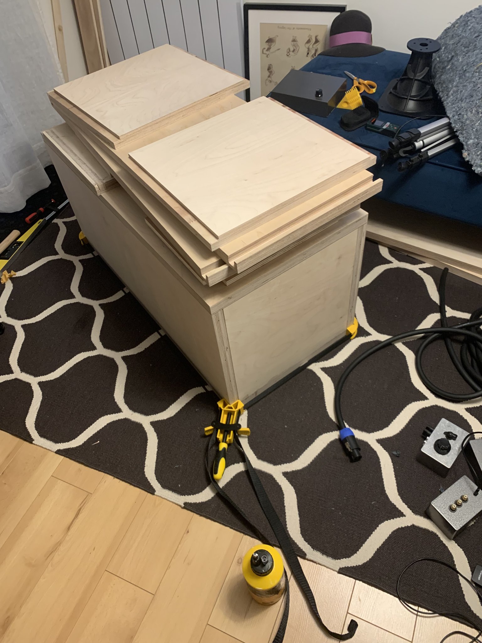

Gluing up the front baffle, I don't have big enough clamps, so I needed to get creative:

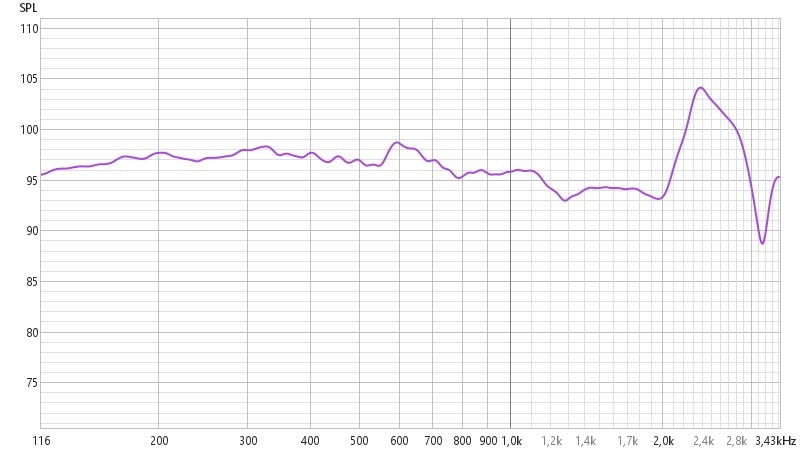

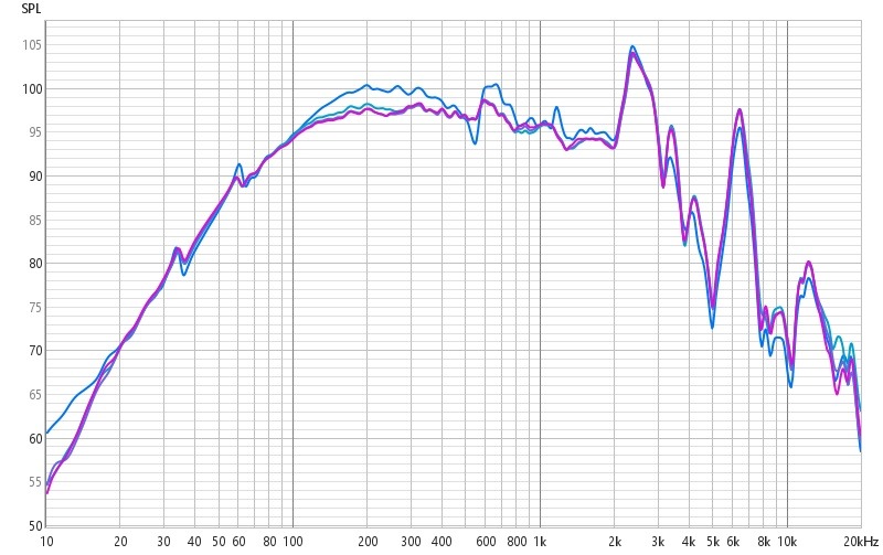

and here is a nearfield measurement of the mid woofer:

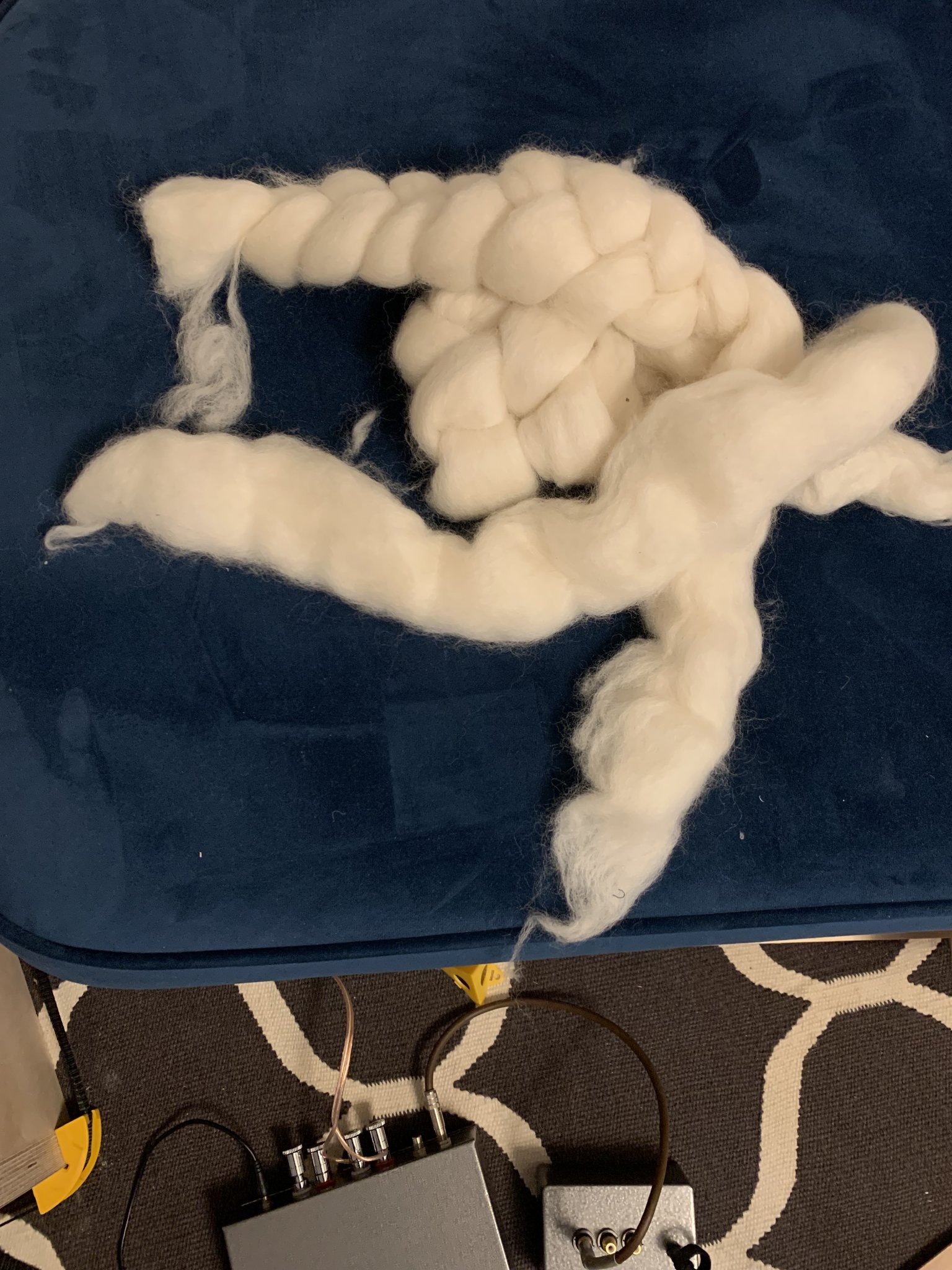

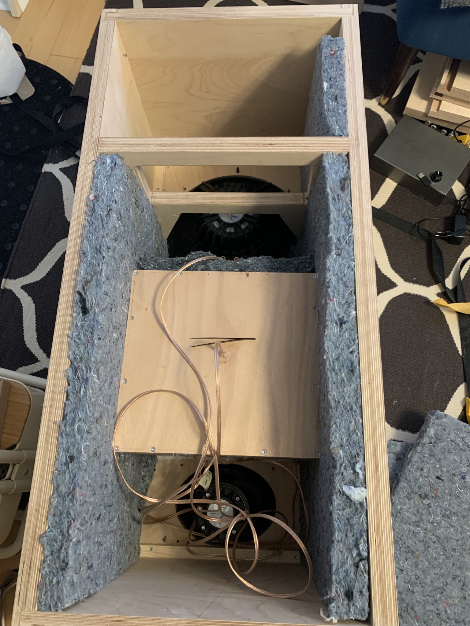

Probably not much more I can do about the 580Hz peak and 1100Hz dip, as I built a rather square chamber. That was a dumb idea. The wool/cotton panels did wonder, as the sheep wool I "borrowed" from my wife, this stuff is incredible:
For comparison, the mid nearfield, without stuffing (blue), vs above with stuffing (purple and ocean) :
Thank you markbakk, what makes you think they are not very good? I’d like to learn what to look for as this fr doesn’t look awful to me?
Thanks.
Thanks.
Ow I missed that. Well, -10dB at 40Hz can’t be your target highpass goal, or is it? A moderate 6” design does a far better job.Thank you markbakk, what makes you think they are not very good? I’d like to learn what to look for as this fr doesn’t look awful to me?
