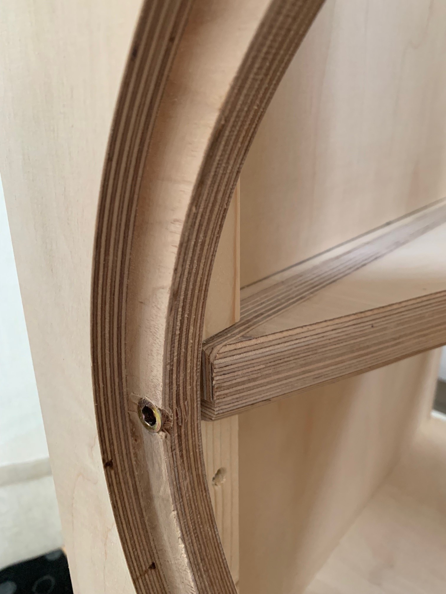

routing rabbets for the mid chamber and braces:

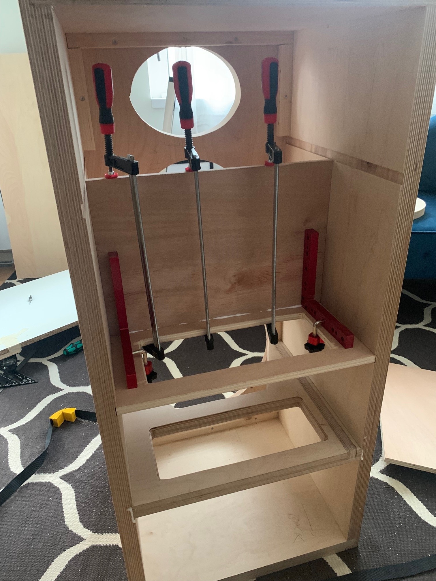

Glued up and reinforced. Probably spent a full hour cutting and gluing these pine 1x1 to size, for a questionnable result in terms of rigidity.

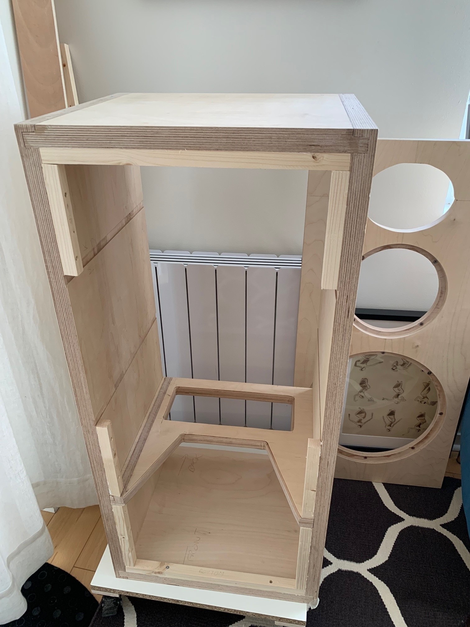

This wouldn't be a build without some f*up, forgot my screw were 2 inches long, I will have to cut these two with a dremel before,
Notice the quality brute force of the insert into the ply!

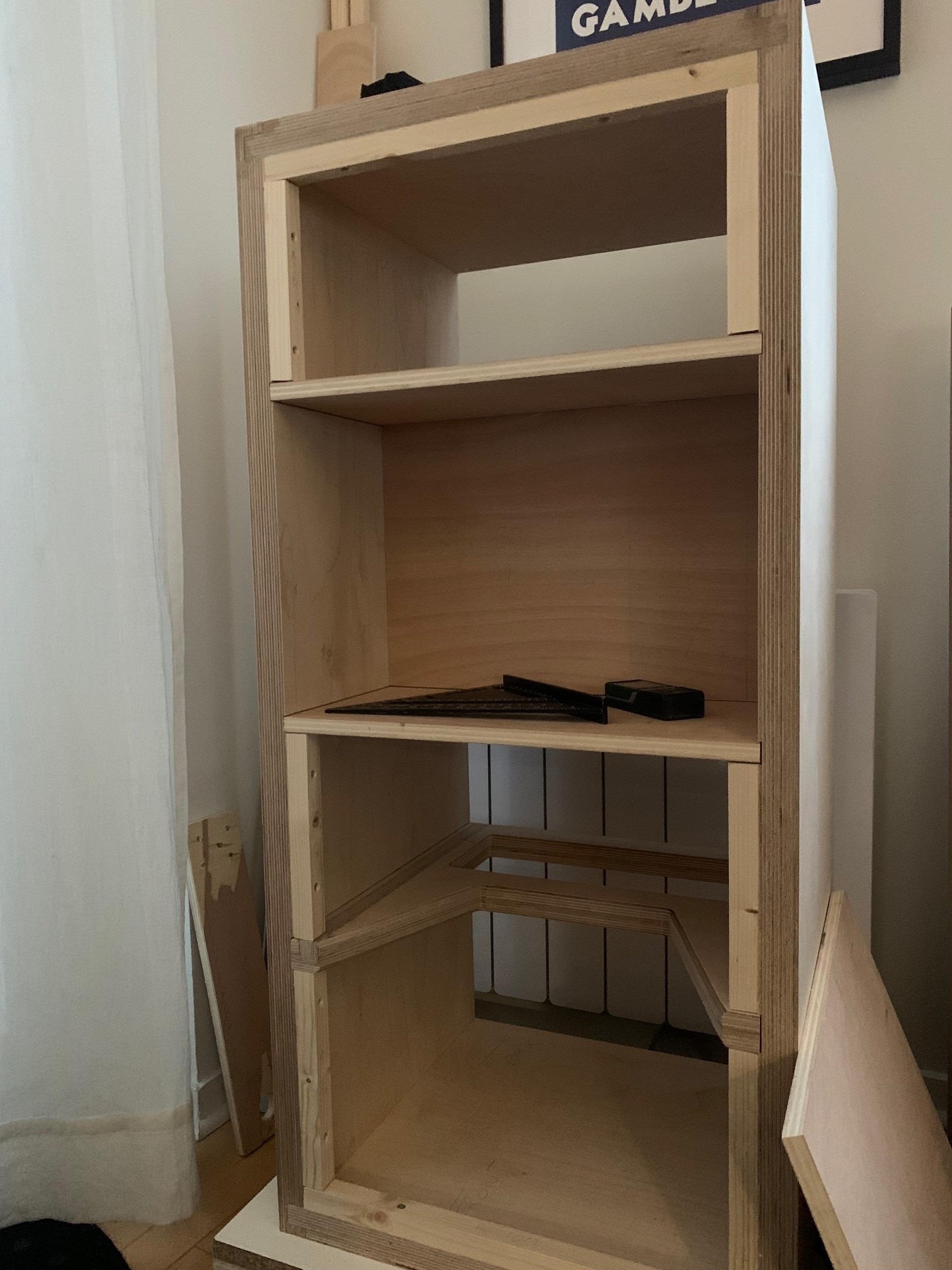

Mock midchamber setup

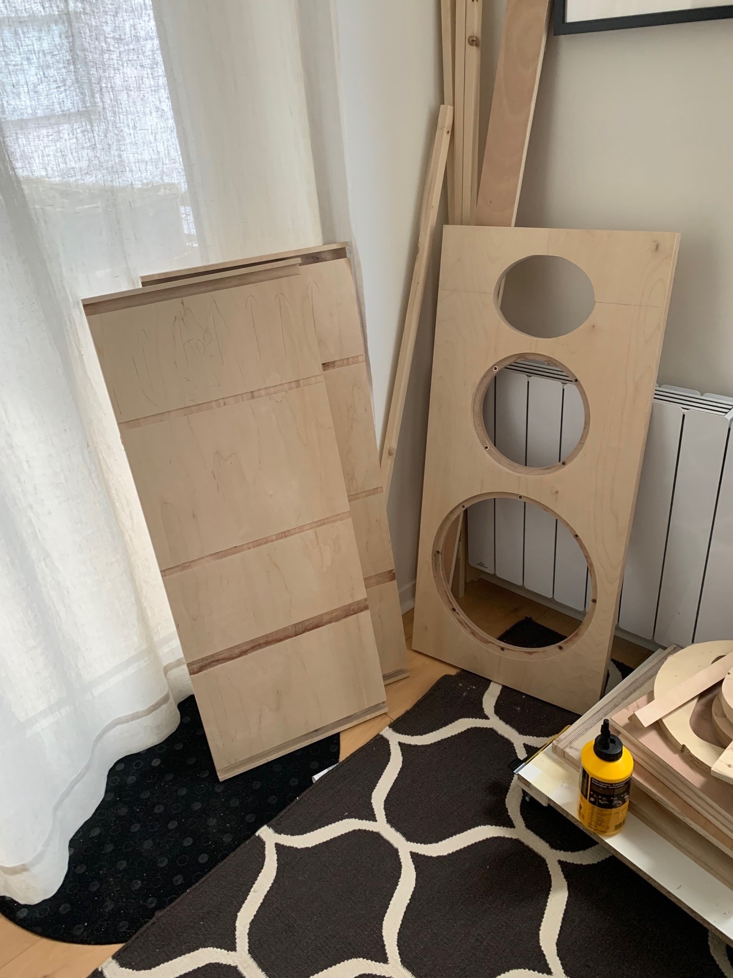

Stretched my puny clamps to the max:
