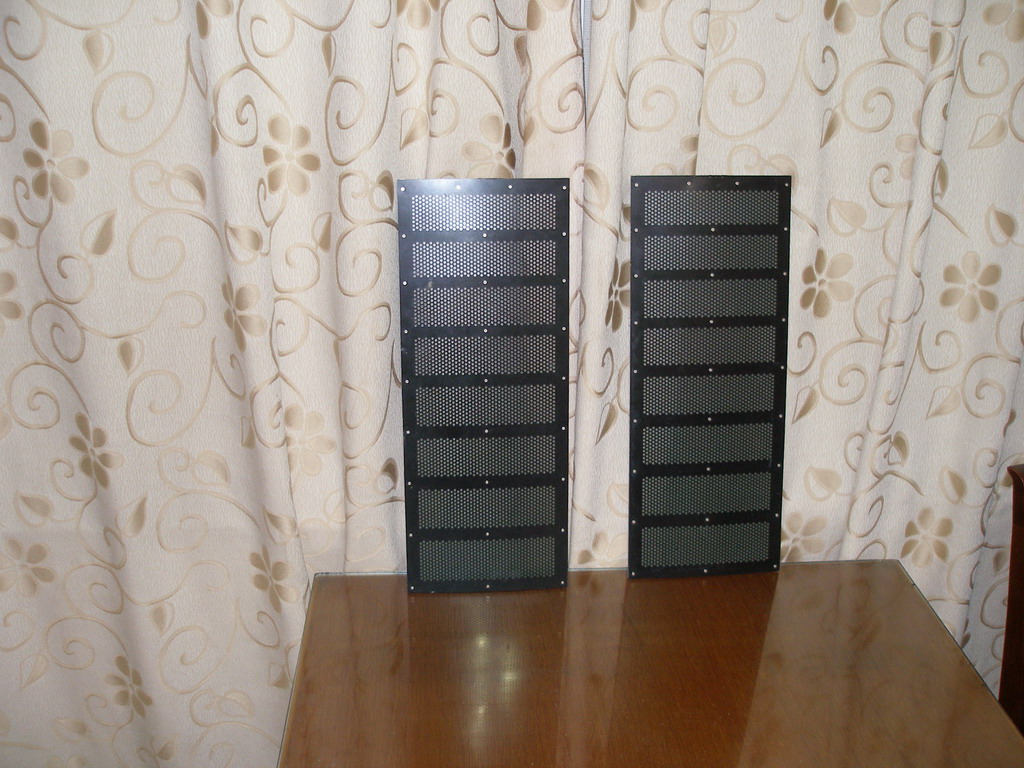

Stator:
- It is a modular design, some basic modules can be combined into a large one;
- In order to minimize idle distributed capacitances between two stators, stators are designed with PCB, so efficiency and high-frequency response of my ESL are improved remarkably;
- Utilizing design of distributed resonances which has more flat frequency response;
- In order to uniformize driving electro-static force on whole surface of membrane, a design of honeycomb structure copper foil on stators is used.

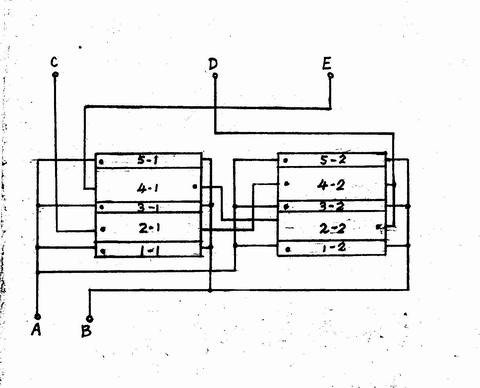

Setup transformer for ESL:
1. Setup is a c-core which is wound from Grain Oriented silicon steel strip and are annealed in high vacuum furnace under protection atmosphere;
2. Multi-sectioned design. Primary winding has 6 sections and secondary winding has 4 (clockwise and anti-clockwise) sections.
3. Excellent frequency and square wave response;
4. Power handling conservatively set at 50 watts continuous;
5. 100:1 turns ratio;
6. Transformers are totally hand wound;

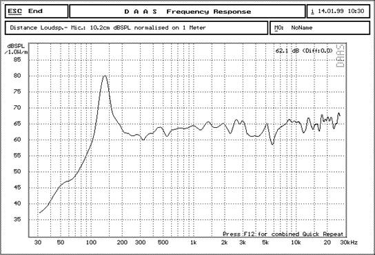

Technical parameters:
Middle ESL:
- Dimension of one unit: 500mm*200mm;
- Spacer: 1.5-2mm thick (Bias Voltage: 2KV/mm);
- Bias Voltage: 3-4 kV (thick of spacer are 1.5-2mm);
- Frequency response: 200Hz – 30 kHz (see figure -);
- Cross Frequency recommended:
For one panel: Fcut>=400Hz;
For four panels: Fcut>=200Hz;
- Input impedance: 4Ω or 8Ω;
- Driving Power (min. / max.): 2 – 80W (R.M.S.);
- Power supply: ~220V;~110V is selectable;
- Working environment: recommended relative humidity is less than 55%.

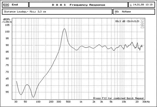

Tweeter ESL:
- Dimension of one unit: 350mm*70mm;
- Spacer: 0.5-1mm thick (Bias Voltage: 2KV/mm);
- Bias Voltage: 1-2 kV (thick of spacer are 0.5-1mm);
- Frequency response: 1KHz – 30 KHz (see figure -);
- Cross Frequency recommended: Fcut>=1 - 2KHz;
- Driving Power (min. / max.):2 – 20W (R.M.S.);

Zhigang's must be the excellent one huh ? ...😀 More pics Zhigang.................
Hey Zhigang.
Looking great, cant wait to see the finished units and get a sound report 🙂

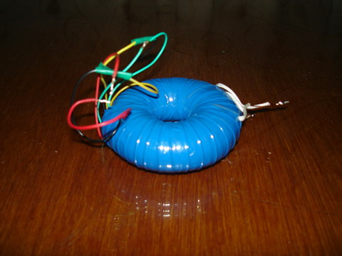

Pic. of set-up trans. Is following:

O-core set-up Trans.
1. O-core is wound from one continuous silicon steel strip and there are no joints;
2. The round cross-section improves electric performance of the core. The tight windings and the fact of no shape angles provide a well-distributed magnetic field. The improved coupling reduce magnetic leakage.
Maybe O-core set-up Trans. Is the best one.
But winding O-core set-up trans. is very very difficult by hand.

1. Wire resistor is made of continious metal rod and there are no joints
2. Round core is better then square one. Yes, in 1MW tranny where winding is done from copper "two-by-fours".
Otherwise all the x-formers would of utilize round cores. One nation sells qubic watermellons as well...
Are you kidding me?
Toroids are much easier to wind BY HAND.
I would love to see C core wound by hand, without primitive winch.
He meant that the O-core are wound from continuous steel strips without air gap (unlike C-core).
There are many who use O-core instead of rectangular-section toroids for audio, and I suppose for good reasons.
The gentleman, whoever he is and where ever he comes from, merely showed us some pictures of his work.
Even if you do not like it or think it is primitive, or that his English is not native, he still deserves our respect.
Better still, why not open a new thread and show us your wonderful work.

A set-up trans. for ESL isn’t a power trans. In order to minimize leakage inductance and distributed capacitance, an excellent set-up trans. is very complicated, it is a multi-sectioned design, primary winding has 6 sections or more and secondary winding has 4 or more (clockwise and anti-clockwise) sections. It isn't as simple as you might think.

I think you meant "step-up" transformer.
It multiplies the low voltage output of an "ordinary" power amplifier to the high voltage required to drive the ESL membrane.
What is the step-up ratio of your transformer ? 1:150 ?
How about primary and secondary inductances, leakage inductance, interwinding capacitance, DC resistances, ....., etc. ?

Hand made x-former
R-CORE is prety much steel equivalent to "Image is everything, thirst is nothing" (c) "Coca-Cola" "Sprite"
What's clear on picture posted is well defined single wire primary with low turns count, wound on top of secondary(ies).
I may be mistaken, but no multiple terminations intrinsic to sectioned/interlieaved designs are visible - you can't really hide a lot of interconnections in toroids - they create nice buldges😉.
So far as simple as use of standard transformer with hand wound seconday form hookup! wire, used by some DIYers here.
Making/designing transormers for more then 20 years by now I would say that using standard steel toroids for really good ESL transformer is not way to go.
For those who can't do it Calvin suggested readily available 50/60 Hz x-formers for power supplies, same as above.
What's below is well known, but rarely used in industry - hard to automate.
Due to high magnetization current you'll end up with rather high turns count in order to minimize one.
Smart and elegant design with minimal capacitance and decent coupling would be so-called cable transformer with high iron cross-section.
Metglas of similar material shall be used, having magnetizing current 10-20 times lower.
How can it be so better - increasing core cross section 10 times you'll lower the turns 10 times, so resistance is lower as well as stray capacitance.
Cable transformers are known for relatively high coupling, especially if winding thickness is low (easily achievable) - low stray inductance as well.
So win and win and win.
How can it be done.
1. Easy way - look for Finnish ESL DIY site. Rather long stack of EE cores, foil primary, wire secondary. Result looks like a beam.
2. Hard way - stacked toroids. Keeping in mind Finn design, you'll wind secondary on each core, then stack them together on top of each other, insulate, wind primary.
Result looks like a sausage. Primaries seems to be connected in series - please do not elaborate on this.
3. Really hard way, insulation problems, (the best) - wind primary and secondary on each core, connect primaries in parallel, secondaries in series.
Do not forget that at the hot end voltage applied between windings is the highest.
Advantage of #3 is that you exclude frontal parts of secondary winding from magnetic leakage, which happens in case #2 where those parts are not in proximity with primary.
Again all of the above is in books... just look for high voltage transformer design.

Strucure and connection of set-up trans. ( C-core or O-core):
Primary windings: 1-1, 3-1, 5-1; 1-2, 3-2, 5-2; all have clockwise 40turns and connected in parallel.
Secondary winding: 2-1, 4-1; 2-2, 4-2. All have 1000 turns. 2-1 and 4-2 are clockwise; but 2-2 and 4-1 are anticlockwise.
Transformer ratio is 1:100
