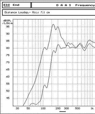

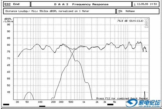

Suppressing the resonance peak in the lower frequency:
A 10μF CBB capacity is connected in series with primary winding of set-up trans.. High-pass filter consisted of the C and inductance of primary winding of set-up trans. makes frequency response in the lower frequency become flat.
Hello zhigzng324,
Using the inductance of the primary winding of the step-up transformer as part of the HP crossover is generally not the best idea.
The reason is that the inductance of the primary is a function of the permeability of the transformer core which changes with flux density as the signal input varies in amplitude. Inductance of the primary usually varies by more than a factor of 3 with typical input voltages. Inductance increases with input voltage until core saturation is reached. Increasing voltage beyond this point and the inductance decreases abruptly as the core saturates.
Try measuring the frequency response at 10 different volume settings from 1Vrms to 28Vrms. You will see the response of your HP crossover network is dependent on volume setting.
The easiest way to avoid this problem is to swamp the varying primary inductance with a lower value air core inductor and/or resistor.
Here is an example crossover design Calvin posted in which he used a resistor to linearize the primary inductance.
http://www.diyaudio.com/forums/planars-exotics/64620-ping-calvin.html#post727647
