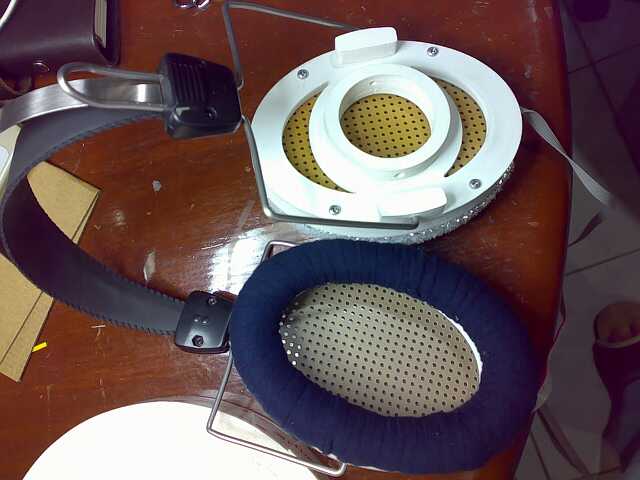

About the frequency response, I just finished my ES headphone and a headphone amp that goes together. I can't believe that the bass response from my headphone can go so low. It's even better than other commercial headphones I have ever heard. So, I come to wonder why can't the ESL speakers produce the same low frequency? Is it a matter of the low frequency sound produced not being heard from a far as compare to headphones?

HPs are listened to in the very near range, while a speaker suffers from the acoustic phase cancellation which is a factor in farfield-listening. Additionally the HP and the ear canal form kind of a small cavity which assists bass response. This helps restore bass because most HP-panels feature basic resonance frequencies ~100Hz.
