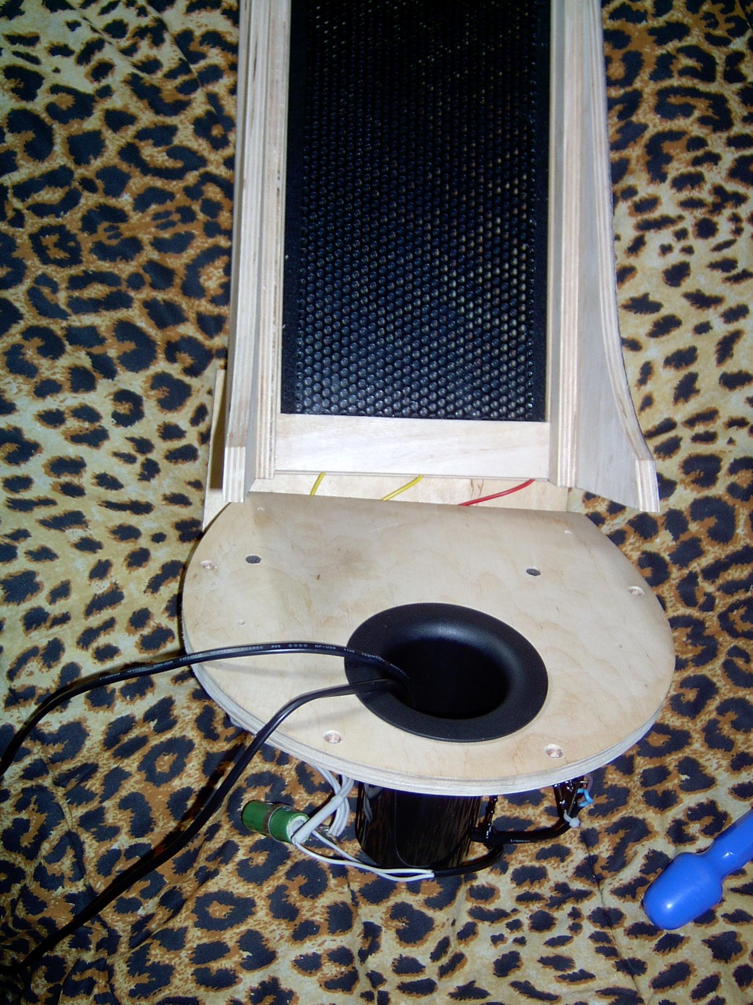

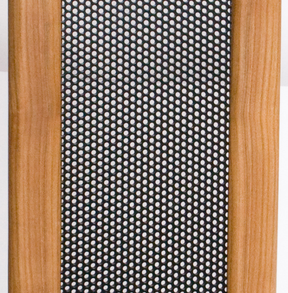

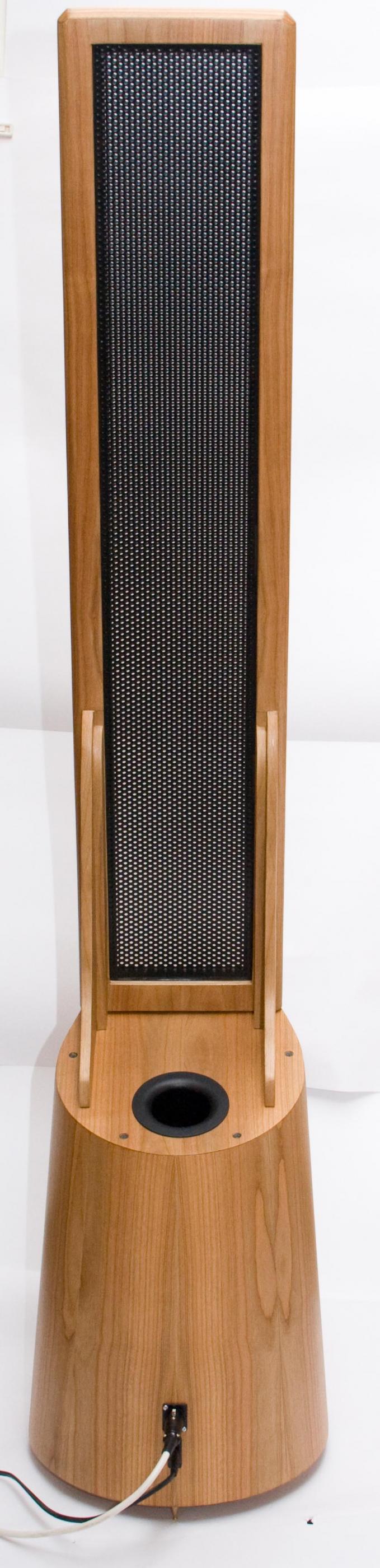

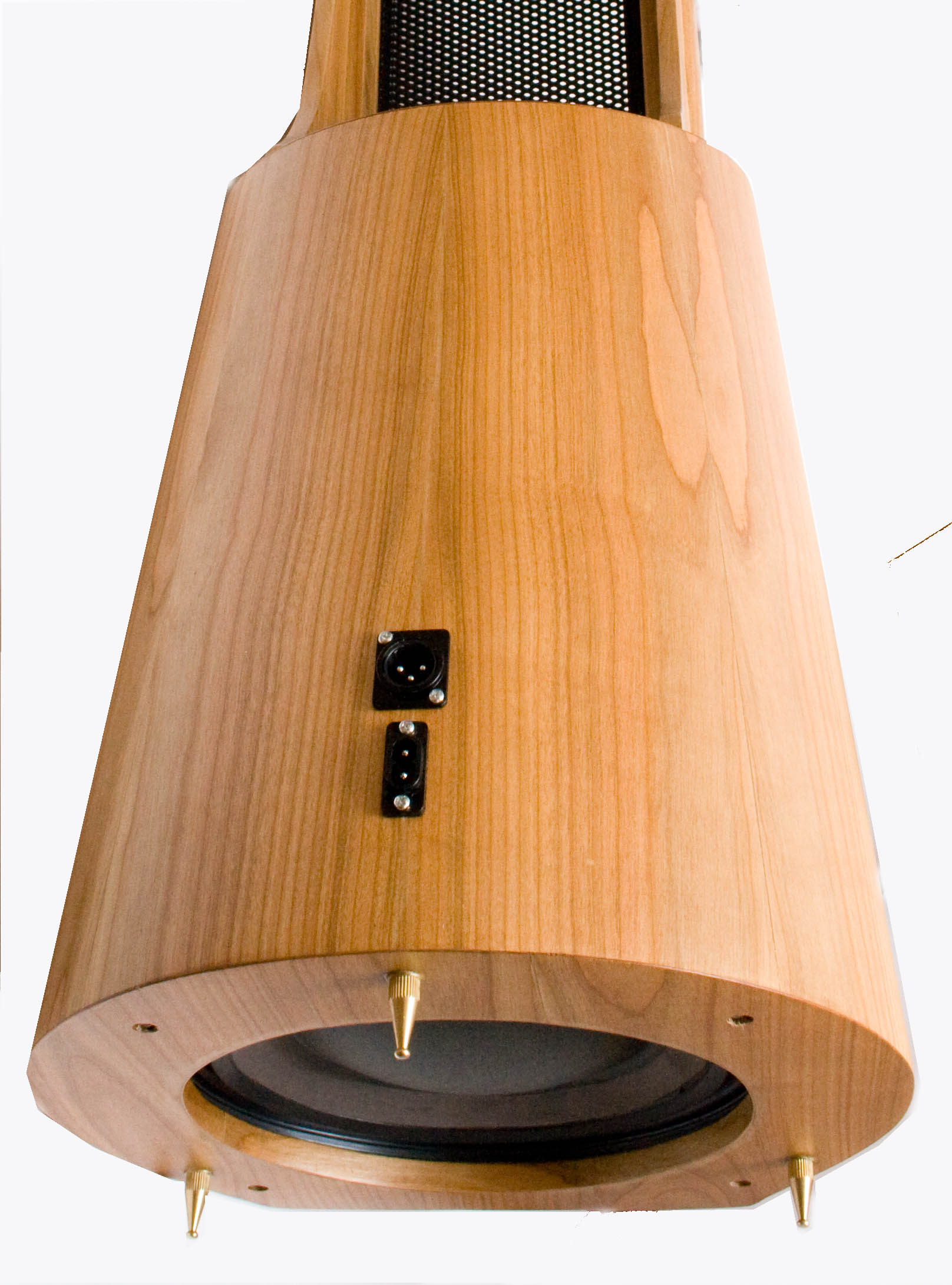

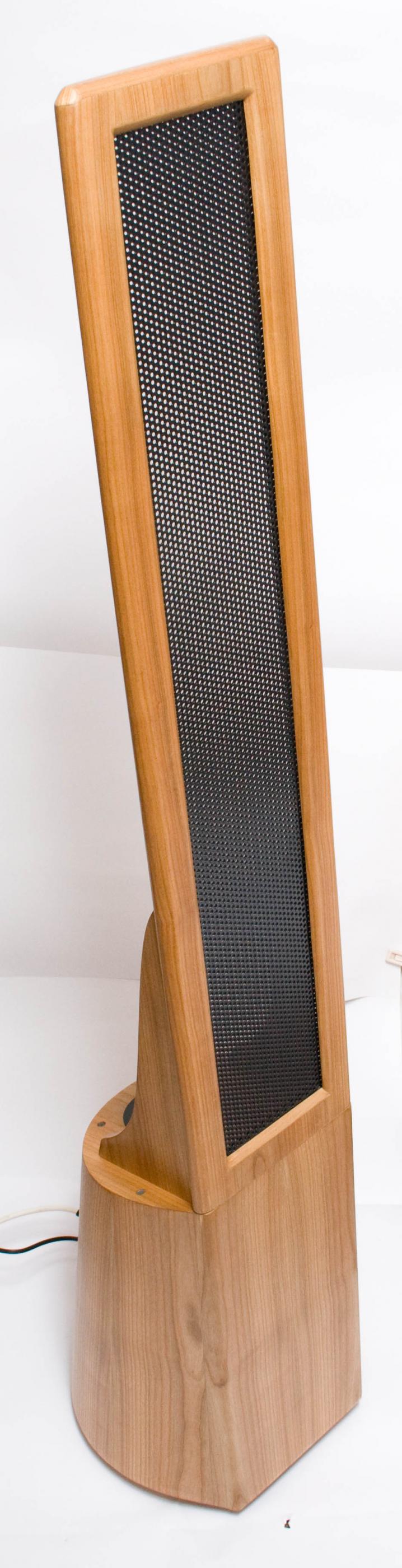

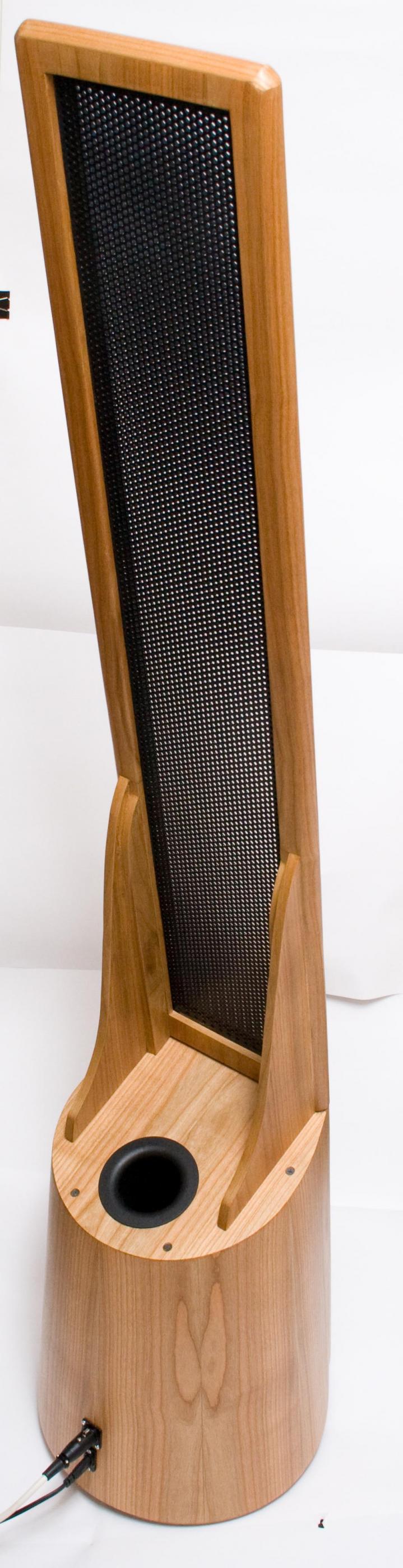

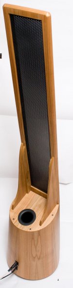

Frame for the back side is now done!
I now consider the speakers 99% finished! 🙂
I'll experiment with damping the back grills a bit.
Wachara: Whith two wild children in the house, I se them as protection for the Mylar not to be perforated and so that my girls don't get electricuted! 😉
/R
/R
As I'ts my speakers, I think any judgement of the sound will be coloured - I'll leave that to others! 😉
But I can say that so far I am very pleased!
/R
/R

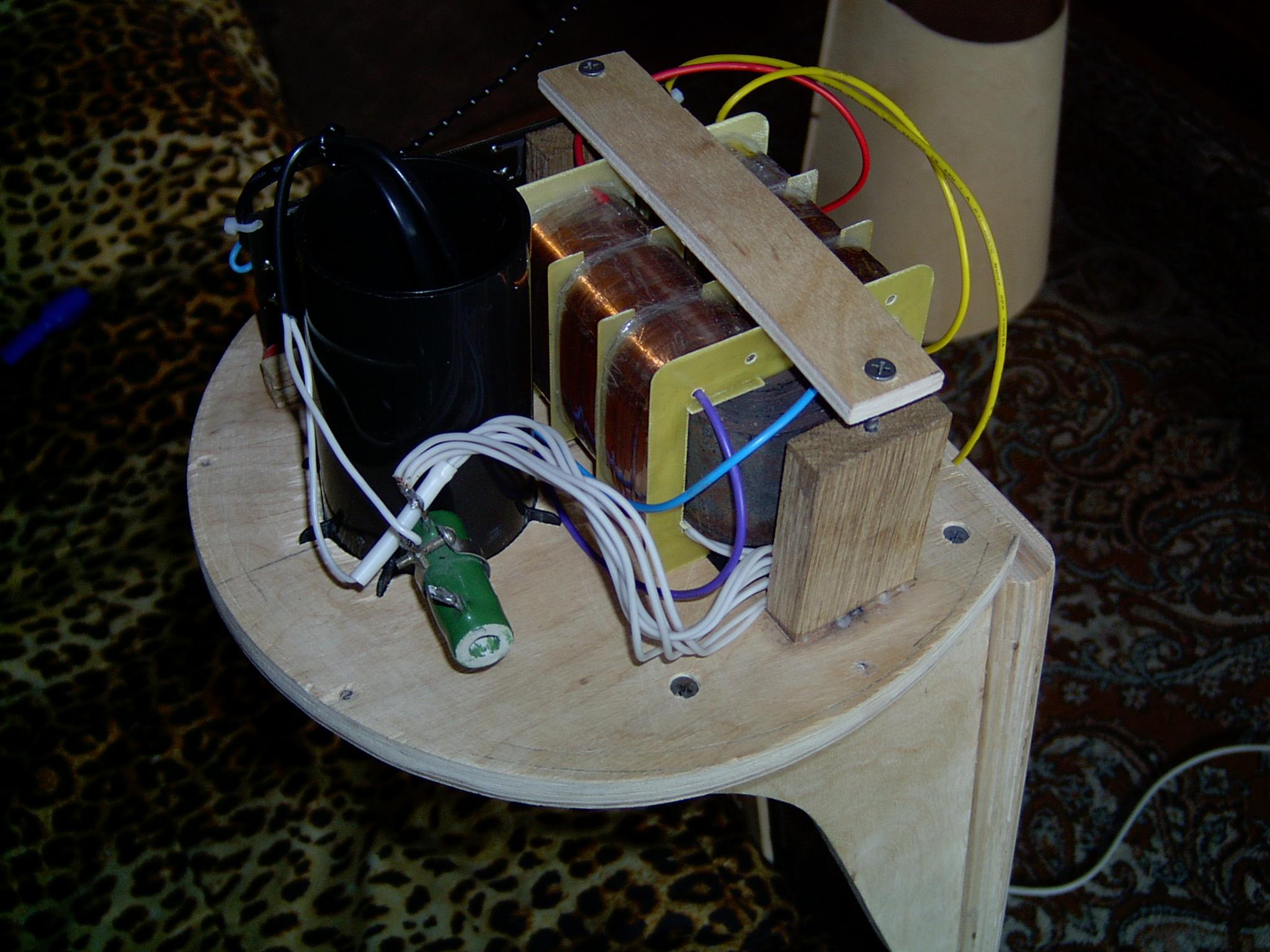

Arend-Jan, if you're reading this, why did you suggest to wire the toroids' HV windings in anti-phase (both "bottoms" going to the center tap)?

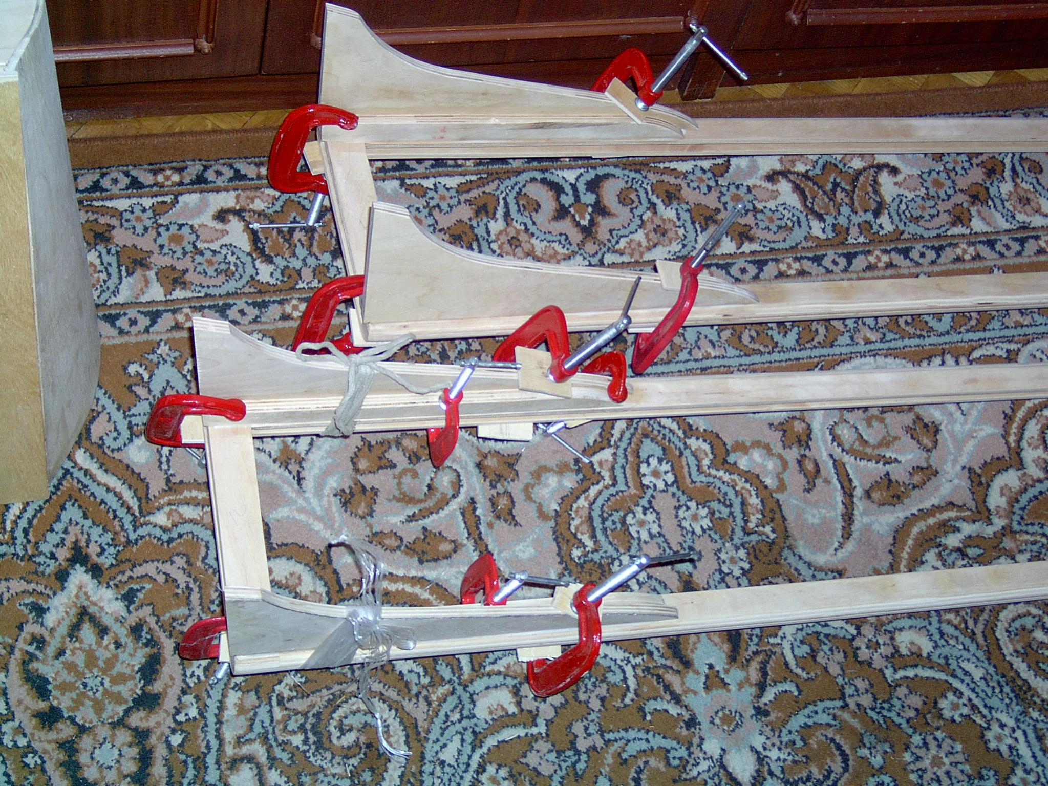

i am going to try and upload some pics of a start fo finish job. i am allwed three per post, just look under my name, showing pics of the stator construction and some of the tl construction, a work in progress. hope this gives inspiration.

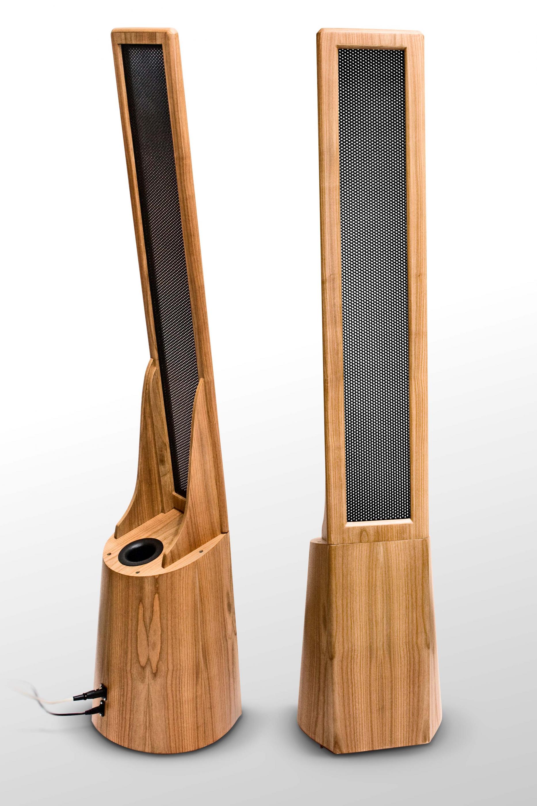

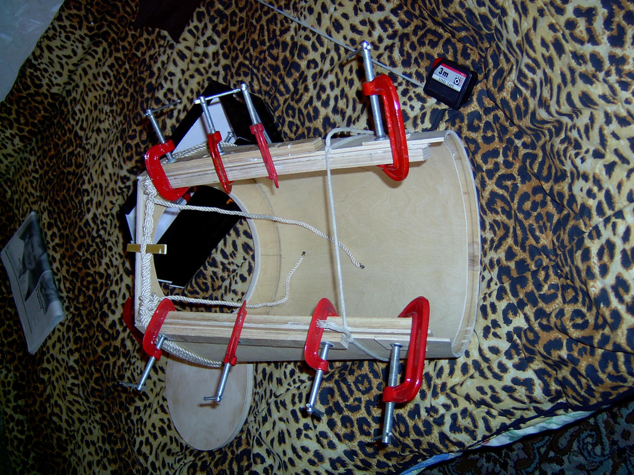

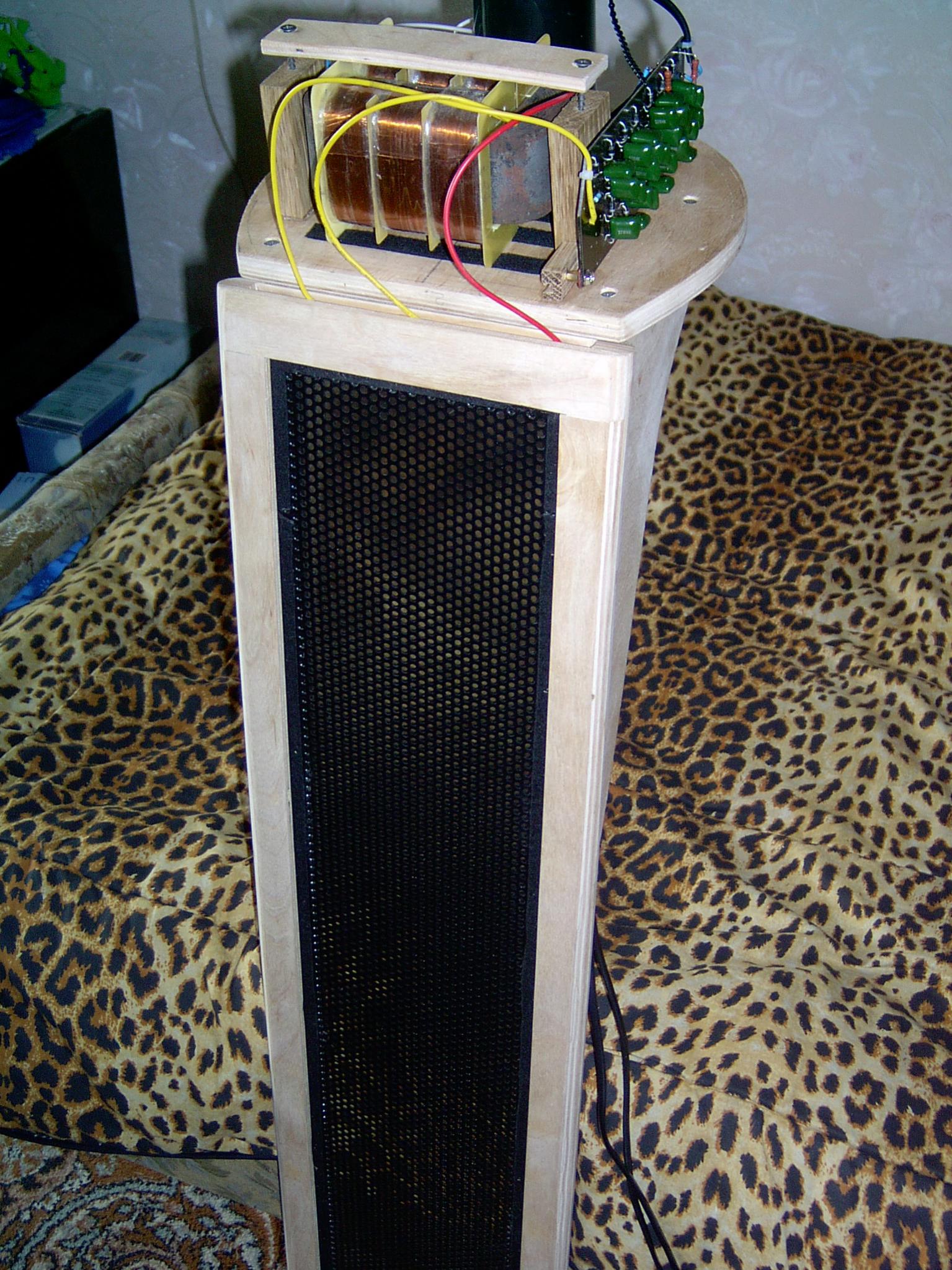

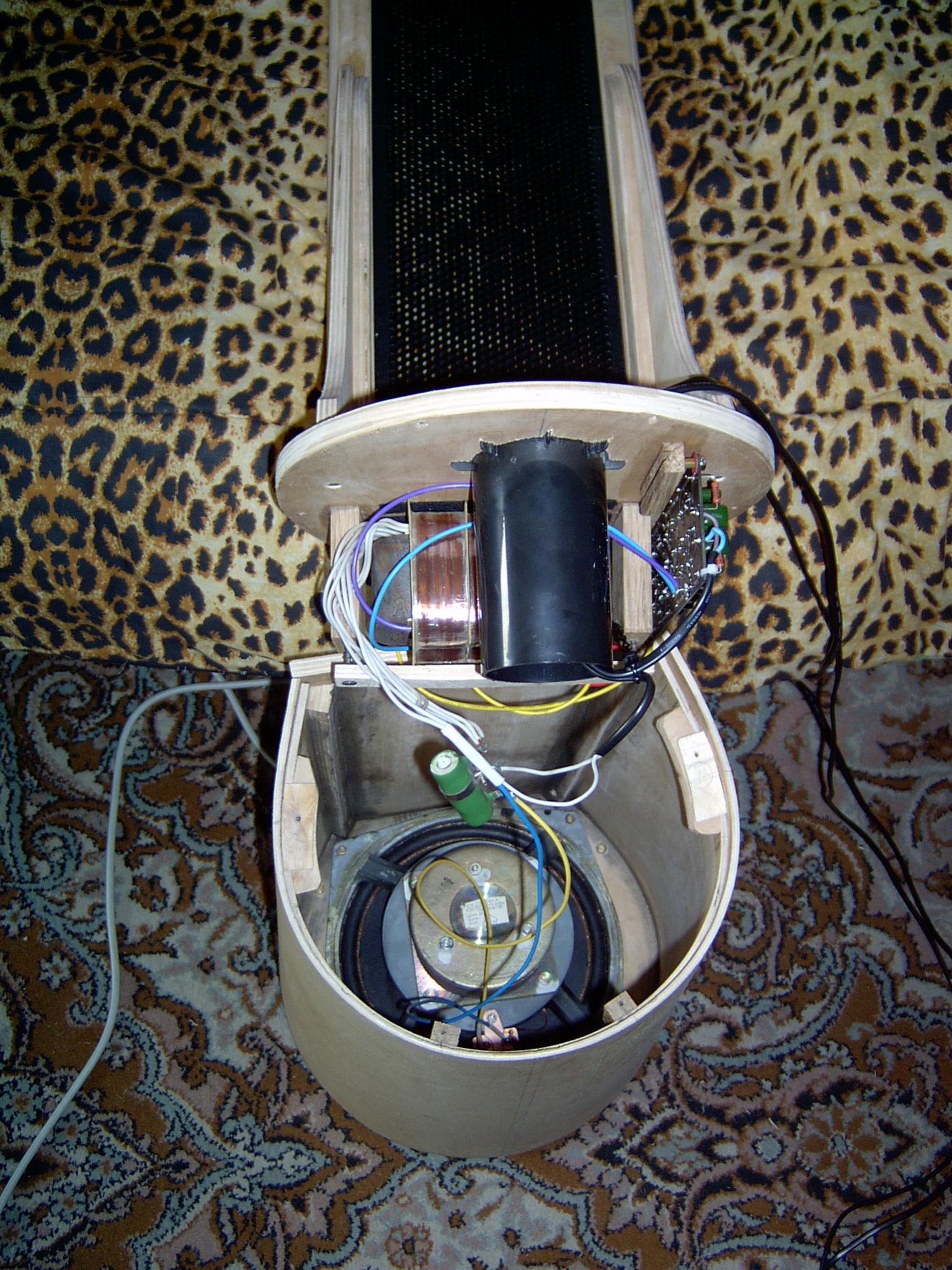

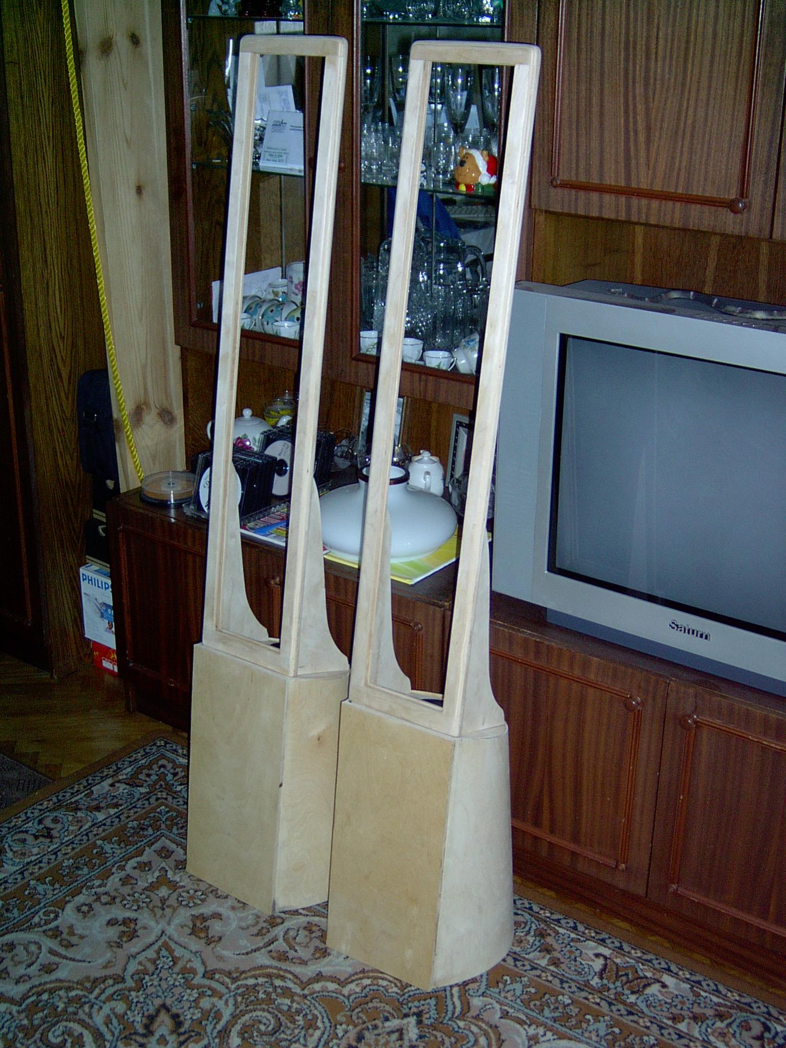

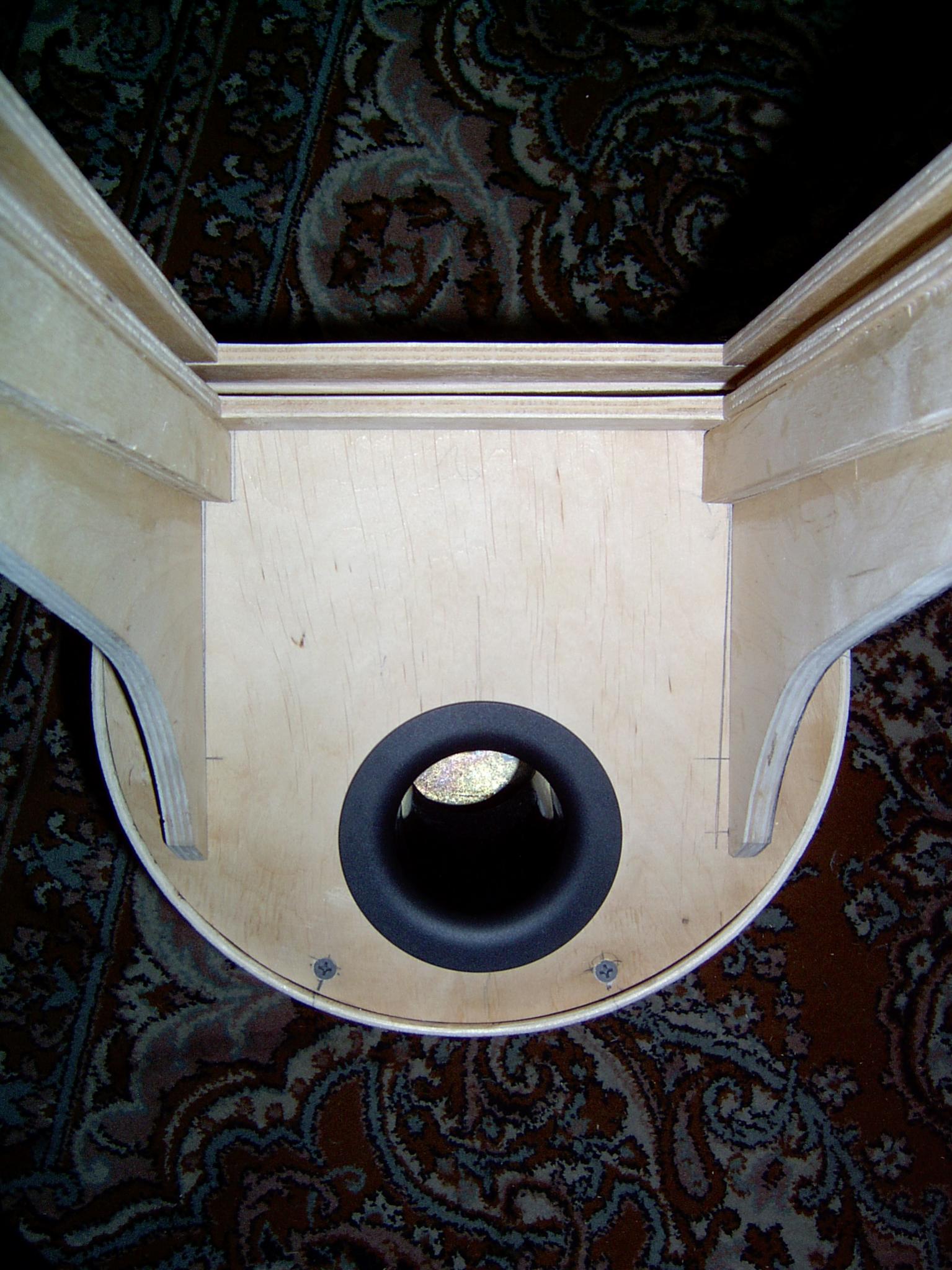

Excellent hybrid speakers, but here's my version. Unique-sounding, and minimum sizes. bandwidth of 35 Hz - 20000 Hz. 90dB sensitivity.As I'ts my speakers, I think any judgement of the sound will be coloured - I'll leave that to others! 😉
/R
Statics man, I think your speakers are exceptional too. I hope you will do a full-up project posting to illustrate more details, build sequence, in-process photos, etc.. of your gorgeous speakers.
nice design statics man.would you be willing to tell us your d/s spacing and bias voltage in order to get a decent sensitivity of 90db. jer
Statics Man--Love your design! It's great to see something with a bit of twist on the usual implementations. I've been very impressed with the "industrial design" aspects of some of the diy ESLs posted here lately. Yours are certainly in that group of "speakers to be admired." More construction and performance details would be of great interest.
Few
Few
Hi Statics Man,
Your speakers look really nice. Would you mind sharing with us the details of your construction? 90 dB sensitivity is really nice. How do you achieve that?
Wachara C.
Wachara C.
Nice work Statics man! 🙂
It would be nice to se a new posting abt. the details of your speakers - many questions!
/R
/R
Hi Statics man!
Veeeery nice speakers! A question; are the diaphragms segmented with spacers somewhere or is the whole diaphragm in action as one piece?
regards,
Bent
regards,
Bent
Esl
Hello all.
I am glad that you are more interested, my design.
Here are details of my design
ESL speaker size - 1000mm x 180mm
spacer - 1.8mm
polarization voltage = 3400V
Audio transformer is n = 100
Membrane 6мкм. Coated on both sides, graphite resistance layer
5 x 10E8 ohms and then coated nylon 66.
Hello all.
spacer - 1.8mm
