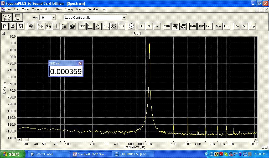

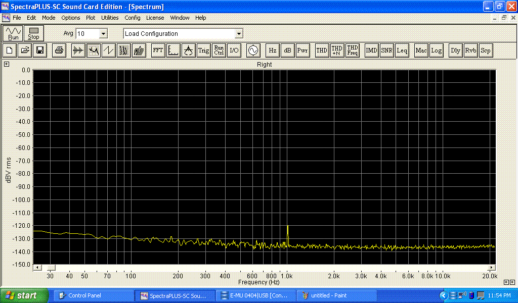

Hi Everybody,
I know it's been a while but I'm back. I finally got around to purchasing a E-MU 0404 and took some measurements last night off my ES9018 DAC with two DAC boards stacked (8 DACs/Channel) and my I/V-Amp1 board. I did the test using a stock non-modified E-MU.
I've attached a couple THD plots. Each measurement is from the single ended unbalanced outputs of the I/V-Amp1 board. I'll have to buy some cables to check the balanced outputs. The first plot shows THD+N using a 1Khz tone at 0dB (1.0Vrms). The second shows a 1Khz spectrum down to -120dB showing the DACs ability to resolve the tinniest details. I plan on modifying my E-MU to see if I can lower the numbers even more but I can't argue with THD+N at 0.000359.
I'll be provide an update on what else is going on this weekend.
Best regards,
Al

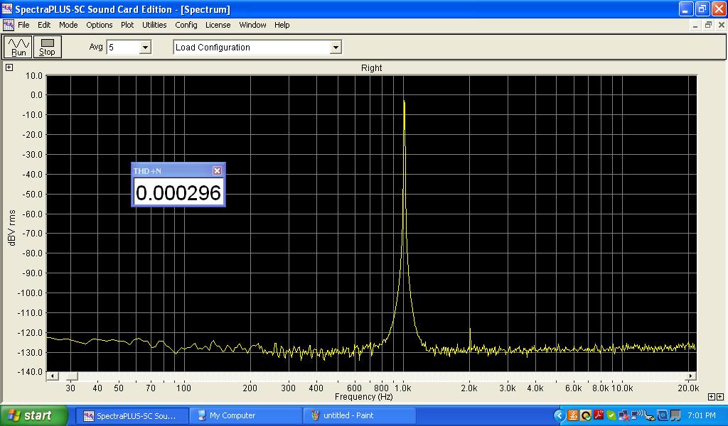

Great measurements. Lower THD+N than the Benchmark DAC1. I actually wasn't aware that the EM-U 0404 could measure that low.
Hi maxw,
Not bad for a $150 dollars. Attached is a new THD+N plot measuring even lower using the S/PDIF input of my DAC with SpectraPlus's signal generator supplying the 1Khz @0dB tone which I trust a lot more. I think there's a problem with the online tone generator wav file that I was using as my input source on the previous plots. I think 0.000296 is more like it. I think after I modify my E-MU that THD+N could be even lower.
Best regards,
Al
Best regards,
Al

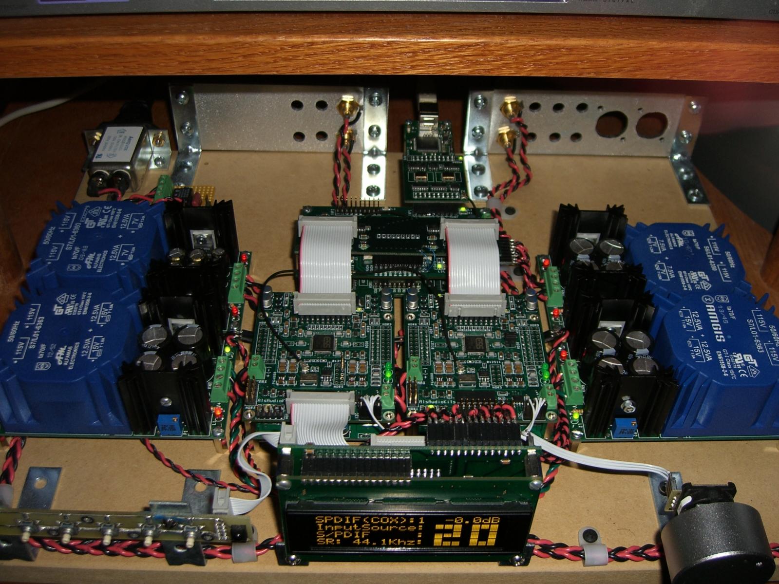

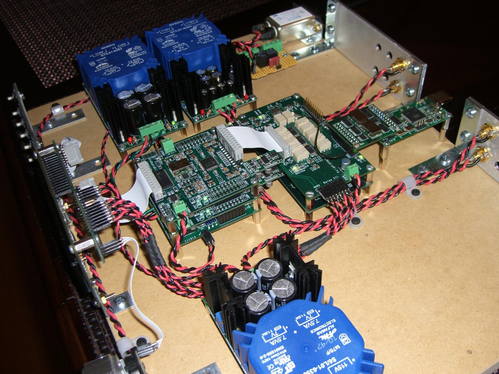

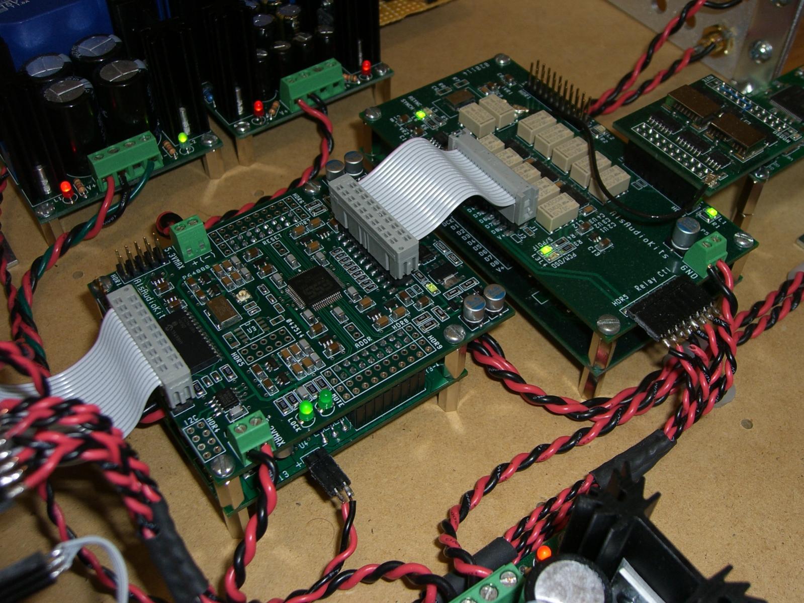

Hi Everybody,
Just finished testing the new DAC with the on-board ultra low noise series regulator for AVCC, and it works great. The regulators use to be on two separate boards and had to be soldered to the main DAC board. It's nice that adding the regulator on board has not only helped reduce cost but also helped lower THD + N even more. Now with the new DAC operating I'll finish a second DAC and use it in testing the last remaining set up, dual-mono with two DACS side by side.
I've attached a couple pics of the new DAC and my new larger test platform that matches the size of the enclosure (12" x 16"). It's really helped with testing and determining where all the mounting holes need to go to support all the different setups. In the pics you'll see the new I2S/DSD board that provides switching between an on-board Asynchronous Crystek 82fSec oscillator, or two external Synchronous or Asynchronous clocks. I've also added a Raspberry Pi compatible input to the second I2S/DSD input. So you can select between an Amanero or XMOS on one input or Raspberry Pi on the other. I'm now so glad that I added that second I2S/DSD input. The new PS using the LT1764 is also pictured, first pic top right. The first pic shows a dual-mono stacked setup with the old external regulators. The second pic shows the new DAC board with the new AVCC regulator on board.
Lastly, the GB is still on but I won't set a date until I'm completely ready. I nearly burned myself out the last time trying to meet a specific date while juggling the time constraints that come with a full time job, family..etc. I won't do that again. But one things for sure, I will slash prices on the first 25 units to near cost. If your interested please sign on. If you expressed interest before your spot is still good but please let me know.
Best regards,
Al

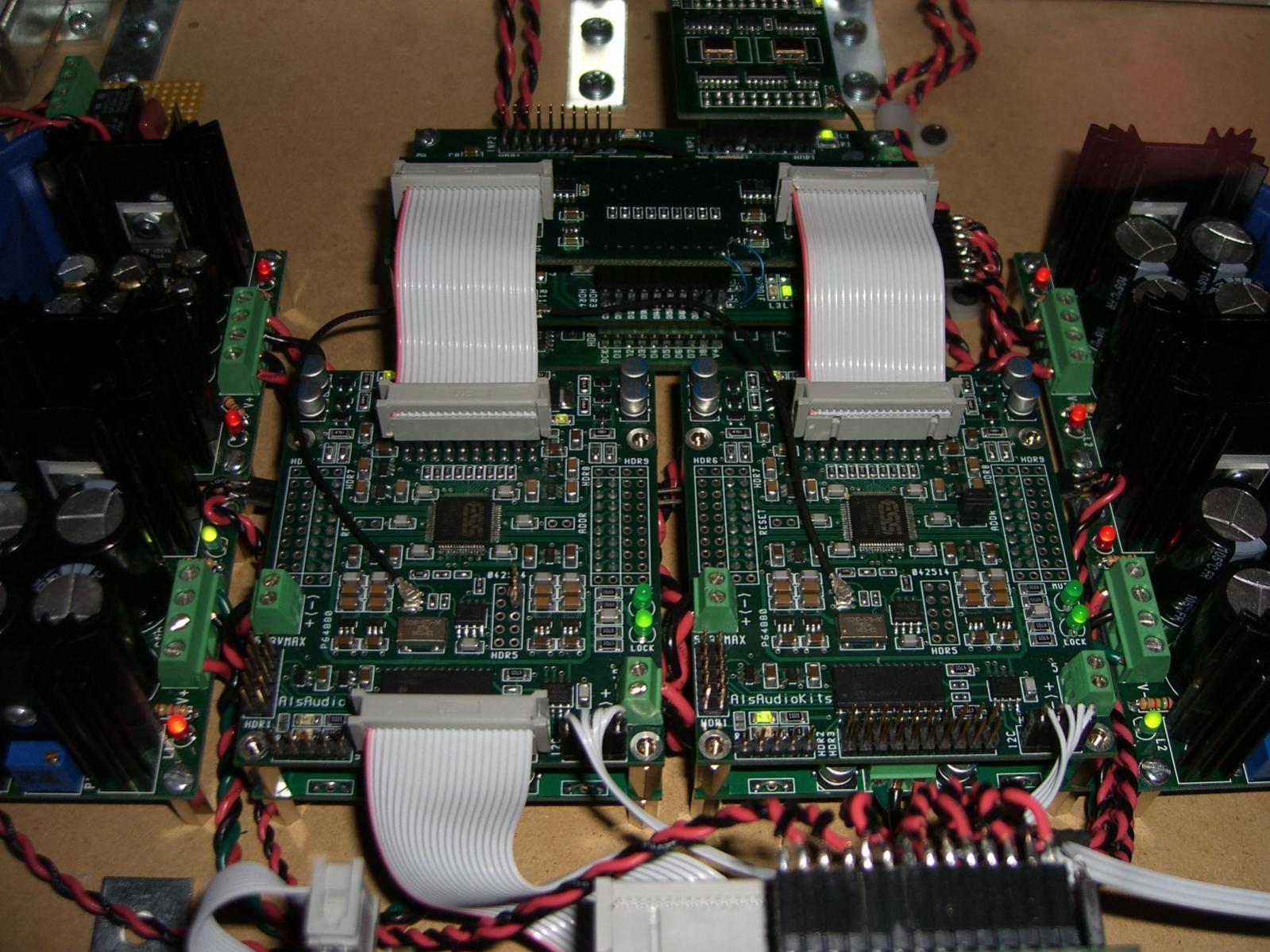

Hi Everybody,
I'm happy to announce that dual-mono with side-by-side DACs is up and running and sounding incredible with THD+N on the SE outputs at better than 0.0003%. That pretty much completes all the testing. I don't think there's anything my setup can't handle. Next comes the enclosure, and then I should be ready to make it available to those that are still interested.
One quick observation on the dual-mono setup versus the stacked approach. I don't see any difference in the measurements, both methods have THD+N at better than .0003% at 1Khz, 2.0Vrms peak-to-peak. Sound wise they both sound incredible and I doubt anybody could tell the difference between the two. The stacked approach is cheaper, and doesn't require addressing the DACs separately so I prefer it. Either way I can do both.
Let me also mention that I prefer the sound of Synchronous clocking on the I2S/DSD inputs versus Asynchronous clocking. Since I can switch between them on the fly after doing some A/B comparisons I can hear a noticeable difference. I've read some members make similar observations, I concur. I can also see a very slight improvement in THD. A pic of my dual-mono setup is attached. If anybody has any question please feel free to ask.
