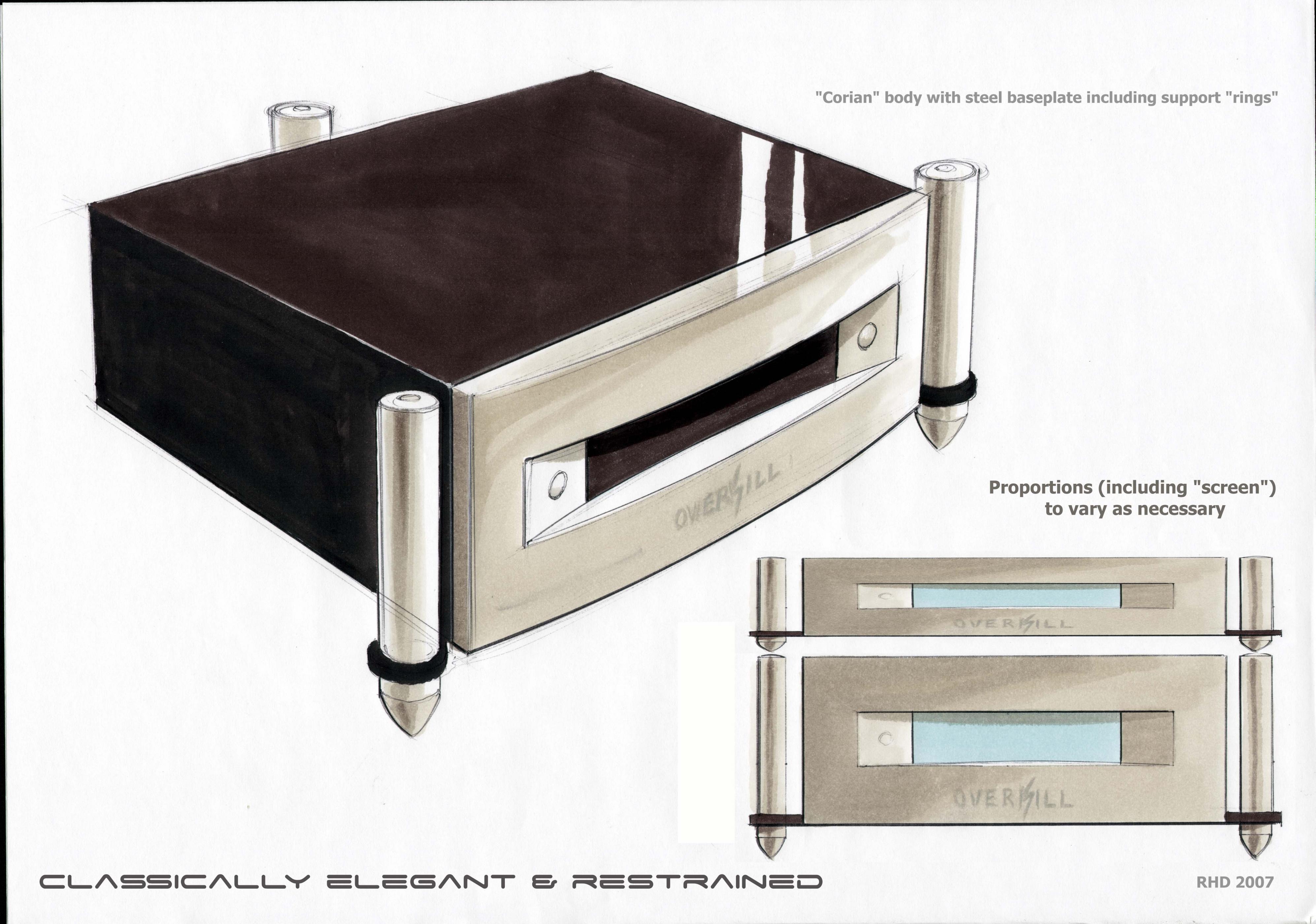

PS I have attached a couple of ideas for cool case work.

Thanks Derek for the morale boost🙂 Love the enclosures. Did you machine them yourself?

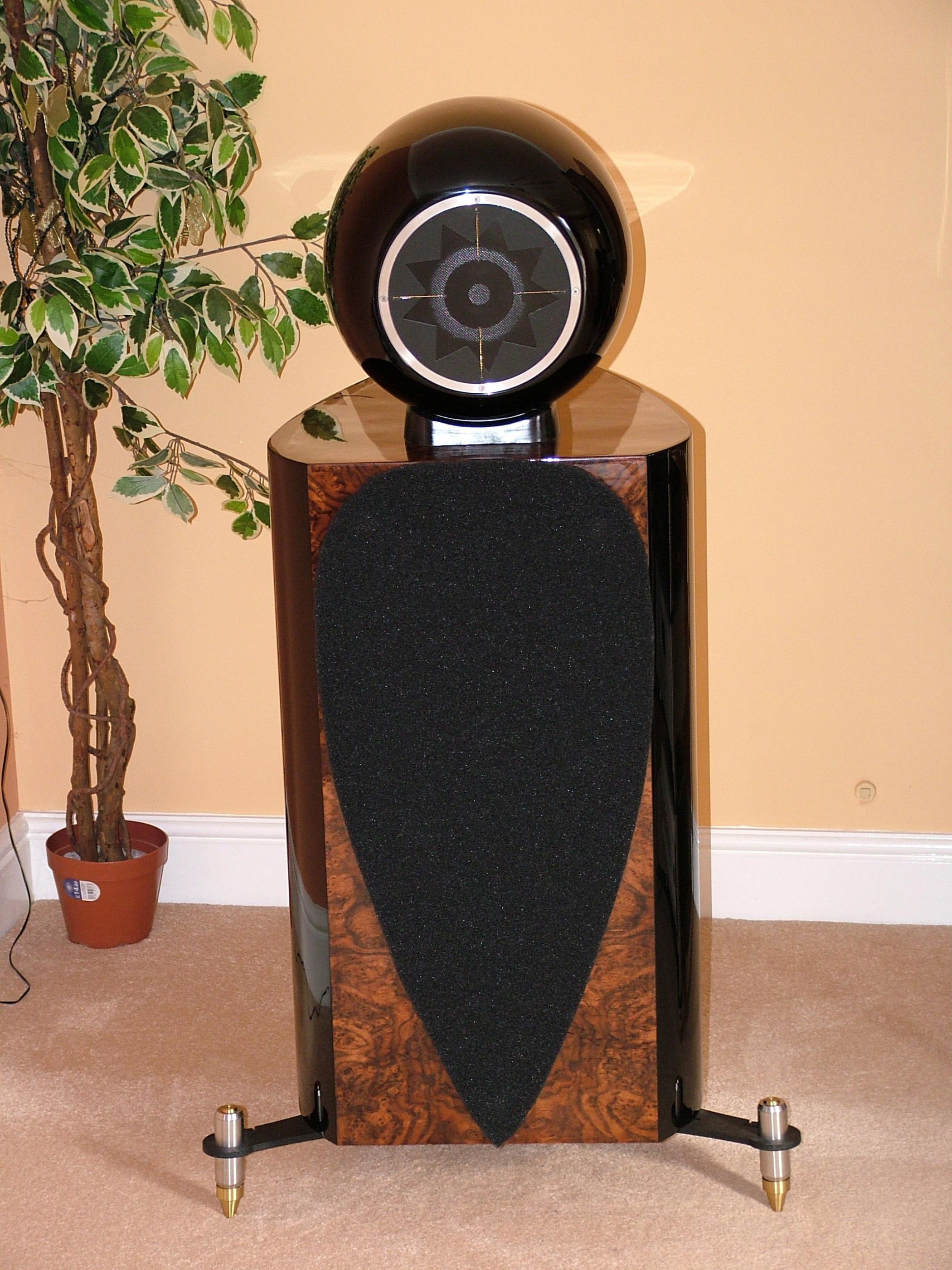

Enclosures
....Love the enclosures. Did you machine them yourself?
Hi Al,
I did all the mechanical and industrial design and got all the alloy machined at a local company ( Micron Engineering) and the finishing at another firm, cant remember where!
I based the principal on the beautiful loudspeaker stands made by Sistrum
SP-101
This Sistrum technology really works, it was an astonishing upgrade when I used them with my loudspeakers and also a great improvement when the electronics were installed in the Sistrum principal casework Vs a plain alloy box for testing.
Cheers
Derek.

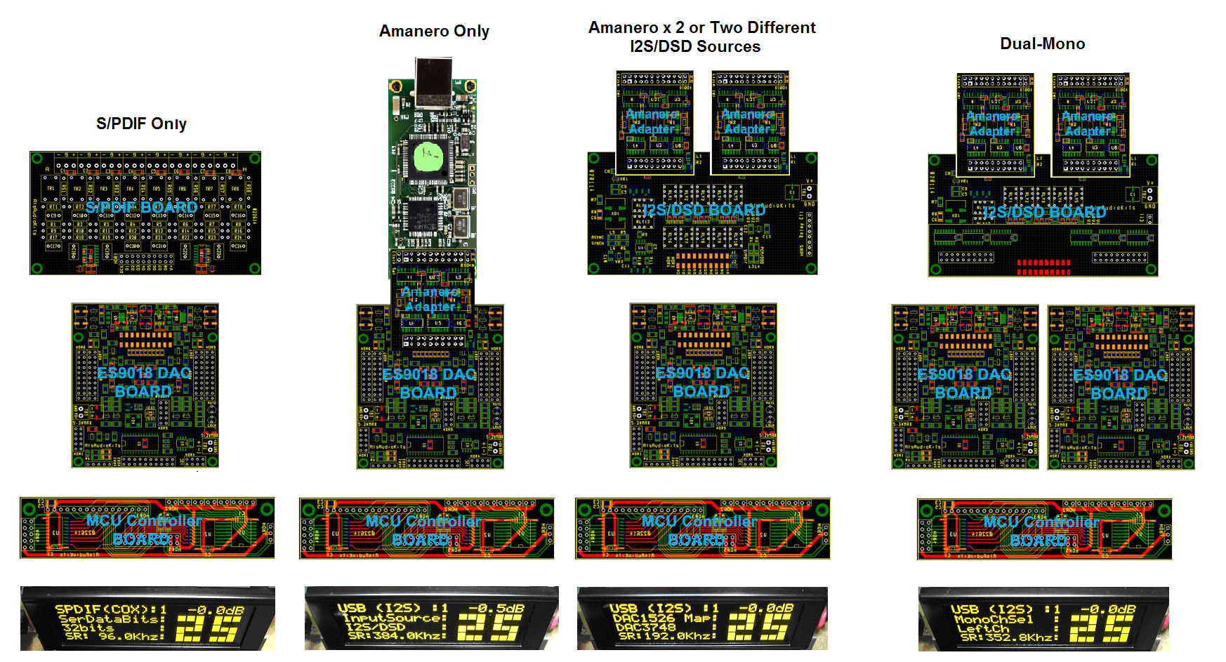

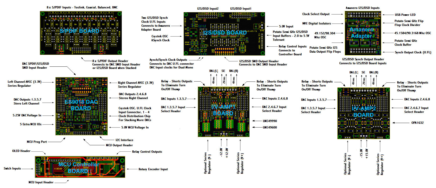

Hi Everybody,
Attached are a couple files that I think are pretty self explanatory. I hope the files help paint a clearer picture on how everything pieces together.
The first file shows all the boards listed on the price list, except the power supplies and the dual-mono data fan-out board for dual-mono applications. The dual-mono setup is illustrated in the setups file. The PCB pics are not to scale.
The second file shows a simple top view of four different setups from S/PDIF only to Dual-Mono so you get a good idea on how things flow. I've shown four setups but I'm barely scratching the surface on all the possibilities.
Please take a look at the two files and let me know if you have any questions. If you have any issues with the pricing please let know. I really want everybody whose been patiently waiting to get in on the initial run.
Best regards,
Al

Hello Al, will I need the "controller board" if my preference for volume control would be from the player (don't know exactly how this works, but on my iPad app that drives the MPD player there is a volume control and I'l like to use that).
So for a 6 channel configuration I will need the DAC board (+ controller board?)
plus three I2S boards (will I need the SPDIF board as well ??) plus 3 I/V-AMP boards, plus power supply and enclosure.
Correct ??
Thanks, Alex
Correct ??
Thanks, Alex
Hi Alex,
For three I2S inputs all you need is one DAC, and three I/V-Amp2 boards. There's need for the I/V-Amp1 since there's only one DAC/Channel. The I/V-Amp2 is also cheaper. I'll get you the price this week. There's also no need for the S/PDIF or I2S/DSD board. The three I2S signals can connect directly to the DAC board as long as the I2S cables are about 10cm in length or less. There's no need for the controller or OLED, and input switch board unless you need a power switch. But I could connect a single momentary switch directly to the MCU header. It will take some firmware changes but i can do it for you.
If you're interested with this set up, let me know. I'll put you on the list. I believe you're already on it and will kick off the group buy.
My target is 25 to 50 diyAudio members to complete the group buy.
Best regards,
Al
Best regards,
Al

Hi Alex,
I meant there's no need for Amp1. The BOM for I/V-Amp2 is almost complete so I'll have the total price for you sometime this week. I'll add an additional 10% discount for I/V-Amp2 since you're ordering more than one board.
Thanks for the interest.
Al

Hi Al
I have (quite) a few questions.
DOes the DAC board seriously have 12 regulators??
I was just looking at your connection diagram. It doesn't show the I/V boards. Could you explain the difference in the AMP1 and AMP2 boards? SInce I will not require balanced outputs, are the I/V boards available without all those extra (expensive) components?
Will all the complete boards be available for separate purchase?
I am still interested in your DAC. The main attraction for me is the implementation of the volume controls, and the fact that you make all 8 channels available at the outputs. I also appreciate your "no holes barred" design approach. The sticking point for me is the extra cost of the I/V stages at 3x $275. An 8 channel single ended I/V board at $275 would be fine for me.🙂
Jeremy

Hi 2channel,
Of course there's 12 regulators including the series regulators for AVCC for both channels. Not sure why you would question it? The difference between Amp1 and Amp2 is listed in the price list. Amp2 will cheaper by about $50/board maybe less. No, I can't remove components for SE only.
As far as the price of Amp1 it's $247.50 with the 10% discount. I'll add another 10% off if more than one is ordered, it brings the price down to $220.00/board. The same discount for more than one applies to the DAC and Amp2 also.
Best regards,
Al
