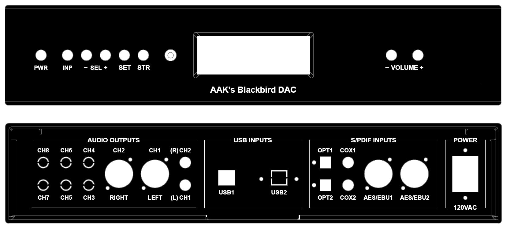

1. Is it possible to change the font of the front panel?
2. Is it possible to add IR input for remote control?
3. Is it possible to add atleast one optical SPDIF input?
4. Whats the price for everything except the case?
Hi RobFreak,
I think you mean the back panel. For some reason the font looks messed up on protocase's 3D CAD program. The actual font will look much better.
The front panel does have a small hole with a 2.5mm radius for the IR detector.
There's two optical S/PDIF inputs on the back panel.
I'm selling the enclosure at cost so without it the price would be $1075.00
Hi RobFreak,

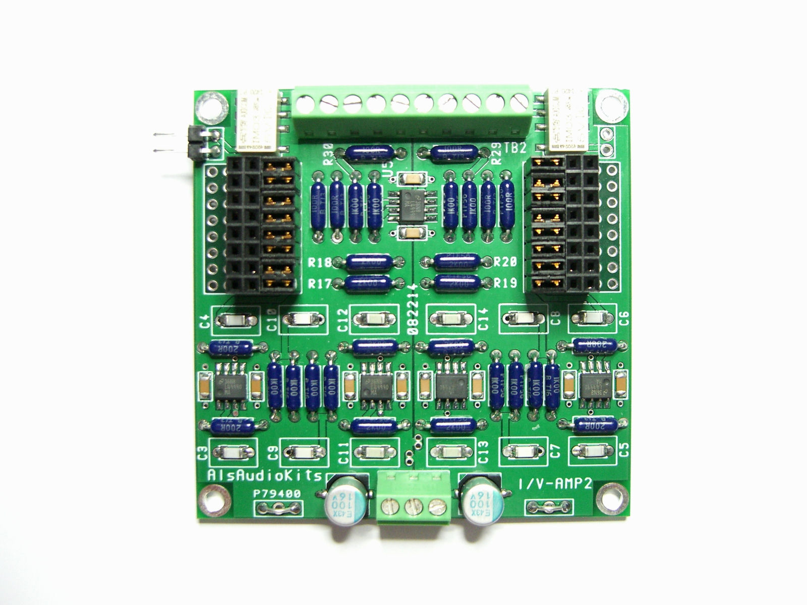

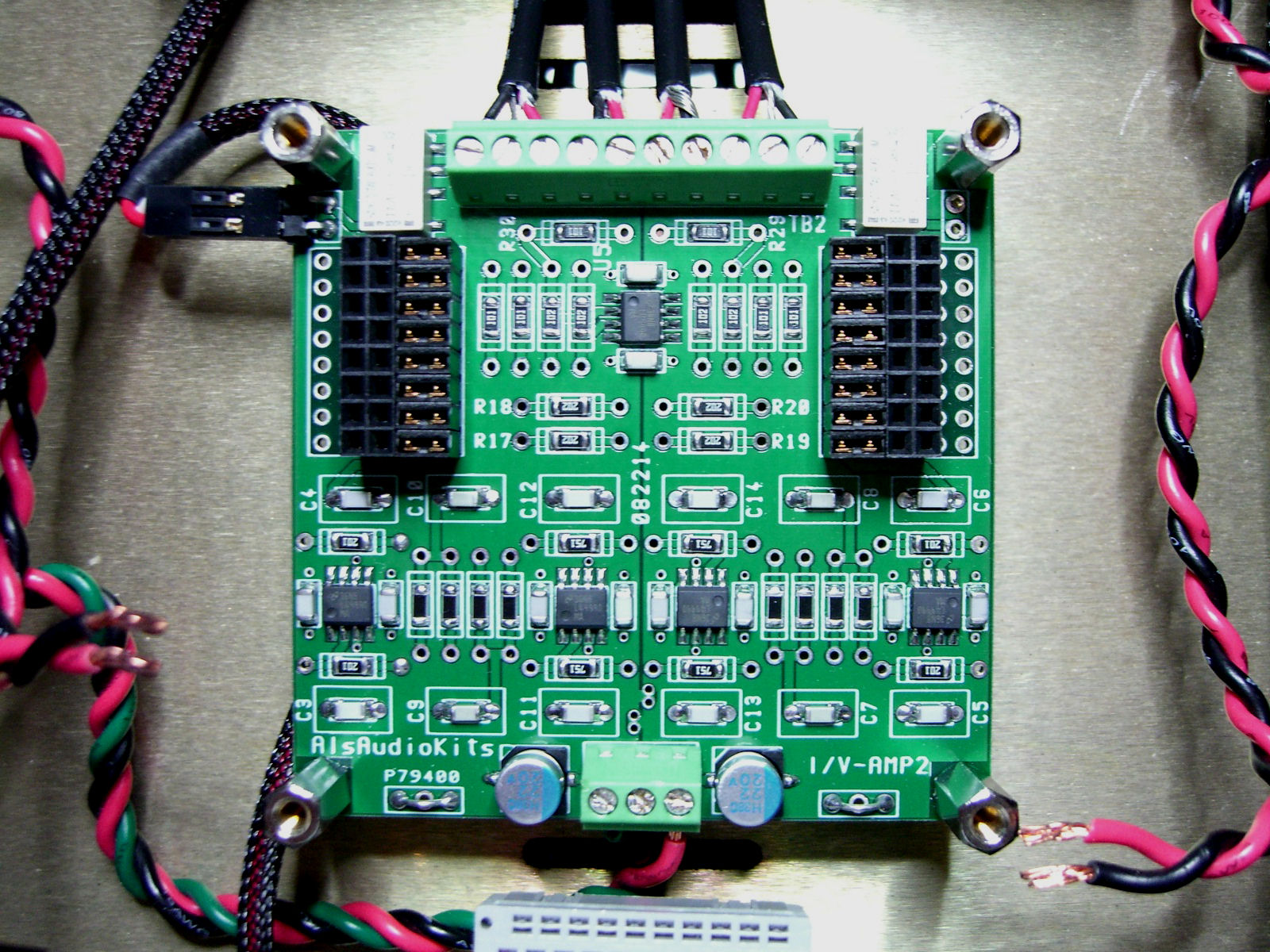

Hi rredline,
Attached is couple pics of my IV_Amp2, one with Panasonic SMD thin film resistors and the other with through hole Vishay PTF56 resistors. The OP-Amps are LME49990s, there's five on top and bottom. I'll try to get you a pic of the S/PDIF board sometime this weekend.
Al
Al

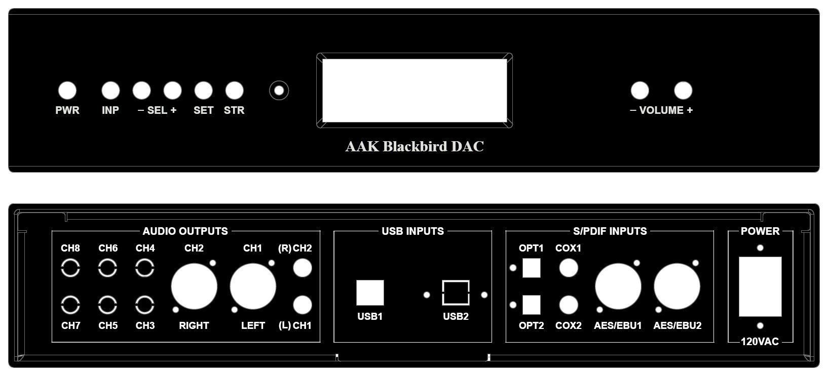

Hi Everyone,
Just wanted to attach a new pic of the front panel with the some new changes based on some very good tips from diyAudio member. Thanks! The changes are in the front name, the name font, and letter coloring. The coloring is something closer to silver than white to reduce the contrast just a bit. Thanks again for the tips. I also attached a pdf file showing the enclosure in 3D.
There's been some questions on the whether my power supply modules support 230VAC. The answer is yes. The transformers that I'm using for both the DAC and I/V power supply modules support both 115VAC/230VAC power inputs. I have power supply boards for each power input.
If anybody has any questions please feel free to ask.
Best regards,
Al
Best regards,
Al
