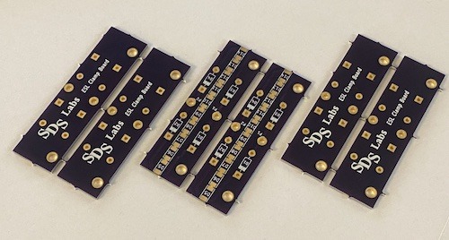

(off topic) @stokessd--The ESL clamp boards I ordered from osh park arrived a couple weeks ago. Much appreciated! Quality appears to be pretty good.

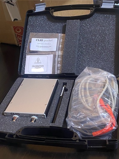

Just another update:
I'm in the process of acquiring a CLIO Pocket system for performing more thorough measurements at home. This is how I tried to justify getting a CLIO Pocket system (though it's quite reasonably priced already, at a few hundreds USD--more affordable than many audiophile accessories):
  • An analog microphone (vs. the miniDSP USB microphone I have been using) will be needed to use REW for certain measurements (where latency matters) anyway. The CLIO Pocket comes with one.
  • The CLIO Pocket workflow appears to be pretty streamlined and is well organized/documented. Measuring RLC components is also a handy feature.
It's also good to know that the CLIO Pocket software has a native MacOS version.
Given that we already have the powerful free software tools such as VituixCAD, Xsim, XMachina, etc. (huge thanks to the brilliant and generous creators!), and also the possibility of configuring a poor man's Klippel system (thanks to that thread), figuring out a crossover on the primary side of the Acorn's step-up transformers that addresses most of the issues encountered is likely just a matter of time.
As for placing the crossover on the secondary side of the step-up transformers, per Quad, I would still need to figure out how to properly measure and model the diaphragm of electrostatics. Wondering if anyone has already studied or done it and could shed some light on the subject?
Got my CLIO Pocket. The microphone requires a special holder due to its small diameter (10mm). I didn't order the holder because registered users can just get the 3D mesh files from the Audiomatica site and 3D-print it.
Plan is to measure the impedance and frequency response of each panel, and use the generated zma and frd files for crossover design. Not sure which crossover type would work better with electrostatics--LR2, LR4, or perhaps the high order elliptical type? This being an electrostatic/panel type speaker while crossover design and simulation software is written for dynamic drivers, there are quite a few things needing to be thought through and experimented/verified. Still, happy to be able to start working on the Acorn again.
