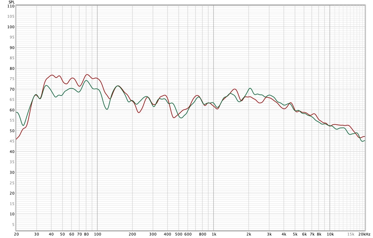

I suspected the raised frame edges on the front side might be sonically undesirable and decided to move the U shaped channels (that hold the panels) forward. These channels are fixed with strong double sided tapes, hence not difficult to relocate. After the change the panels now sit protruding a few millimeters from the frame.
Before:
After:

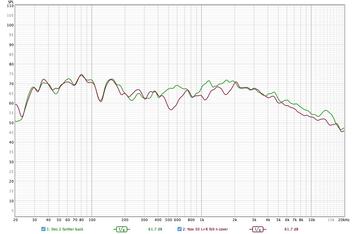

The whole back side is now covered with a 3mm thick sheet of wool felt (before the fabric cover is put on):
The REW room/speakers measurements before and after these changes; the green curve being the "after" one.
The sound has gained more warmth, perhaps because the low bass is now better controlled. Somehow the midrange brightness is improved a little too, but getting rid of the midrange anomaly is still my top priority for the frame redesign. The Acorn seems to be very sensitive to cancellation/reinforcement from diffraction/reflection--Perhaps a super slim frame is the way to go. Carbon fiber rails?
I've ordered 5mm thick wool felt sheets and will experiment with more back damping.

Meanwhile I tried to alleviate the midrange surges by re-positioning the Acorns in my room. When none of the away-from-the-side-walls positions worked, I decided to take the opposite approach just to see what would happen. I noticed a big improvement immediately and finally settled on 34cm between the outer edge of the panel and the side wall. This is counterintuitive but very nice as far as aesthetics and WAF are concerned, because the speakers sort of "disappear" visually. Sonically, other than a smoother and warmer sound, the soundstage becomes even wider and extends beyond the speakers with many recordings.
I then called up REW to take a measurement, which appeared to agree with what I heard, as shown in the graph below (the green curve). Note that the gradually falling highs are the result of off-axis measurement because the Acorns are not toed-in.

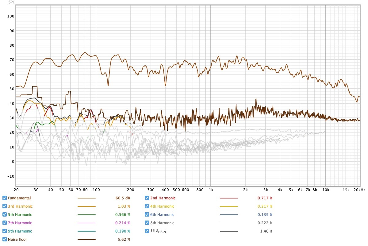

Here's the distortion graph view of the same measurement, just for reference.

I tried wool felt of 2mm and 5mm in thickness for back damping and found the thicker felt to suppress the bass (below 100Hz) a little too much, otherwise no noticeable differences in mid and treble. For me the 2mm felt seems to work just fine. I will try the less dense "mover's felt," especially for the mid/treble, to see how it works.
In an effort to identify the cause of the midrange aberration, I moved one channel of the Acorn to the middle of my listening space (hence farther away from both side walls) and measured the bass, midrange, treble separately, as well as all combined, with the microphone placed at 2 meters. The combined measurement now showed a peak at 3kHz and a dip at 400Hz. The treble only measurement also shows the same 3kHz peak, which is reminiscent of the 2nd order high pass filter with a higher Q of a DIY speaker project from years ago. Out of curiosity I removed the inductor in the treble high pass filter (a 2nd order one) just to see if the peak would go away. It did so I proceeded to try different values for the remaining capacitor, and settled on 0.47uF based on measurements. I will continue tweaking the crossover with Rob's help and share my findings here.
Taking and interpreting speaker/room measurements does require involved learning, but I feel that even before one has the time to really study it, it's still an effective/efficient tool for tweaking speakers, and could potentially save one tons of time.

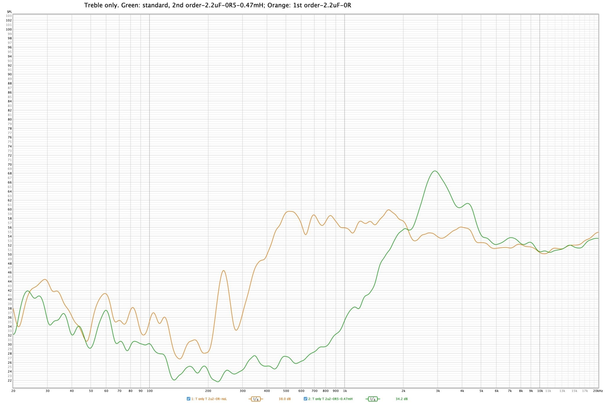

Hey interesting.
Now crossovers on ESL's are complex and do not conform to convention due to the naturally rising response of the panels.
I am a little confused however, as I remember reading somewhere that the Acorns "tweeter section" was handing over to the midrange section at 6K, not 3K!
The midrange was then theoretically handing off to the bass panels at roughly 250Hz.
The plot without inductor looks almost like mid and treble panels.

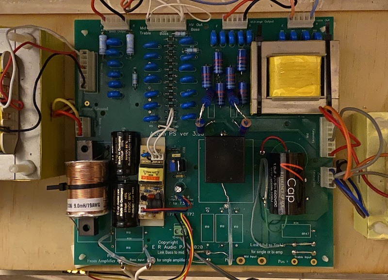

I am sure the Acorn's crossover as supplied works well. In my case, the midrange peak present in my implementation needed to be taken care of. Not capable of doing simulation or calculating on paper first (the capacitance of the panels and the transformers make things a lot more complicated), I simply relied on measurements and Rob's suggestions to arrive at what is to me a closer-to-ideal result. It's my experience that good-sounding speakers almost always measured relatively flat--in my listening room at least.
The Acorn has its crossover placed before the step-up transformers, unlike the Quad ESL (the '57), so the crossover components aren't exposed to high voltages. This makes experimenting with different RC parts/values much easier. I also appreciate that its PCB can be taken off rather quickly by simply unplugging all the connectors to the panels and transformers. I have probably done it a hundred times over these past couple weeks! 😀

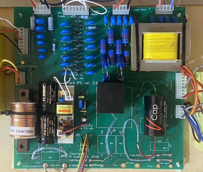

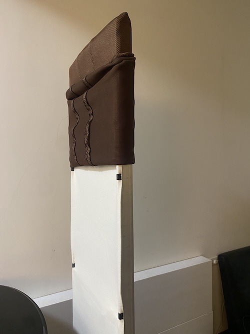

Realized that the lead orientation of the treble capacitor wasn't following the manufacturer's recommendation (that the outermost foil be connected to the lower impedance path to ground) and corrected it:
The Acorns are sounding terrific after these changes. However in order to narrow the spectrum the treble panel covers so as not to "overwork" it long term, I have ordered two inductors (which I would feel more comfortable unwinding to adjust their inductance) to experiment with reverting to a 2nd order high pass filter for the treble section, albeit with a different Q factor.

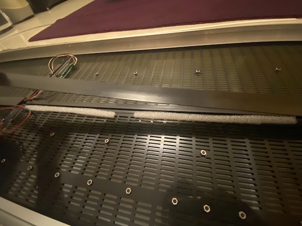

I found that the compacted wool felt I used really doesn't shed any fiber, hence no need for the protective fabric cover. Clipping the felt directly to the side rails allows it to fit the frame more snugly.

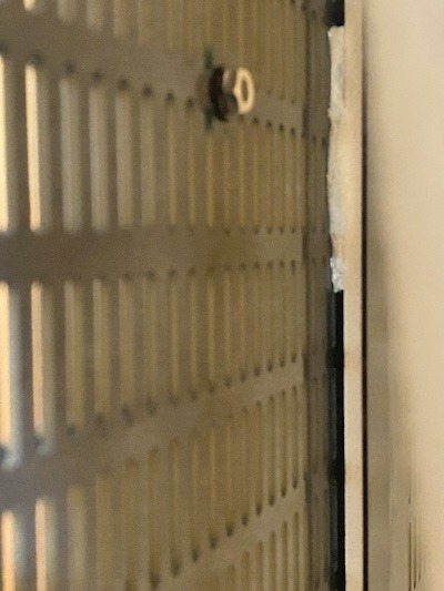

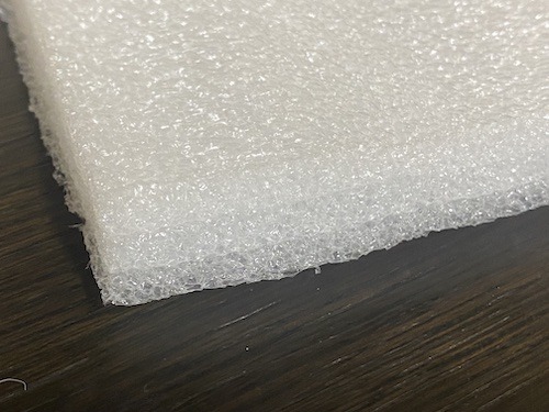

Occasionally vibrations would occur at an edge spot on one of the midrange panels (where it's clamped together with the bass panel). Following Rob's suggestion, I cut and put a narrow piece of EPE between the panel and the white spacing strip behind it (I used a credit card to gently push it in the gap). Worked like a charm. This is an easy and effective fix before I can make the time to design and construct new frames. Looking at the photo closely, one can see that the innermost openings are partially blocked by the clamps--something to consider when designing the new frames.
EPE sheets are usually multi-layered, and can be easily cut down to the desired thickness.

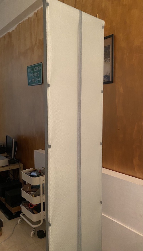

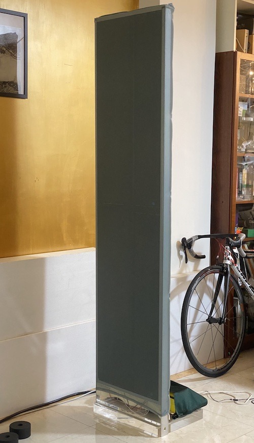

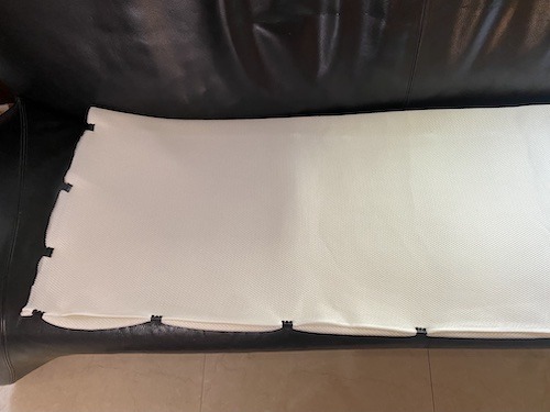

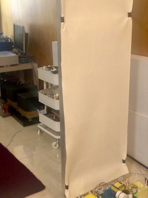

New dress on
The new single layer fabric is basically see-through transparent

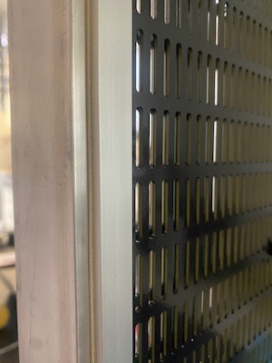

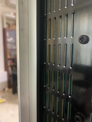

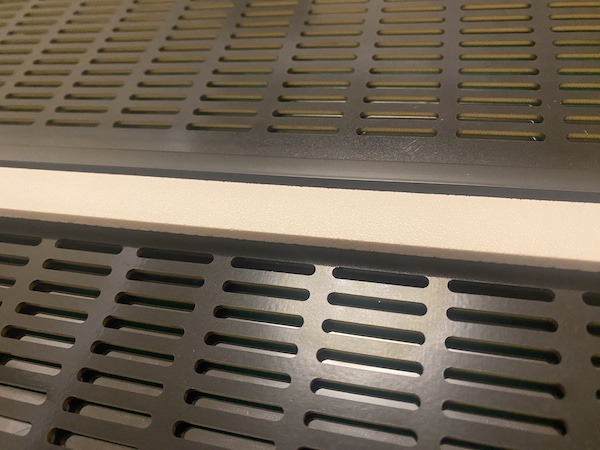

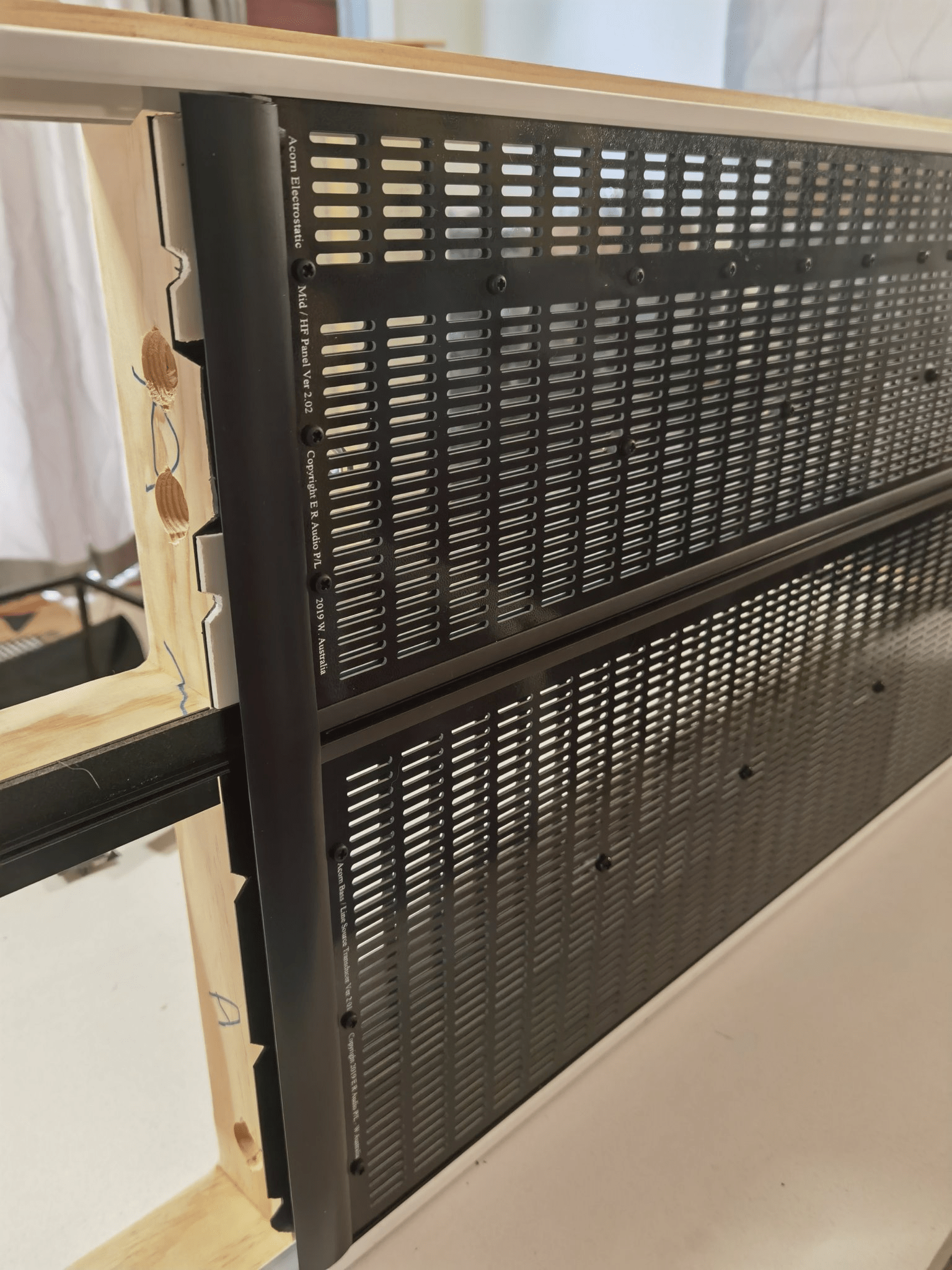

I also replaced the white spacer behind the mid/treble panel with EPE strips on both sides of the panel. This would also position the mid/treble diaphragm on the same plane as the bass diaphragm.
Close-up of the white spacer. The bass panel is thicker than the mid/treble panel, but both are clamped by the same set of clips, hence a spacer is needed behind the mid/treble panel. In practice however, the spacer would often come loose.
EPE strips in place of the spacer on both front and back sides of the mid/treble panels.

New dress on

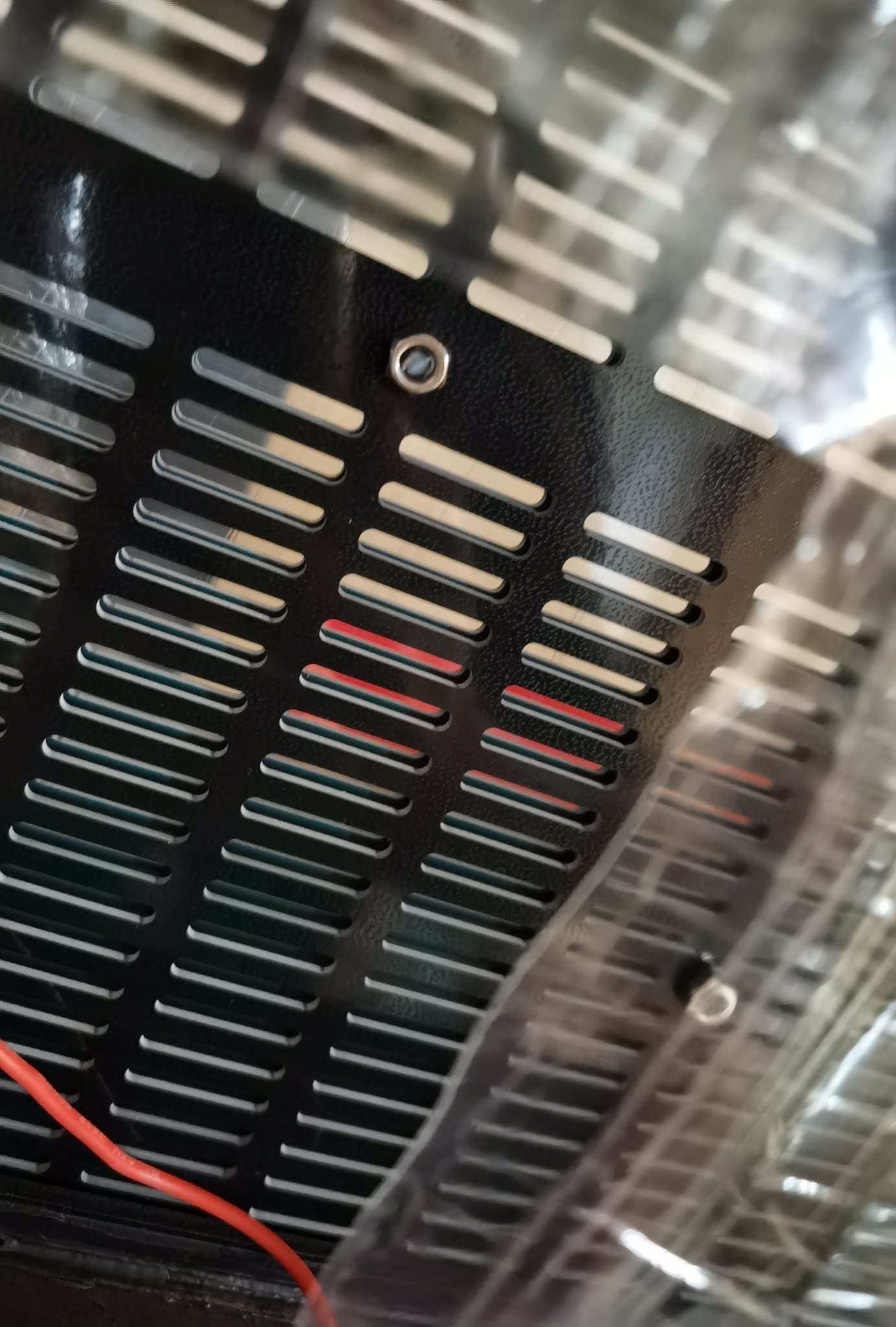

like you use of computer components etc !! i looked at this image and is there something wrong with the mylar in the left side of the upper panel ?
Hi WrineX--The panel surface in the photo seems to have some discoloring. I can't really tell if there's something wrong with the mylar (looks normal to me). Grant has been working on getting his Acorns ready so maybe we will hear from him about it soon.
The computer components I use for my JPlay based digital source system are mostly based on the recommendations from the thread on the Taiwanese forum I mentioned in post #3.
Interesting, I was a bit disturbed when I zoomed in too.i looked at this image and is there something wrong with the mylar in the left side of the upper panel ?
However ...
This is a photo at the rear of the same panel.
As you can now see the "speckled" surface is actually the paint finish of the outer surface of the stators, not the diaphragm.
The appearance is alot worse looking in the original photo because of, wierd lighting, weird depth of field effects and my poor photographic skills. 🤣
And I almost embarrassed myself further, by say "Aw shucks, my SOtM SMS200 is hardly bleeding edge computer technology. 🤓"
