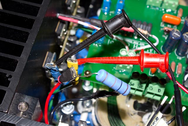

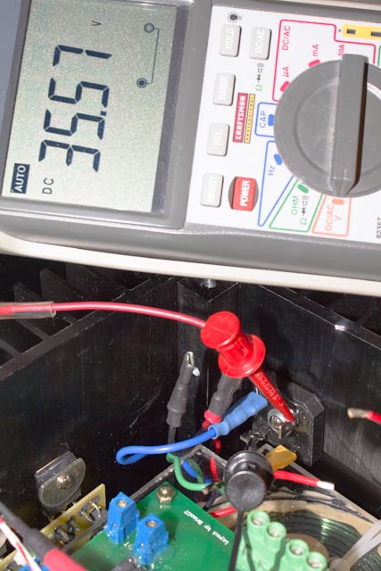

It would also help if you post pictures of the meter connection for each measurement, so that we are sure that you are measuring the proper voltage. This may require a bit of disassembly to get clear pictures.

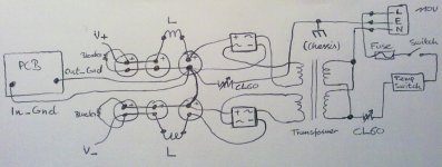

Attached you'll find what I intended to post earlier.

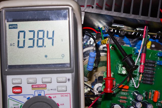

Don't worry about this, that was when I started taken measurements and the secondaries were mix up, already fixed.did you measure at the trafo sec? and got 75Vdc?
you must measure Vac at this point.

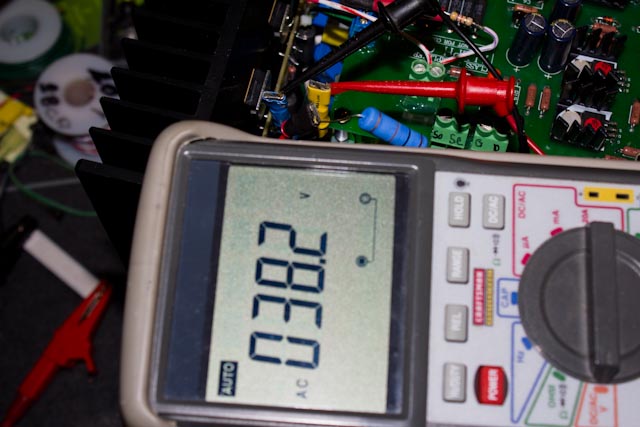

Right Pair is 38.2 vacDave just accidentally drew two channels instead of one, ignore it.
Your PS is totally screwed up. You should have around +50 DC from the neg spkr term to the pos rail, -50 to the neg rail, and 100 volts from pos rail to neg rail.
Disconnect all 4 secondary leads from the bridges and measure the AC voltage of each pair. If they are not very close to the same there is no logical reason to go any further, your trafo is bad. They should measure around 35 volts AC or whatever the trafo label says.
Only if they are the same should you proceed any further.
Disconnect all the DC connections from the bridges and reconnect the bridges to the secondary trafo leads. Measure the DC voltage at each bridge output from plus to minus. If they are not very close to the same, one of the bridges is bad or the trafo is bad.
If things still check out correctly at this point then either you have seriously miswired the filter section or one or more of your caps is bad. Disconnect the amp board from the power supply until you have a properly working power supply. There is absolutely no reason to go any further until you do.

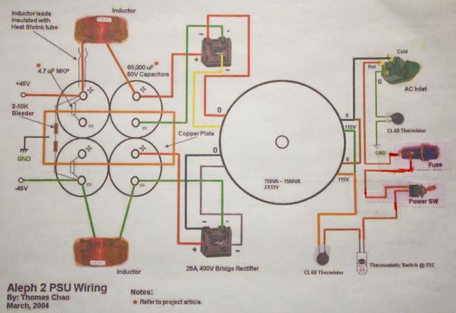

Which two of the four wires that connect to the plus and minus terminals are connected to the neutral (ground) of the filter section?
While you're at it, trace all four wires to their filter connections and label them with what they go to. We don't know if the colors of them mean anything so we are going to ignore the colors of the wires.
Black to neutral , Red to positive.OK.
Ahh - one wire from each bridge connects to the GROUND bus bar. Which ones? (hint - you gave the wrong answer above.)
Connect the one wire from each bridge to the bus bar, clip the black lead of your meter to the ground bar and measure the DC voltage to the unconnected bridge terminals. You should get a + and - voltage again.
Notice in your psu plan that one bank of caps connects the negative terminal to the ground bus and the other connects the positive terminal to ground. Verify the you have them connected that way.
