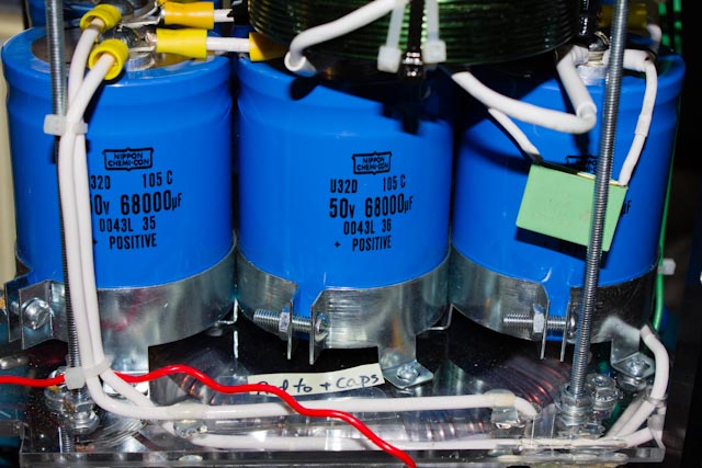

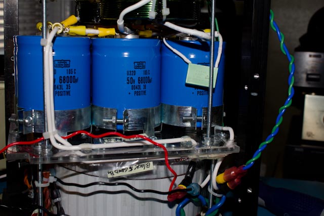

I understand you Bob, and I thank you all guys, sorry if I misleading you when I said left and right bridges , just saying the position they have on the chassis.But, since JPDuarte has been so ambiguous about what wire goes where, specifying his right and left without knowing what leads he has there may lead him to miswire it. Let's wait until he verifies the connections before we tell him anything. Remember that we are not dealing with an experienced builder, what is easy and obvious to us doesn't seem so to him.

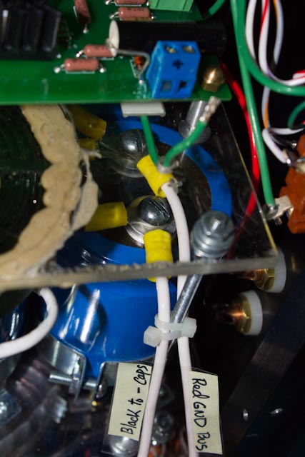

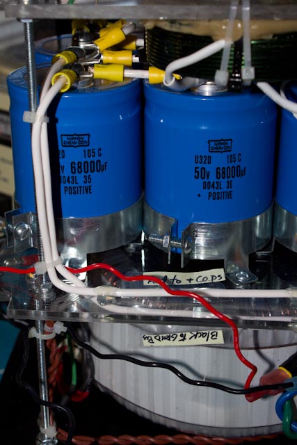

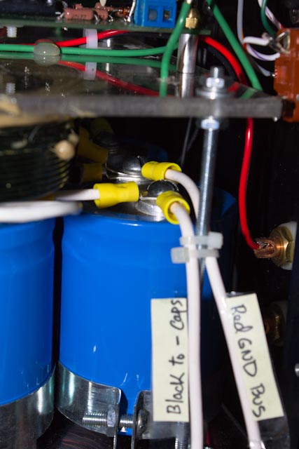

Ambiguity alert - I hope that you don't mean right and left bridge. I took this to mean that the black wire on the left in this photo connects to the negative terminal of the cap bank and the red wire on the right in this picture connects to ground.

Ok, I' do it .OK, now verify the other pair are of the correct polarity.
Yes, I just noticed 😀He's just mad at me, I'm generally too blunt for a lot of people, but I usually get my point across.

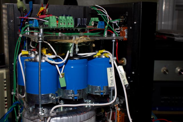

So you have identified and labeled the wires running to the other bridge as going to ground and the positive side of the cap bank?
If so, connect them appropriately. The positive bank plus terminal goes to the positive terminal on the bridge, the negative terminal on that bridge goes to ground. The negative bank terminal connects to the other bridge's negative terminal and that bridge's positive terminal to ground.
Now use your variac to test at maybe 10%. Here you are going to clip your meter's black lead to ground and use the red lead to verify that the positive bank of caps is going to a positive voltage and the negative cap bank is going negative to pretty close to the same magnitude.
Once you are sure that the voltages are going the right direction, turn the variac up to 100% and measure the rails without moving the meter's black lead from ground.

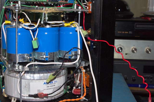

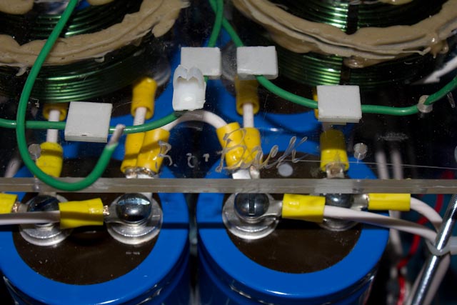

An IMPORTANT! finding , connections to both inductors were lose . Already fixed.
JD. i did ask you to check inductor coils🙂 at the same time. make sure there is no short from the inductors to the caps. it seems they are very close.
Yes I know , about inductors-caps distance no worries there's 1" of separation but at the photo you see this short distance.JD. i did ask you to check inductor coils🙂 at the same time. make sure there is no short from the inductors to the caps. it seems they are very close.
