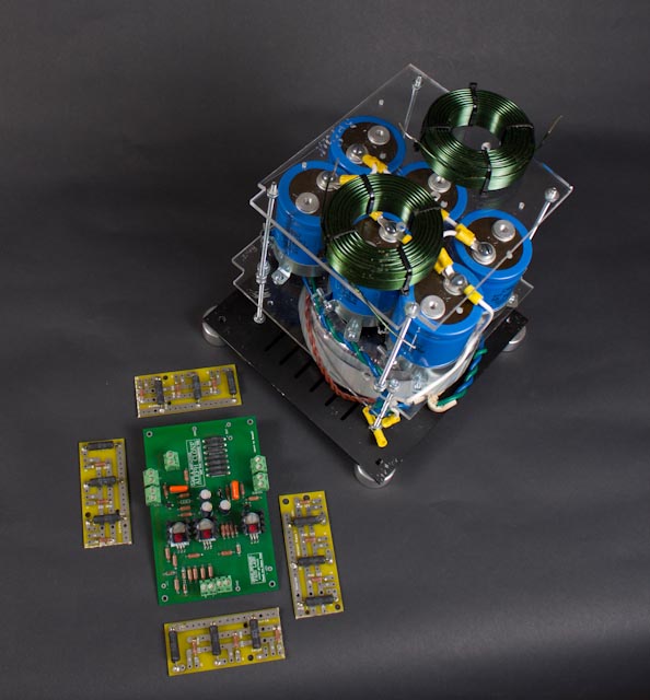

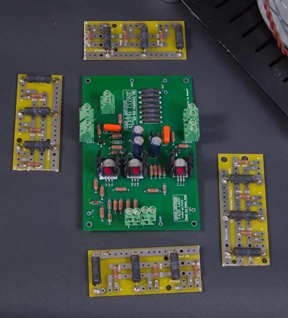

My Dream Aleph 2 Coming True

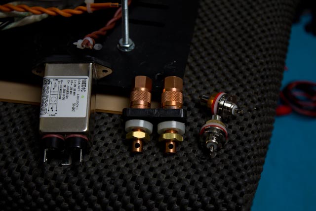

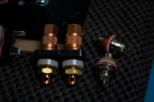

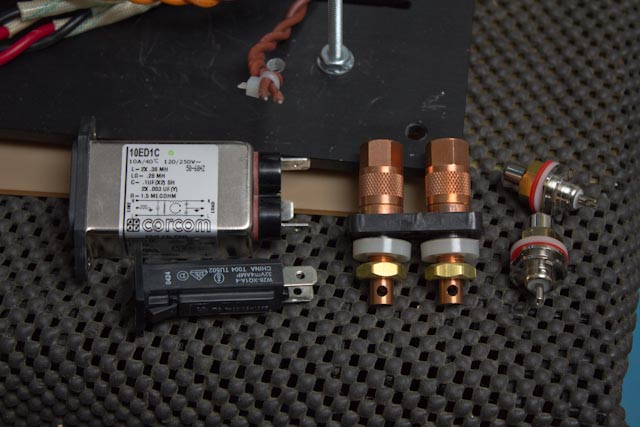

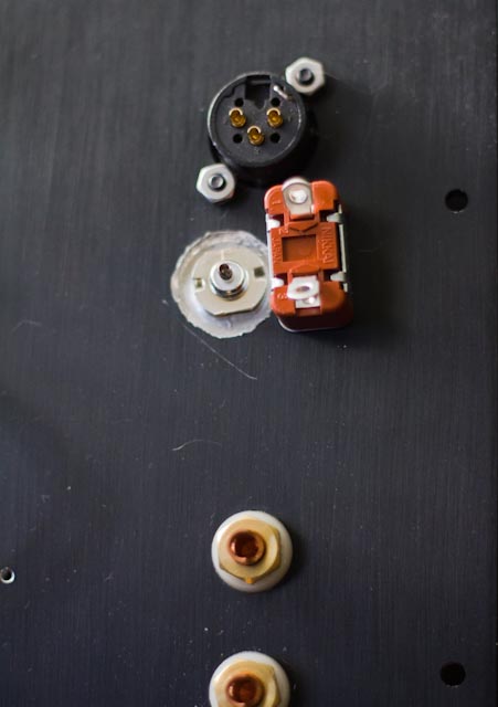

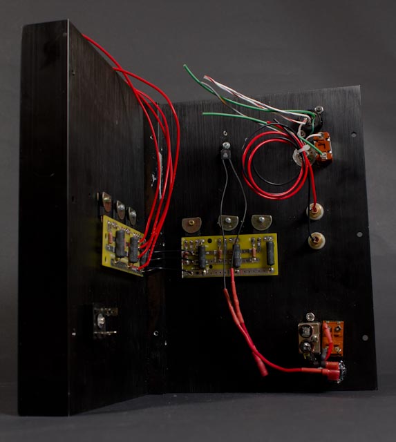

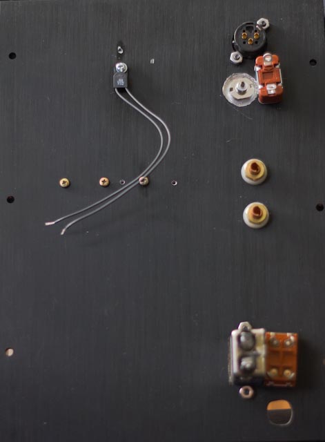

More chassis photo parts, here we have the speakers connectors, power inlet and line input, for the connectors I had to split them because the connectors holes on the chassis does not fit them, and for the line input had to modified the chassis input line hole (chassis to thick, cardas input to short.)

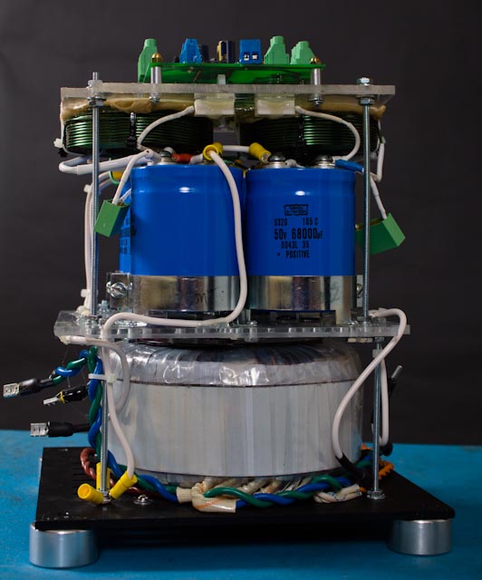

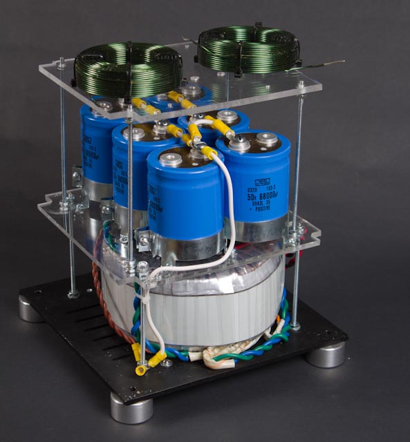

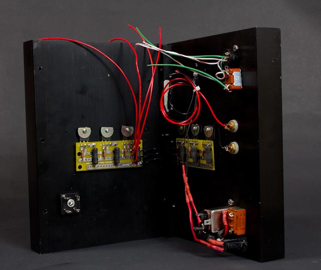

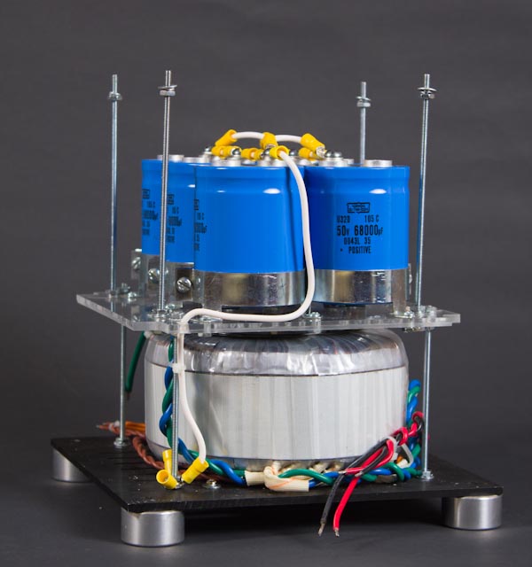

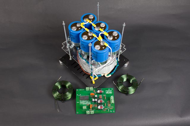

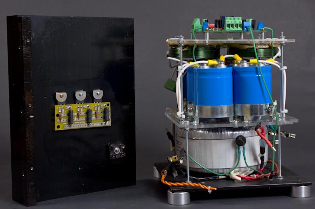

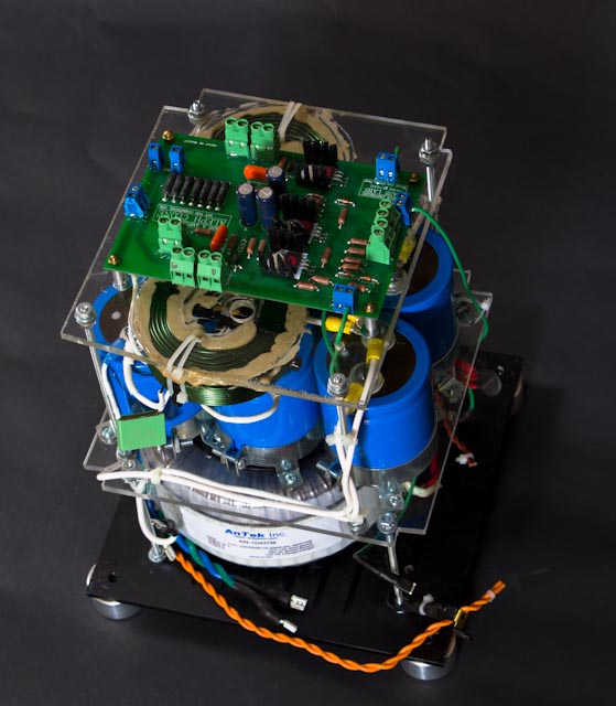

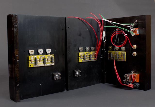

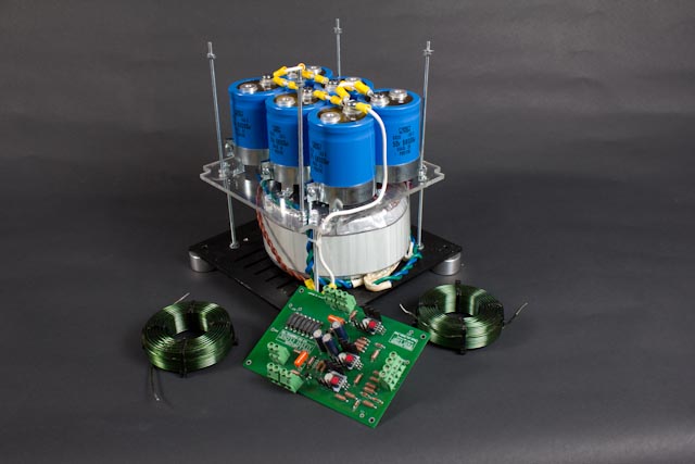

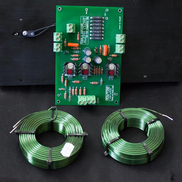

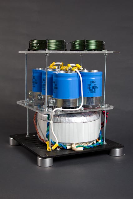

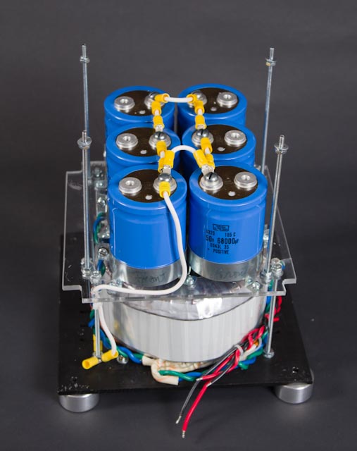

Thanks Drazen, case is 9.5" x 9.5" x 9.5" outside and 1" less inside. Have to planning very well for the big components fit inside the case without touch the output boards, my big concern right now is the power inlet is touching a little bit the transformer and the front panel is it touching the capacitors bank but I can solve this, moving the output board higher in the front panel heatsink. Here is the back heatsink panel with and without mod. The case is 5.6(0.221)mm/inc thick and cardas input was to short._MG_2586.jpg
This project has to be well thought out , because case inside too narrow and components too big, then we have to apply carpenter's law measure twice, cut once.😀

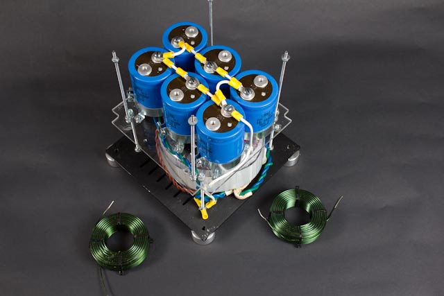

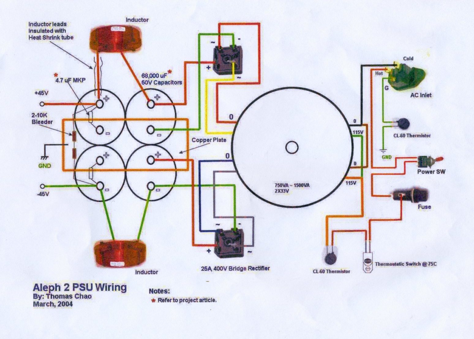

To be sure
I've used quite a few Anteks. For 115V operation, connect red together and black together on the primaries.
Lately I have found the Anteks secondaries are not very well balanced, dual bridges are a necessity to keep them quiet.
Thanks Bill, but to be 100 % sure, when you say red together and black together, is red-red wires together to hot and black-black wires together to cold-neutral part of the inlet power. thanks in advance.
