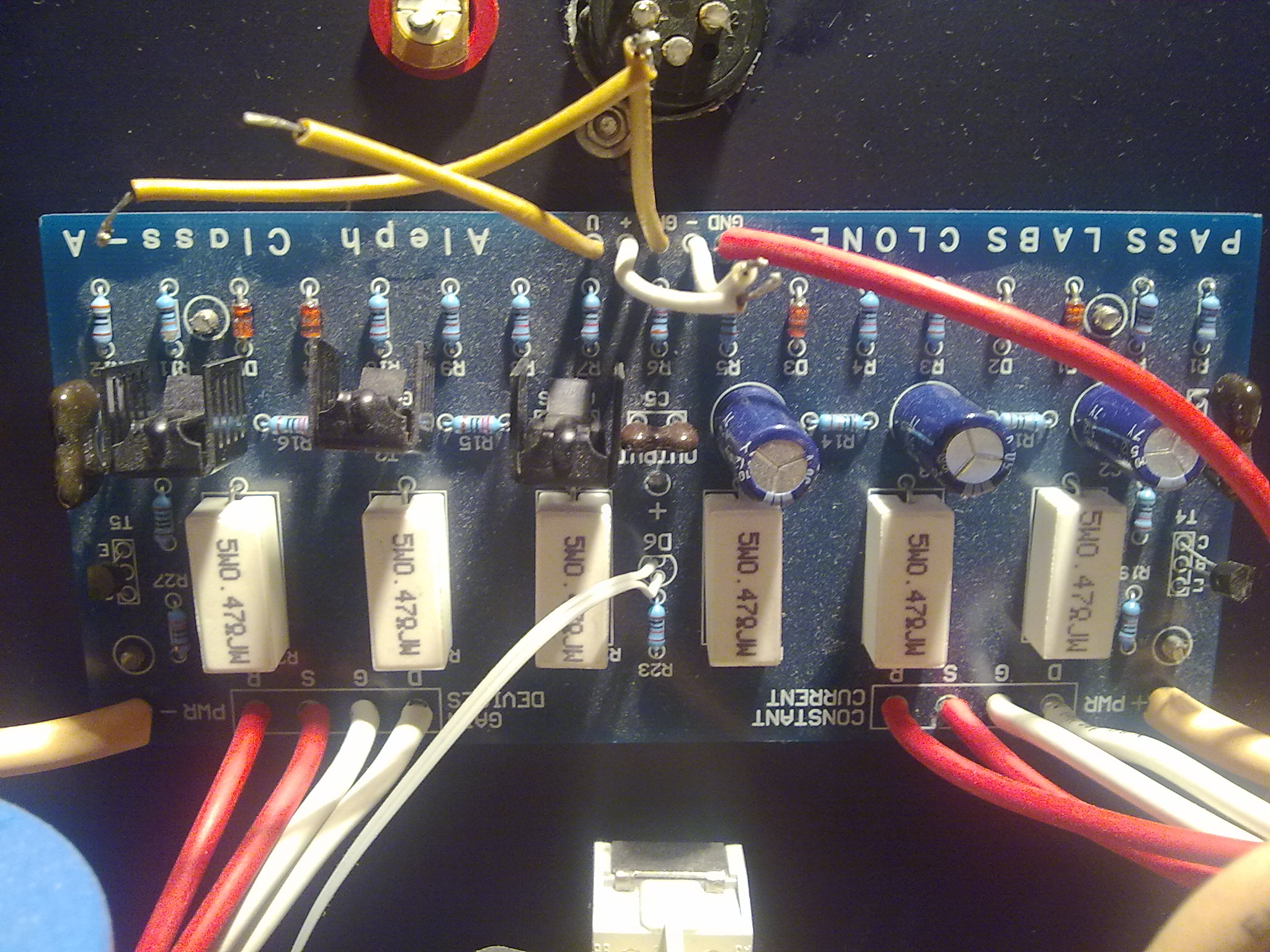

sakellogg which 220om resistor you mean?can you tell me the R... in the pcb?

Here are the notes that I have taken so far, correct me if I'm wrong:
1) Start with powersupply unhooked.
Slowly bring up to full value makeing sure it is stable.
Please post the Vdc from + to G and then - to G and then + to -
Unless someone has a better idea, I would like to start at the begining
Answer: I did this, I will do it again, but I believe my values are +50.1 - 0 -50.1V
2) Unhook the big mosfets from the main board and read the voltage drop across the mpsa,s C and E and post voltage
Question: Do I need to put the variac at full 110V?
I will also check to make sure my MPA;s are installed withe the flat side to the inside of the board (according to the photo).
3) Check the voltage drop across the 221 ohm res feeding the drain of the ccs 4 the irf9610.
Question: Do I need to put heatsinks on the IRF's as shown on the photo from karajak?
maybe double check it, just in case. who knows coulda got fried when you tryed it before.
i mean unhook the 4 wires from the main board to fet boards. proably best to do it at the main board. dont unsolder all the fets sorry.
slowly work up to it with your meter reading the power supply.
then hook up to the main board and do the same.
ok, thats good, but thats not the thing we are looking for.
somtimes boards are misslabled. i just want to rule that out. you want to make sure the 18 is in the cir right.
need to......no.
you have three mosfets in the front end.
1 is a constant current for the other 2.
it allows a set amount of current to be passed for the other two no matter what.
it gets hotter than the differrental pair, they dont get as hot beucase they share the current from the first. they have half the current.
but fets change their paramters with temp. and since you go to all the effort to match the diff pair its a good idea to put them together thermaly, you dont want 1 to be 50deg and have a Votage potental from gate to soarce of 1v and have the other at 51deg with a Vgs of 1.5vdc....
so, no dont need to. here is what i did diff pair on a short peice of 1/2" by 3/4" al bar stock keeping them ele isolated. and put a small sink on the ccs cause i wanted to keep it cool.
your call isnt going to hurt either way.
