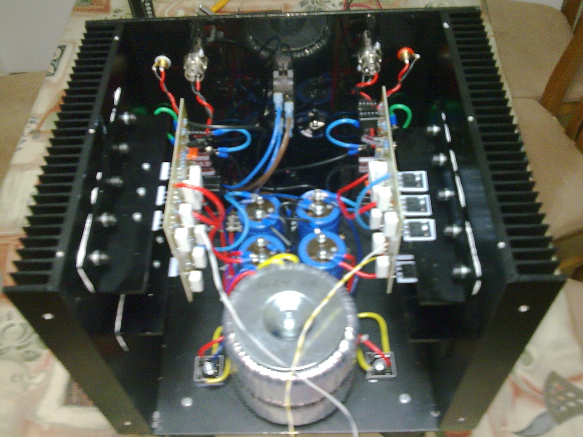

When I first checked my amp for a few seconds I measured normal dc ofset(20mV).Then ,disaster! dc at speaker terminals,blown 1ohm resistors on constant current pcb .After turning of I checked everything .Found several irfp 240 fried.I finished the second channel with extreme acuracy in respect to follow instructions.I turned it on using light bulbs for protection.the bulbs indicated false. I guess variac is a choice in order to take measurements.
I am using the same KK boards .It was about 20 seconds when dc apeard at spkr terminals. The case is based on FISHER heatshinks.I bought them a few years ago.EXPENSIVE! I could afford them back then.
Its my first project with these boards.Previous attempts with finiss boards were an absolut sucess story.I am deeply dissapointed.

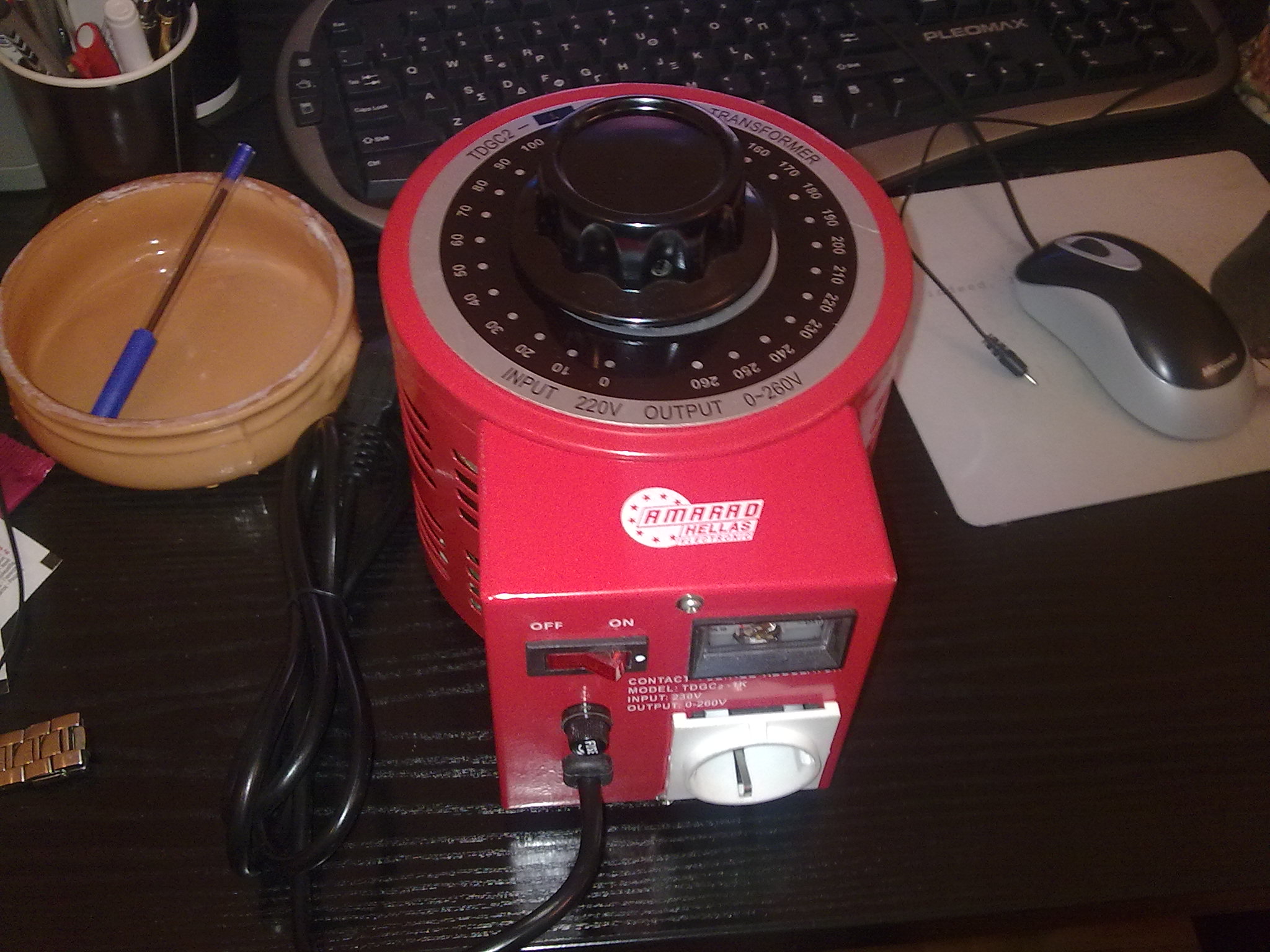

Karajak, we will figure it out, no worries. My wife and I are planning a vacation to Greece, I am certain by that time you will have your aleph2's working by then. Just hang in there with me!
I ordered a variac, hopefully it will be here before the weekend, maybe later.
