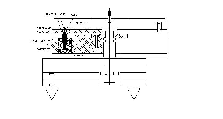

Platter material
Thought of MDF too, but a lot of people think it's too 'dead' for that purpose. Dampens the liveliness of the music.
I was quite happy with my constraint layer sandwich platter untill one day, being heavily affected by tweaking virus, I decided to pull the middle sorbothane layer out. Now I know what exactly "sucking the life from the music" means. With the soft layer in place, the color richness of the sound (primarily accoustical instruments and voices) was lost. I was foolished by the fact, that the high and low extremes were affected much less.
But those subtle higher and lower harmonics (overtones), wich give the instrument its characteristic sound signature, were supressed.
Note, that the upper layer was directly coupled to subplatter, so no compliant material was introduced into vibration path (see the sketch below). CLD principle was implemented in purpose to kill "resudal" vibrations, aside of the main vibration path. So, I came to conclusion:
1. The platter material and its damping/vibration proterties are absolutely critical for good sound.
2. No compliant materials ("heavy absorbers") shall be placed invicinity of cartrige.
3. I must give the hardwood platter a try.:)
