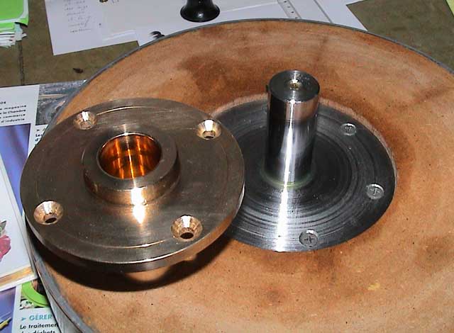

DIY turntable
Hi, where did you get this beautiful platter bearing and how much
would it cost?
