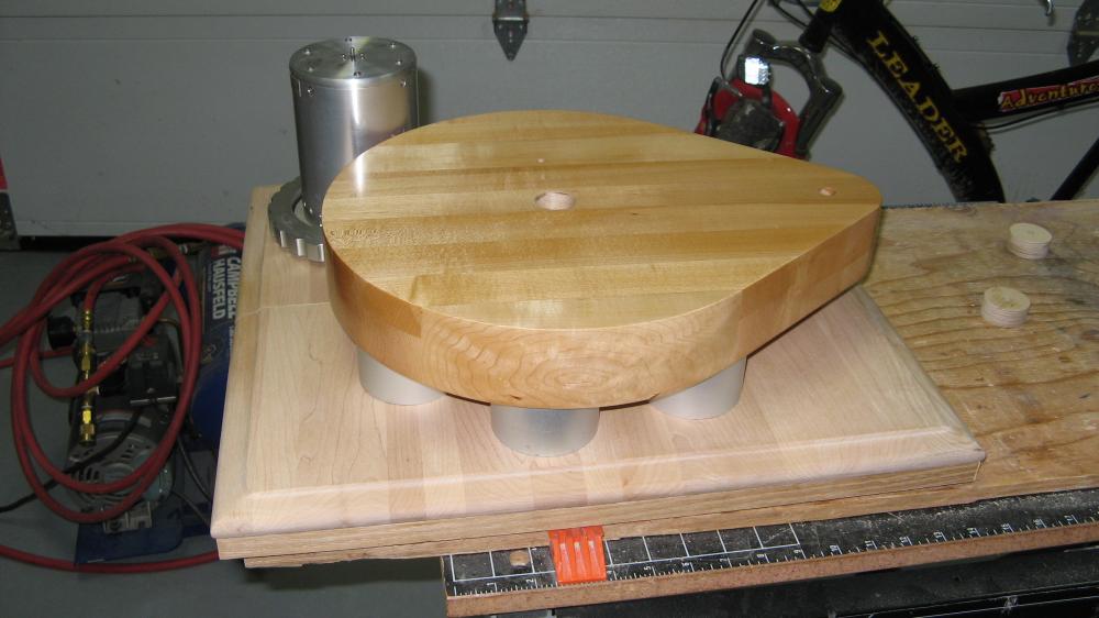

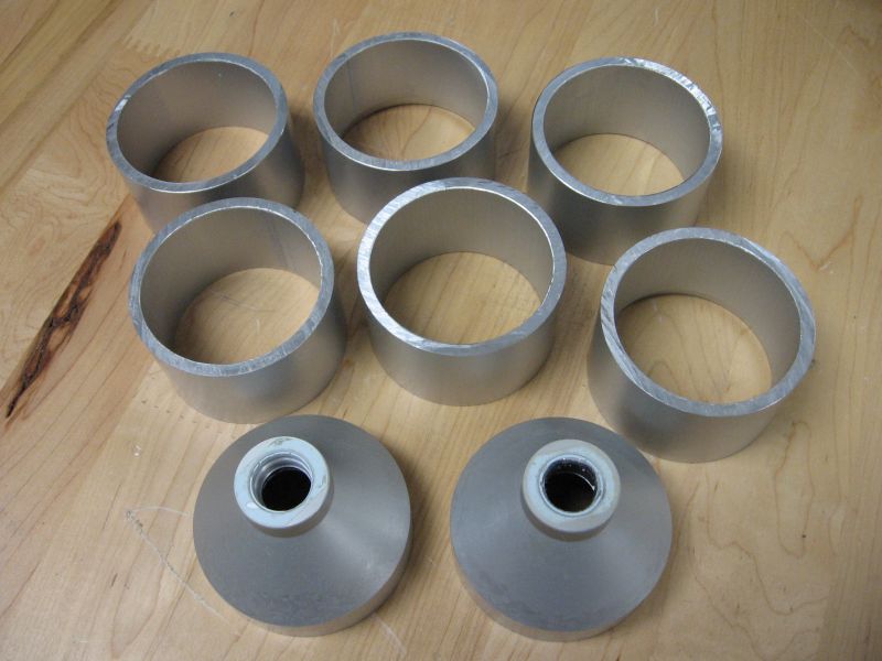

The platform riser material. As you can see, I have two pieces of different shape, just the left over of the aluminum case I cut in pieces.

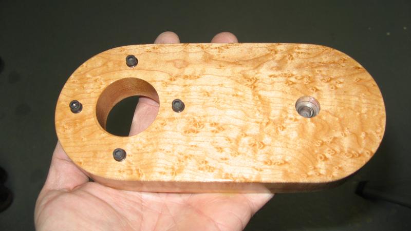

To have enough risers, I need to use them as well. I'll place one up side down under the armboard, the other behind the table. The one under the armboard will give a special look. It is a feature. 🙂
The top smaller section will be inserted into a hole of the exact diameter into the base plate.

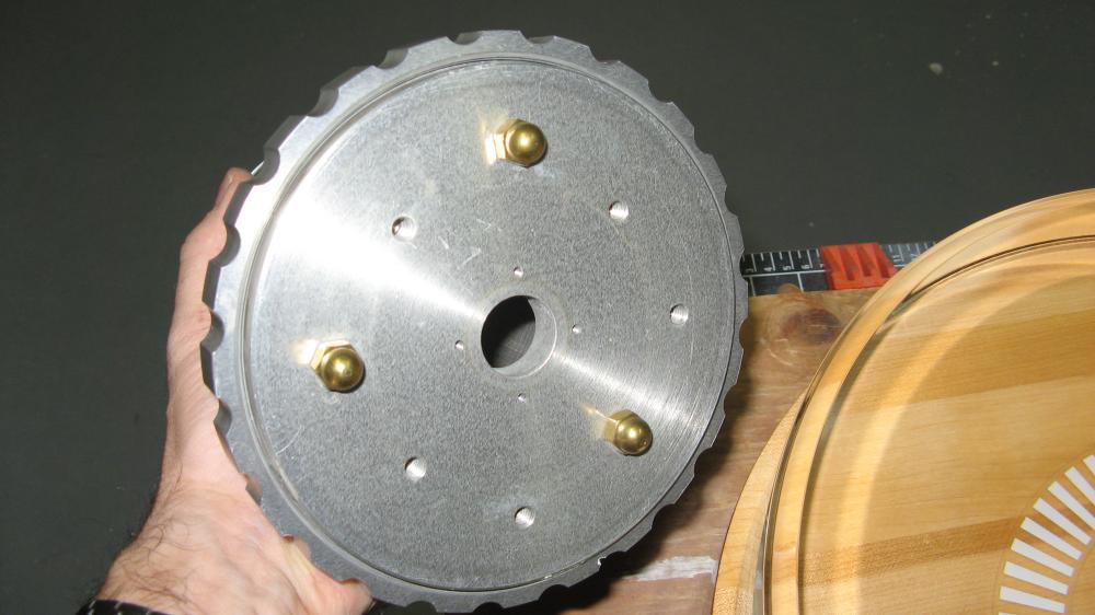

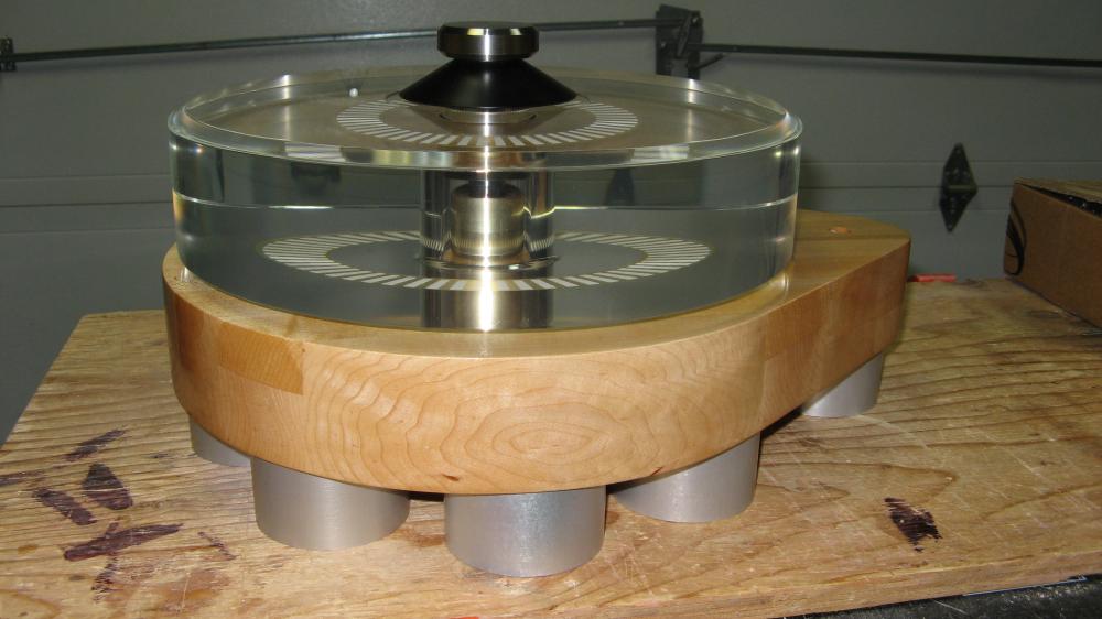

Here are some pics of the TT with and without platter in place. I also have an original Teres platter from a model 265. The one shown here is my own version. Its made of a composite of plywood, MDF and a big steel flywheel. Its also damped with lead shot and has about an inch of cocobolo at the top. Excuse the dust (one of the issues with black) and the smudges - I've been doing some maintenance on it and it al needs a good clean down:
(you can just see the side of the shigaclone in the pics!)
Fran
Fran
Thanks - but really the only thing I have more than you is both wood and metal lathes - and these really are handy things to have. I would only love to also have a milling machine though!!
I made a jig to hold the platter for turning - fairly simple but yes, you would need a lathe capable of swinging 15 or 16". Isnt that cocobolo a simply beautiful timber? I know it fades over time (as will all wood) but here, freshly sanded and oiled, ain't it just gorgeous?

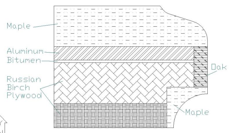

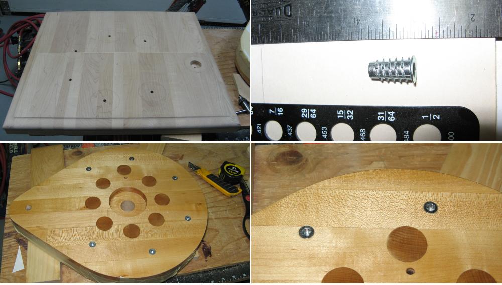

My platform is completed, I'm varnishing it right now. Well, it end up been much more complex than expected. I ended up with a constrained layers of 3/4 maple, then a plate of 1/4" aluminum for strength and weight loading. This plate is screwed into the maple using 14 wood screws and glued using "No Nail" Lepage universal adhesive. Then a small layer of loaded bitumen, sandwiched with a layer of 3/4" Russian birch plywood. The plywood is screwed into the aluminum plate using 14 hex head stainless steel bolts, drilled into taped aluminum plate holes. Finally, there is a final layer of 1/2" birch plywood again to cover all these holes. It is glued to the previous layer using wood glue. To cover all these layers from the side view, there is a 3/4" insert of oak, then a 3/4" maple groove for a nice finish.
The end result is a very strong, rigid and heavy platform, a perfect base to mount the turntable, its risers and the motor pod. The multi constrained layers of different materials should iprovide some vibration control/absorption as well.
The plate is drilled from side to side with the turntable upcoming platform risers. The turntable, the risers then the platform will be all screw together using 4-1/2", 1/4" bolts to produce a complete assembly. It took me two days to build
it.
The bottom plywood layer has metal inserts to receive 1/4-20 bolts or screws feet or cones, such as the Diamond cones I bought for this table. They will also allow table leveling. Pictures are coming, in the meantime here a cross section of the platform.

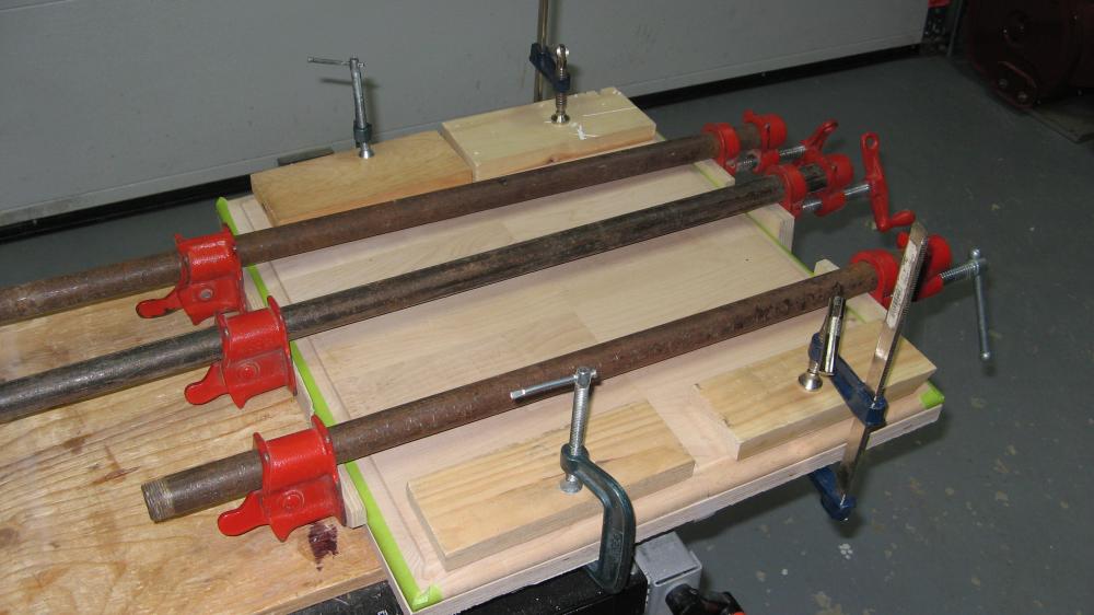

I recycled nice furniture top wood panels from my father in-law longtime gone production as the top layer. They were too small, but I glued two panels back to back.

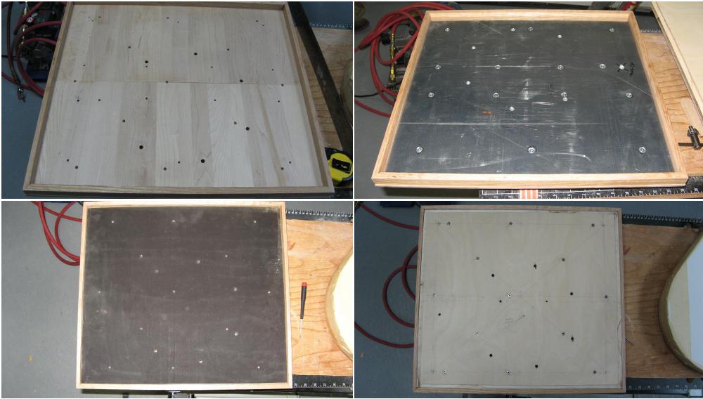

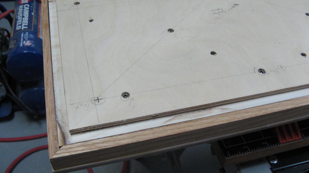

I first made my ACAD drawing to make sure the top platform would be big enough, it was, then I glued the two panel together. This is the test setup. I printed out a drawing to scale of the risers position. I used it to position them on the platform. I fine tuned the position of two of them to allow enough free space for the my motor pod base ring.
The oak 3/4" trimming bar is already fixed to top on this picture
Once the risers were correctly positioned, I drilled the 1/4" holes for the big bolts, marking the turntable base at the same time insuring correct alignment. I inserted solid bolt threaded insert into the turntable to receive the platform bolts.
From the left to right in clockwise direction, first, the back of the top layer. It has a lot of pre-drilled holes. then the second layer, the 1/4" aluminum sheet, glued and screwed in place. Third the bitumen layer, then the fourth layer, the 3/4" Russian Birch Plywood.
