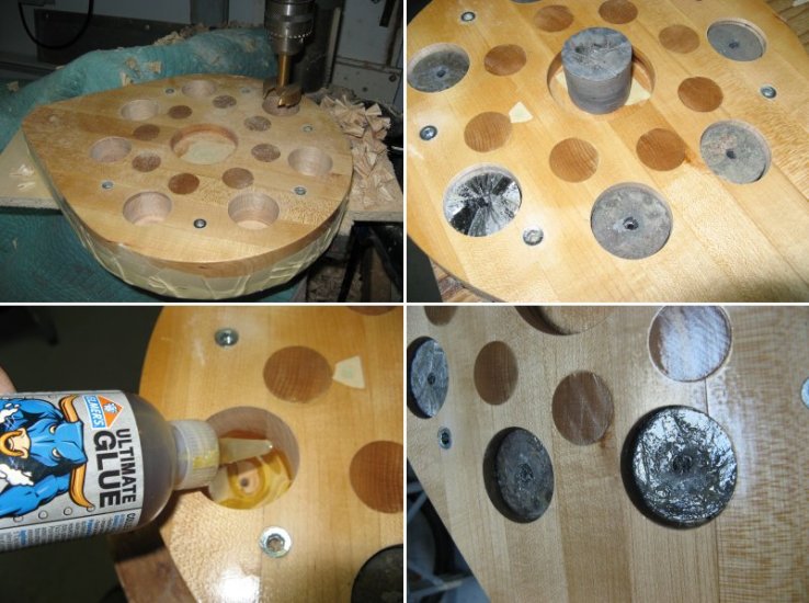

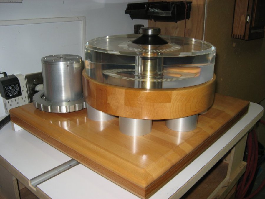

Stay tuned for more pictures. I worked on the table base this past weekend. I added some more lead as suggested by some member. I installed 7 weights of 600gr each, for a big total of 4.2Kg of lead (or 9.25Lbs). Now the base fell very dense indeed 🙂

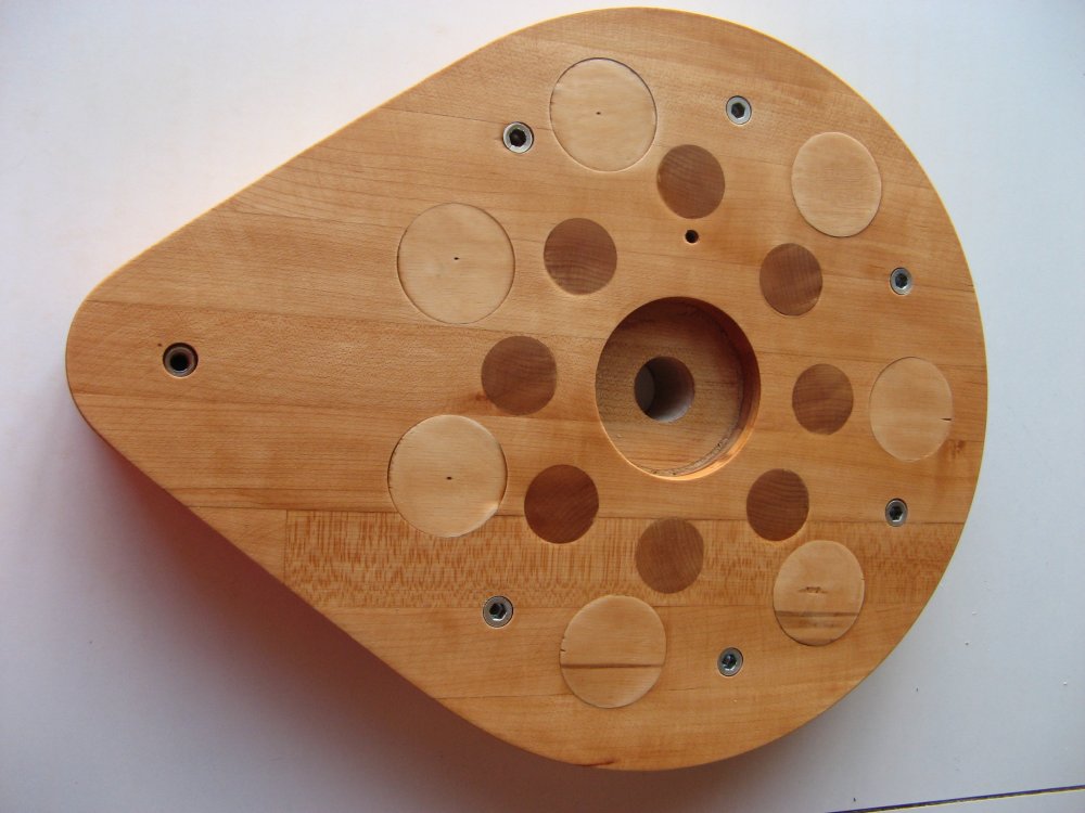

This is step by step the addition of some more lead to the turntable table. I dig 7 new holes into the table. Harder to do this time with such a big drill bit. I had prepared since a long time these lead weights, 600gr each. They fit perfectly into the holes. Then I pour some polyurethane glue into it. This glue expands and fill all the void around the lead weight. It makes sure than these heavy weights won't drop from the table, or move into the hole. The final result on the last picture. Seven lead weights, solidly glued into the table base awaiting the wood cap.
After adding the new weights, what is the total weight of the plinth? Your project looks like it's coming along very nicely!
Total weight before the latest addition was 4.3Kg + 4.2kg of addition = 8.5Kg total + the risers + the base plate...

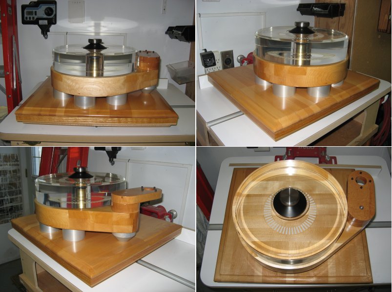

Here the final result. Caps are made of slice of birch plywood. I redid the varnish on bottom for an uniform finish. You can see very well the bolt inserts for the risers.

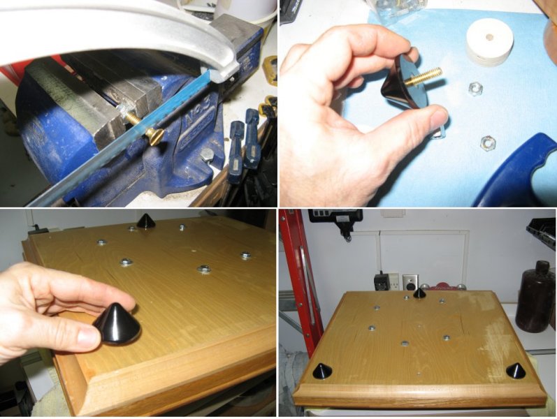

Final touch, the platform bottom feet, Black Diamond Racing Cone installation (see http://www.vxm.com/21R.14.html).
First I cut brass screw to get just a 1/4-20 threaded rod that I screwed into the cone using removable locking thread fluid.
The three cones can be mounted at seven different locations into the plinth using the steel threaded inserts that were installed into it (there is one in the middle as well).

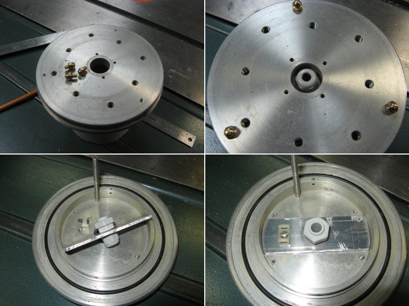

Making of the Motor Pod. Images top to bottom, left to right.
1) First build the three adjustable brass feet and drill/Tap the pod base to receive them. We can see there is a hole to plug in the Pod base. I'll use it to run the motor cable.
2) Closer view of the cable strain relief connector and the brass feet installed.
3) Showing the parts used to plug the hole and hold in place the cable strain relief conn.
4) Parts installed, ready for the next step.

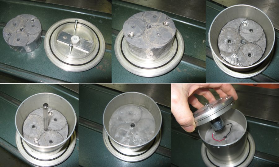

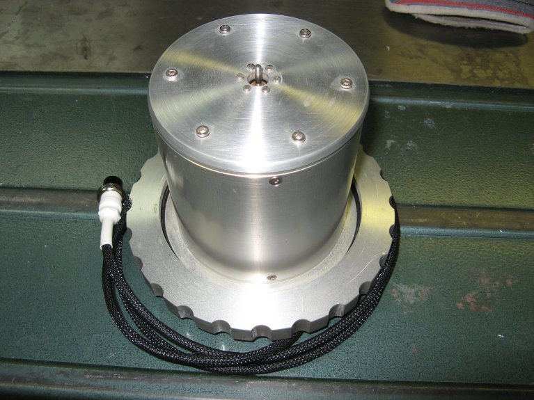

Lead loading installation. Again images clockwise left to right.
1) Drill/Tap to install the two SS screws used to hold the lead weight. The weight was prepared to fit into the Pod tube and leave enough clearance for the motor.
2) Lead weight held firmly in place using the two screw. A bigger hole in the middle was drilled to receive the cable.
3) Weight and Pod tube installed. I forgot to mentioned that the tube was first cut to length so the motor pulley will be in the middle of the platter.
4) Preparation to receive the paraffin wax. A pen is used to plug the center cable hole.
5) Paraffin was poured inside to seal the lead. Center hole is left open.
6) The motor cable is run inside the pod from the bottom and soldered to the motor.
Final Pod weight 4.2Kg. It won't move around.
