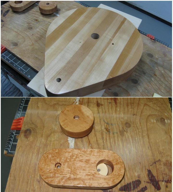

My wood base, see page 2 for picture, cost me only 60$. I have it made by a local wood craftsman. He likes to do custom, special jobs. He used dried maple used to build cast mold, from an other small shop next his door. It is laminated and built custom for me according to my ACAD drawing.The finish is just perfect, ready for lacquer or varnish.

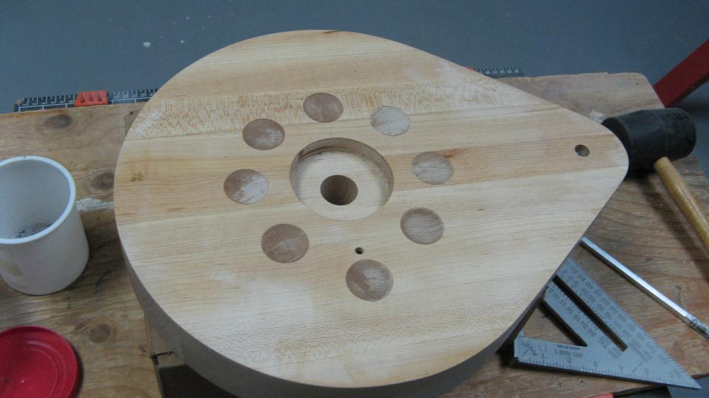

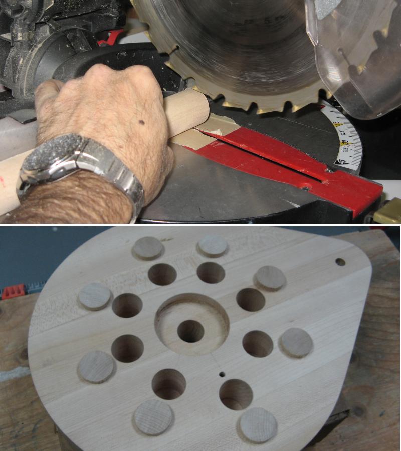

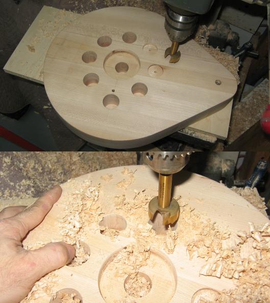

Resuming work on my Teres. As suggested by some other members, I added lead to the wood case. To so so, I drilled eight 1-1/4" diameter holes into the base, around the bearing mounting hole. I choose this hole size because I have a wood rod of this exact diameter in stock. The drill bit am using is working like a charm into the dry maple, but make a loot of chips...
Wood base starting weight was 3.73Kg

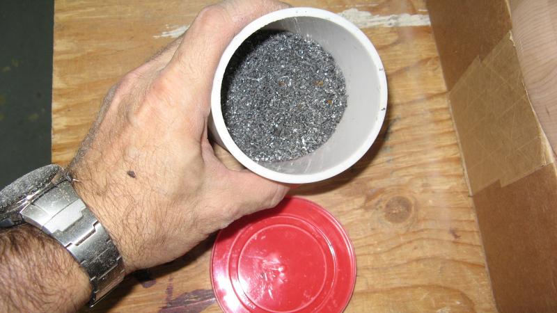

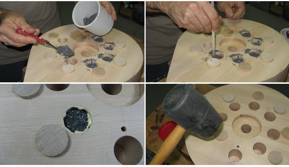

This I filled each hole with lead chips that I produce cutting lead weight in small pieces. At first, I was planning to insert lead cylinder, but some members mentionned that lead beads or chips would probably be more effective that a solid piece. Here some of the lead chips I'm using.
Hence the final result. Final weight with lead installed is 4.37Kg, or 0.64Kg of lead. Weight addition was suggested to be between 10% to 20% of the original weight. I added 17%. All good 😎
If you look closely, you'll see a small hole near one of the lead plug. This hole will be use to install a blue led that will illuminate the platter stroboscopic mark (used originally by the Teres speed controller). I'm planning to build small crystal oscillator with the correct frequencies to match the strobe marks and the two speeds 33-1/4 and 45 rpm. Then I can use the stobe marks as a speed indicator since my controller is purely analog.

Thanks for the update,your project looks great,nice job.I got the same drill bit kit.It is the Mastercraft Maximum Forstner drill bit kit from Canadian Tire.Please follow with more pictures after the stain and varnish is done.
