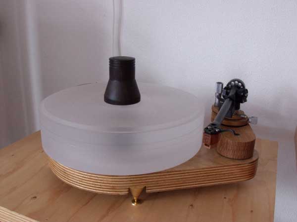

My version :
http://www.vinylengine.com/phpBB2/album_pic.php?pic_id=4136
Platter is from Scheu , European counterpart of Teres , string driven by Maxon DC-motor. Tonearm is a heavily modified Rega RB300 with a Grado Platinum Wood.
Plinth is birch plywood with lead-shot fillings.
Bouquet
Bouquet

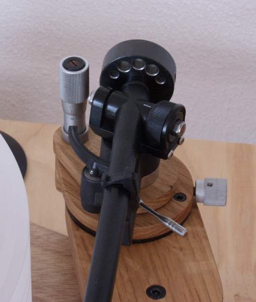

And the modified RB300
The adjustment on the left is for lowering the armpivot , so adjusting VTA , the grabs-crew on the right to lock the arm in place.
The downforce spring is removed , it's adjusted now with the counterweight.
This counterweight is replaced now with a wooden one ( african blackwood ) with lead inserts to dampen resonances.
It does make a noticable difference in the favor of the wooden counterweight.
Bouquet
Bouquet
