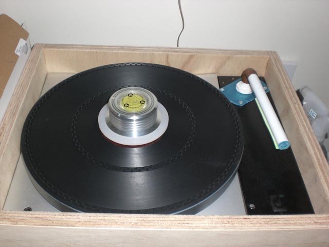

I've no idea how to attach more then one photo at a time, so here's the external, which as you can see is simply a gutted TD150 (bought like that from eBay for less then £5, I could never be so cruel to a Thorens)
I made an 'SME' plate out of some thick hard plastic with a Dremmel to fit the cutout on the armboard, the connector is for plastic wiring conduit (it fitted the pipes I was using)
The wand is plastic central heating pipe with a slot cut in it, shaved flat underneath and two 'ribbons' of microfibre duster glued either side of the slot. (I'm trying actual nylon velvet ribbon on some spare tubes I'm making next)
I've considered playing with motor drive but am basically happy with my manual system of an 'alchemist' record stablizer thingy (again off eBay, I didn't like the effect on my record deck, but it works perfectly for this) with some thick 'sticky' rubber glued to the bottom for better grip and to protect the label.
The whole is put in a WAY oversized box made of ofcuts of ply

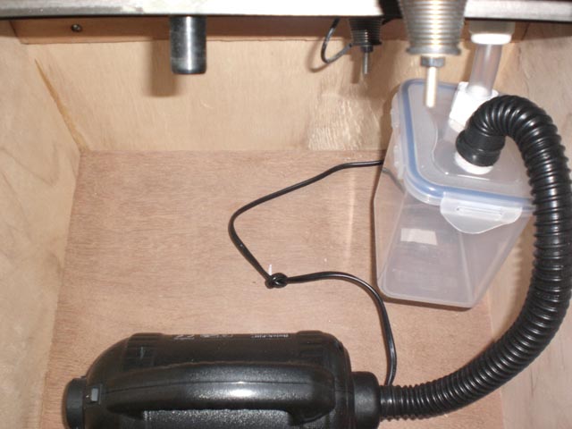

This is the inside, as you can see dead simple, from the intex air pump the pipe goes to an airtight food container and from there connects directly to the connector on the 'SME' plate above holding the wand. Again the connectors are for plastic wiring conduit.
It's not wildly convenient having to lift the deck to get at the container, but I figure it would take forever to get any significant amount of fluid in it anyway, gunge, now thats another matter..
Works incredibly well and cost way under £30, thats got to be a bargain!:cool:
One day I'll get around to giving it a nice coat of varnish, but right now I'm just enjoying finally having clean records
