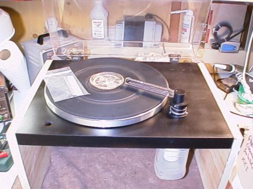

I picked up the TT and the VPI parts arrived the next day.
I realized looking at the turntable plinth that with some modification it would be ideal for the top board of the cleaner.
I removed the motor, and the arm assembly. Filled the hole with a piece of foam insulation cut to fit, filled the space flush to the surface of the plinth with bondo, allowed to cure. Added some additional filler and smoothed it out. One more application and a little sanding and no one will ever know there was a hole there.
I plan to paint the whole thing once that is done.
Tomorrow I will pick up an Intex pump like the one shown elsewhere in the thread as a vacuum source.
The original TT bearing can be modified to allow the installation of a coupler and gear motor so it will definitely get one soon.

As promised here as some pix of my RCM project. Turned out quite well, although I was not able to score the Intex pump I had planned on. The one I got works well and was easy to mount..

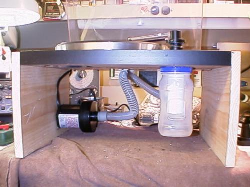

I have a homebrew slop bottle just under the VPI suction tube and assembly - I really didn't want to suck solution through that air pump. The pump has a couple of minor mods to increase suction which consist of removing the guards from the inlet and outlet ports.
I will eventually modify the bearing assembly to allow me to connect a gear motor via a shaft coupling, but for now it will be a manual affair.
I reused the plinth from the candidate table after filling the arm hole. I did this by cutting a small piece of foam insulation to fit, then mixed up some bondo which I used to fill the cavity.. To smooth things out subsequently I used a little filler compound. I probably should have done this a couple more times, and sanded even more than I did, but overall it looks acceptable.
I also reused the original cover to provide protection when not in use.

Here is a picture of the bottom of the RCM as I was not able to attach more than one picture to the previous posting.
The slop bottle is an old Dole Fruit Salad bottle that I thought might be useful someday.. The tube is just a piece of thinwall plastic drain pipe that I cut to size. The suction port to the pump is tapped into the back side of the bottle above the bottom of the tube.
The hose is surplus medical air tubing (cpap) tubing from a hamfest.
The pump came from Target and is a 120V model made by Greatland. It is the kind that comes with nozzles, but no hose.

Kevin-
Nice 🙂. The "slop" bottle is a good addition, one that I would think is mandatory. I shudder to think of the things that would start to grow in a pump without one..not to mention hosing down the room in the vaporized effleunt.

Hi Casey,
My lousy camera mostly hides the hack job this thing really is compared to your standard of work.. 😀 The seemingly warped ends are due to pincushion type optical distortion in the camera lens - it's not real..
I threw it together very quickly, but it will come in very handy for cleaning my many filthy finds, not to mention some that have just collected too much dust over the years.

I even had fun doing it, mad rush that it was. Just wrapping up as many DIY loose ends as I can before I start my new job.. 😀 I've been quite busy in between job hunting activities.
Yeah, I cleaned about 5 records last night, and machine works quite well, and yes there is now more than a few mL of cleaning fluid in the catch bottle so I am glad that I added that feature to my cleaner.
Suction is quite good, but one change I would make would be to use a slightly larger gauge of tubing between the pump and the bottle to further reduce restrictions..
One other thing I would do is put the VPI suction tube a 1/4" closer to the platter such that it overlaps slightly onto the label otherwise a little fluid gets left behind in the lead out area of the disk.
I will be adding a gear motor drive fairly soon, turning by hand is a bit of a PITA actually, and for the coordination challenged turning the disk while scrubbing back and forth can be a bit of a challenge actually.. 😱 Something I had not anticipated..😀
The other thing I had not anticipated was the difficulty in finding a suitable spray bottle this time of year.. Three different stores that usually carry them, not one had any.. Dumping the fluid on the record directly from the bottle can be messy.. I am also glad that I used a water proof paint when I repainted the plinth as every things gets wet when cleaning a lot of records. Could it be I am just sloppy?😉
Bottom line: The thing works, and while it won't perform miracles on badly damaged records, it makes the rest sound a whole lot quieter.
