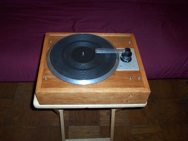

You have handled the mechanicals in an elegant manner, even the wood grains match! I think I recognize the Noguci (sp?) lamp, a great shadowless source.
The real upside to your set up is that it is attractive, therefore out and always available to use while the VPI et al were excuse the expression "butt ugly" and had to be hidden from view...explaining vinyl is hard enough! The price and the satisfaction of doing a project like this is inspiring.
My one little quibble is in your choice of brushes. The one that comes with the VPI is truly sensational, short bristled, micro fine so as to be able to get right down into the bottom of the groove and scrub the groove walls as the disk makes a few turns with quite a lot of fluid on the surface. Now I didn't see it at the link that has the vacumn tube but if it is available I think you'd find it a plus. The VPI also uses a screw down clamp with a porous sponge mat on the platter.
My question is what are you using for your cleaning solution. The VPI is a good but expensive product. Have you concocted a "home brew"? It would be a great next step for this project.

Yes, I agree with the brush, I just didn't want to spend the $40 for the VPI brush though. LOL
When I purchased the VPI suction kit, I went ahead and purchased the VPI cleaning solution. It was cheap and mixed up to 1 gallon.

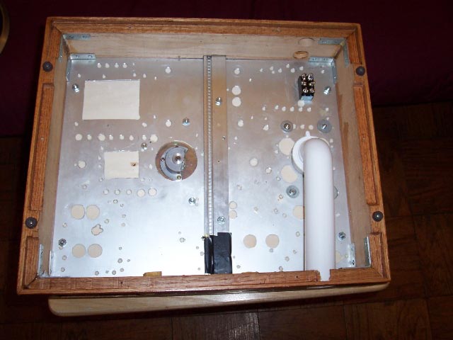

Anywho I digress. I am writing mainly of the brush I challenged mattjk on earlier in this thread. Attached you'll find two pics, they are brushes for the VPI cleaners. The one with the black handle is $29.00, the one with out handle is $9.00. Is there a differance? You tell me. They are from two differant model machines but they clean the same size record..Hmmm.

Mattjk I think you have a winner for the science fair project of the year, and if you don't win I'd demand a recount in Ohio!

That is fantastic work there. it looks so "clean".
one thing i would mention by the way though. that looks likea pretty cheap and flimsy piece of furniture 😀 can you put something thick/heavy/dense between that wood and the real turntable.

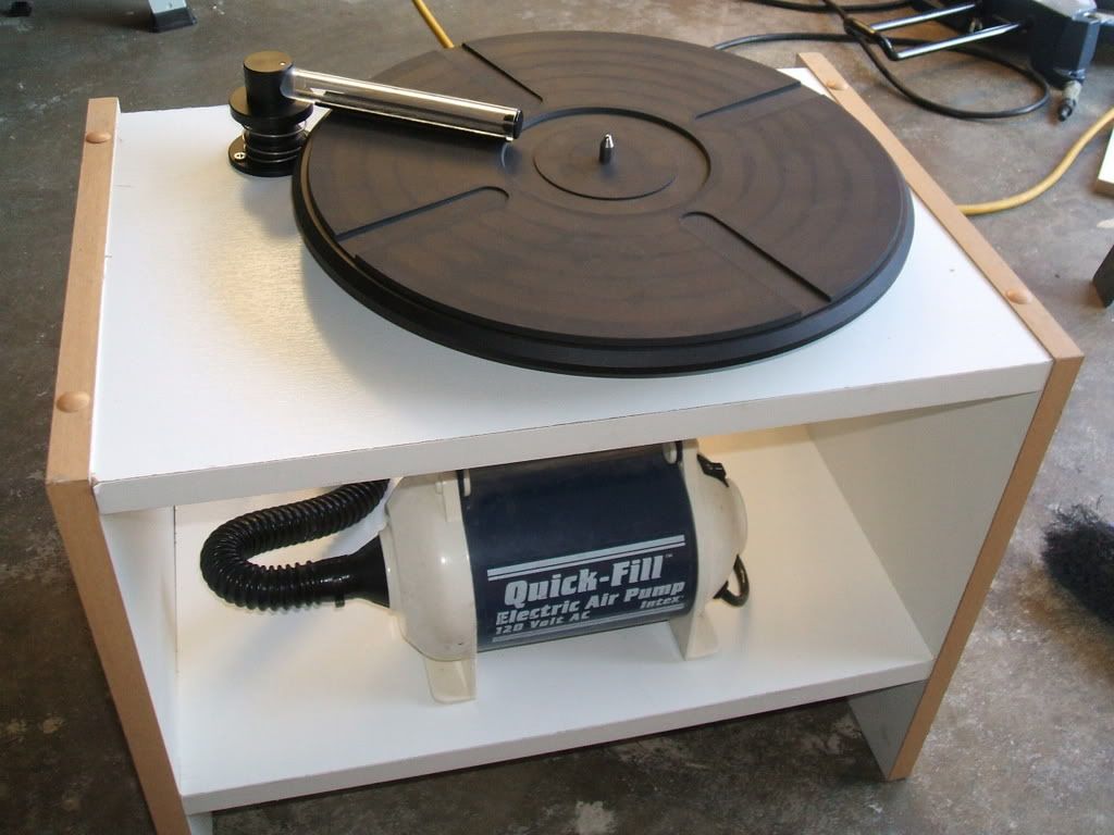

Finished my machine.
I've always been outraged at the prices of RCMs on the open market. These are not complex machines nor are they precision instruments.
So when I stumbled across this discussion thread, it aroused my curiosity.
Since then, I scoured the web for other designs but kept coming back to this one. Its simple, effective, and inexpensive.
So I finally built it in a single afternoon. Total cost including the VPI arm was $80. I required approximately three hours to build from scratch. I used a platter bearing and spindle from an NAD 5125 and just turn the platter by hand.
Thanks to everyone for all of the useful information.

Re: Finished my machine.
Great machine, where did you score the pump?
http://www.amazon.com/Volt-Quick-Fill-Electric-Pump-68626/dp/B00080RXNE
I want to get this small vacuum cleaner from a big box store too. Would this little pump generate lots of noise?
Just to make sure, cause I don't want to waken my grandma at the middle of the night while cleaning a dirty LP...
What are you using to catch the used washer fluid? I can't imagine that spewing liquid and vapor through the pump is good for it, and the solution might not be that good for me.. 😉
Real VPI machines used to have a jar to catch the liquid, and it would gradually fill up.
I'd use a small wet/dry shop vac or a trap (something from Fisher Scientific) with an air pump.
An air pump like this with a jar trap might be good..
http://www.amazon.com/Intex-110-120...99-6928804?ie=UTF8&m=A14X2WOLPJFQSS&s=generic
I'd expect any of these options to be noisy.. VPI machines are horrendously noisy - at least the 16 and 17 series stuff I've been exposed to.
