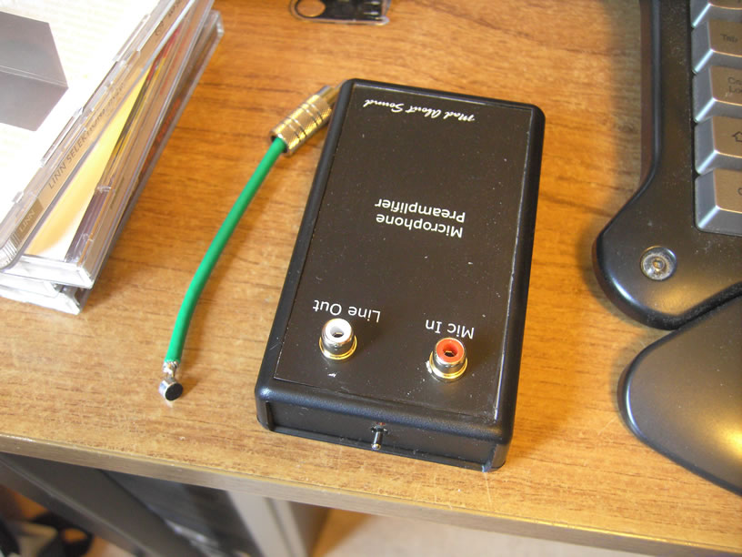

I finished building the mic preamp last night and cut a short length of coax, onto which I mounted the Panasonic electret capsule and an RCA plug on the other end.
I fired up ARTA and got something on the screen. I obviously need to sort out some calibration now to make it work better. It's picking up a lot of 50hz from somewhere. Will read the instructions and set it up better tonight... watch this space!

I reduced my 50hz pickup a little by shorting the unused input on the lead used to connect mic. pre-amp to sound card.

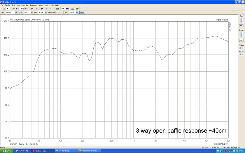

I fired off some measurements. This is the response of the right speaker, as designed by ear:

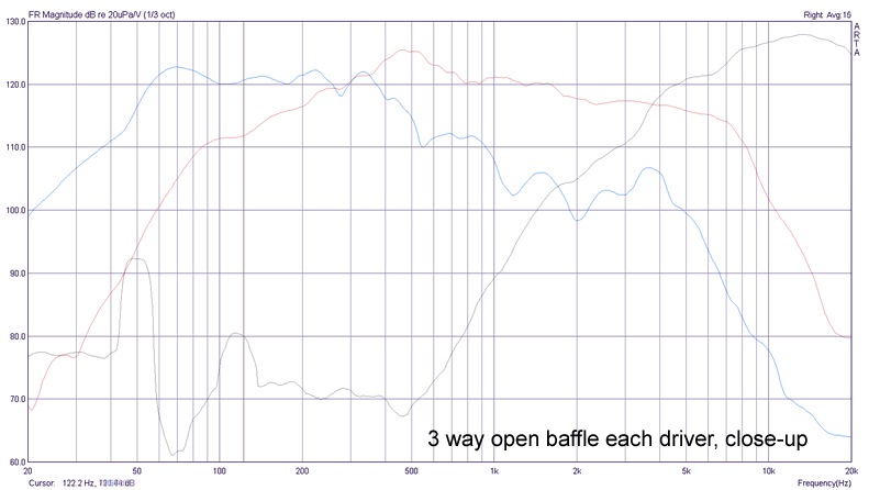

I think it's fairly ok to say it's all a bit of an experiment and learning experience. These are the individual drivers as measured using ARTA, mic close-up. I overlaid these in Fireworks. I'll learn how to use some proper speaker designing software in the future, but just doing this has helped enormously.
Clearly I made the treble far too loud, there's too much overlap from the woofers and there's a dipole-induced peak from the mid driver, centred at about 500hz.

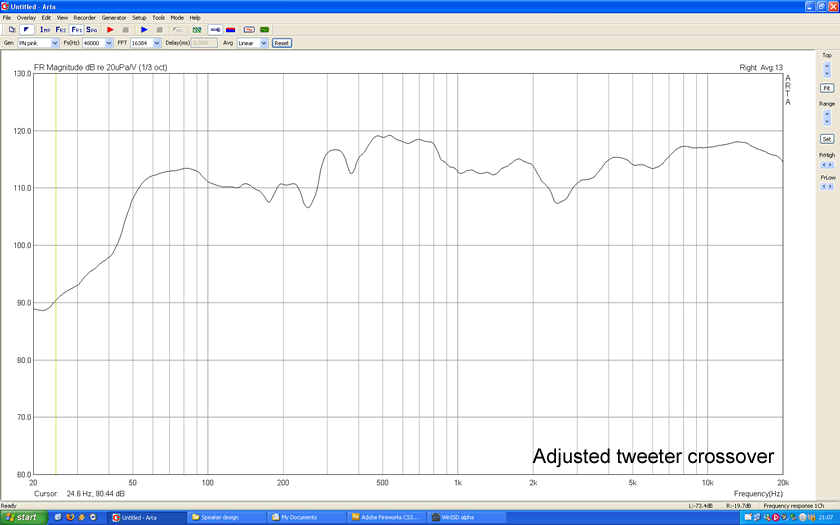

Based on this I decided to bring the tweeter in lower and reduce its level a lot (see attached). This sounded a lot better.

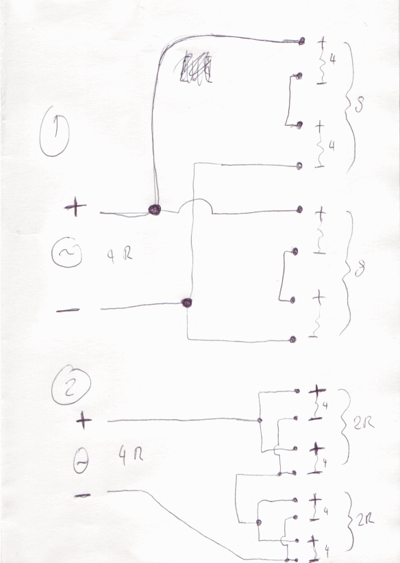

Hi Simon,

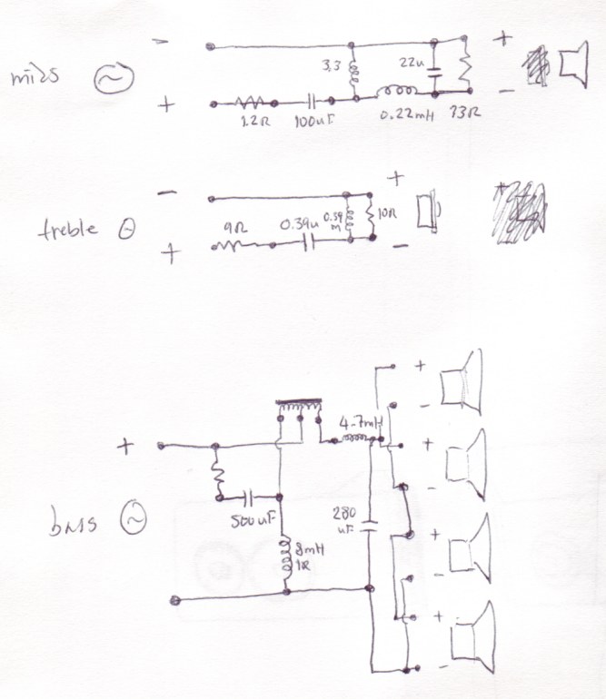

Looking at your last circuit diagram - you don't have any form of Zobel across the LF drivers. You could try 4.7 ohms in series with 10 to 100uF, also approx 10uF in parallel with the inductor you have in series with your LF drivers.
I don't know whether you are still using the same series/parallel arrangement, but I would have the two mid point interconnects joined together so that you have two drivers in parallel in series with two drivers in parallel, whereas you have two drivers in series in parallel with two more drivers in series.

Simon, it would be interesting to see a plot without the T-bass in circuit and just a conventional LC crossover, though of course the nature of the reproduction could not be represented.
Cheers ....... Graham.
Graham,
I've considered this but as a zobel is meant to go across each driver's terminals I'd need 8 x 10uF film caps! That's just prohibitively expensive..... or could I just "get away" with one zobel for the whole lot??
Still using the same series-parallel arrangement as I find it a hard to visualise. I've attempted to draw the setup and an alternative, see attached. Is this what you mean?
Re. 120hz peak - thanks for the suggestions. I've tried damping materials to no avail, but have yet to really raise it off the floor. I will try this.

I wired the bass drivers as seen as #2 in the previously attached pic. This didn't really make any audible difference but it certainly looks neater and I feel good about trying it.
