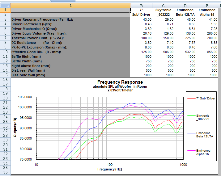

No problem at all Stuey, what you're talking about isn't even off-topic.
I had a long look at all the affordable 12" Eminence woofers and none are amazingly suitable for OB use... the closest was probably Beta 12LTA.
In the end I went and bought 4 x cheap 12" woofers (£15 each!), which have specs closer to ideal for OB use.
Here's the post showing the X-Baffle simulation for the 12LTA and 3 other woofers of interest to me:
http://www.diyaudio.com/forums/showthread.php?postid=1663404#post1663404

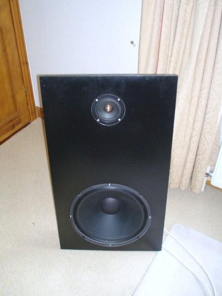

Hi everyone, it's been a while.
I'm still gathering parts and drawing up initial plans for my next speakers but these are still going strong and I've made a couple of changes since last posting.
I'm temporarily using larger transformers for the T-bass circuit, because they've been bought for the new project and I felt I should try them out. 500VA does sound better than 100VA but, I think, due to losses in the series coils the difference wasn't massive - just slightly louder, deeper, tighter bass.
I was running well over 2ohms worth of inductors in series with my woofers, which I've since swapped for a single <1R ferrite-core 8.2mH coil. The change was incredible, with much deeper, louder and quicker, more dynamic bass. It sounds less lazy (not that it sounded lazy before) and can really surprise sometimes. I still find there's a touch excessive upper bass, due to the room I believe. This is only noticeable on certain music, so it's fairly acceptable.
The next woofers have better OB specs and as simulated should have an extra couple of dBs in the low and mid-bass region and a dB or 2 less in the upper bass and lower midrange, which should help them sound more correct.
Simon
