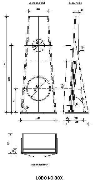

nice project Simon ....
i am playing with ob for some time now
and i really like the sound..
using 12 "Peerless SLS 12 and Fostex FE 167 E
here is a drawing (in cm!!)
I have the same fostex 167E on open baffle, I found the sound a little thin, overall sounds OK however if you have a better quality midrange driver the midrange would sound much fuller(I like fuller sound). On top of that it cannot handle power. For the price it is selling it is well worth it for the sound.
BTW I use an old alnico mid/woofer it sounds better than Fostex 167E
