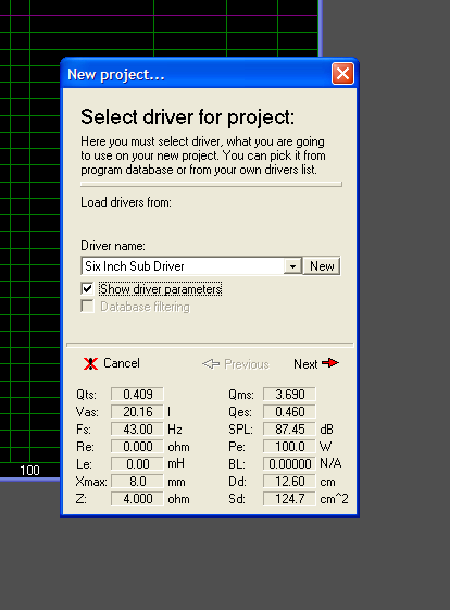

richie00boy said:Simon what Thiele-Small parameters did you get for those drivers?
Rich,
Here's from WINISD (Vikash kindly measured some of the drivers).
Simon

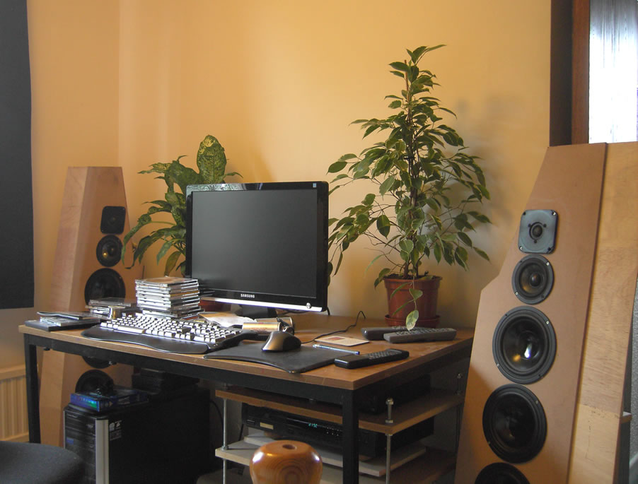

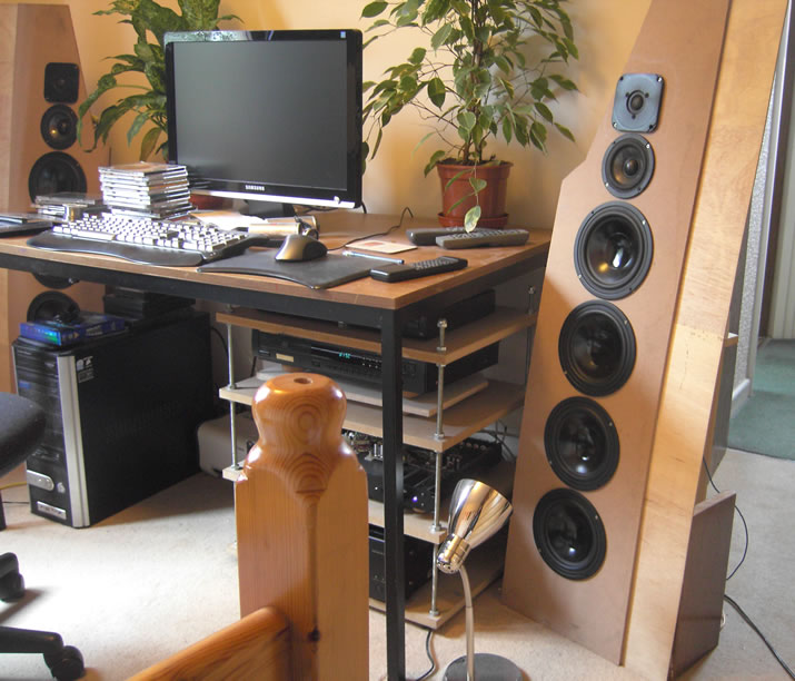

It's about time I built revision B, which will allow for the following changes:
* lower tweeter (and all drivers) by 5cm
* thicker baffle
* narrower baffle (~35cm rather than 40cm)
* side wings of 15cm
* possibly rebated tweeter
Here's another shot of the current ones.
Simon
* thicker baffle
Simon

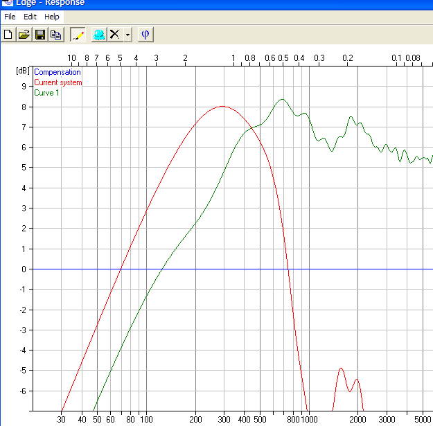

Can anyone help me design a passive notch filter to remove the dipole peak from the midrange response?
My corner cutaway should have reduced the peak substantially, and this is audible in the music, but I would like to see what happens if I reduce it further.
I can't find a calculator/tool for working out components anywhere.
Please see attached Edge simulation.
Simon

Ok I found this:
http://www.diyaudioandvideo.com/Calculator/ParallelNotch/
Should do the trick nicely. I've realised (through what Edge suggests and from how it sounds) that I'm losing some lower midrange. I might try crossing my woofers in a little higher.

Simon,
why don´t you optimse the response for your listening position? Simulating on axis for a mic distance of 100 m looks a bit odd ...
Thats obviously not where you are listening! 😉
You can move the mic to the side and change the distance too.
Another hint: Don´t make baffles wider than 3 times the cone diameter. That helps to avoid that peak too.
Rudolf
Rudolf
Rudulf,
Thanks for your suggestions, just in the nick of time! I was going to order parts for a notch filter I might not really need. I'd never really noticed the mic distance in Edge.
I'd much rather not put anything else in the signal path, it's already getting cluttered.
I'm now looking at putting the mid driver very close to the edge of the baffle, with cutaway, and trying a little compensation with a coil/resistor network to bring in the lower mid response... if necessary.

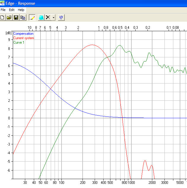

I've realised it's likely to work better without a notch filter, just having the mid very close to the edge of the baffle. The missing lower mids will have to come from the woofer array.
Curve one is the simulated mid response in Edge, nice and close to the edge of a cut-off 30cm wide baffle.
The red line is the woofer response on a 60cm baffle (30cm + 15cm wing each side).
The two need to meld together using 1st order slopes mainly, and bear in mind the woofer response is altered by T-bass, so shouldn't actually dip anything like the sim shows.
Simon
