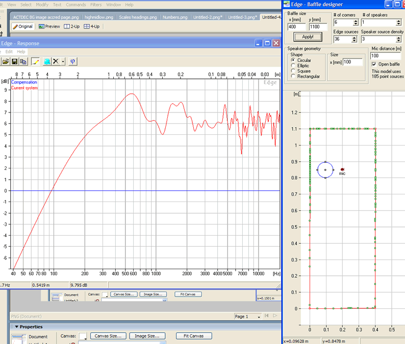

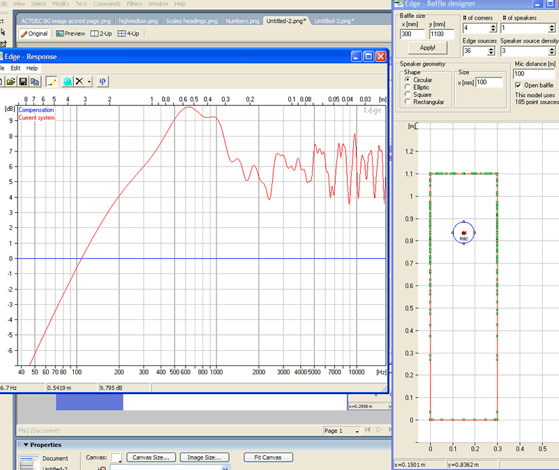

Do most speakers have that wide 2-3dB hump in the lower midrange? I will remove some of it in the x-over I guess, I hope it's not doing too much damage to the sound! I'll take a look at the 4" driver's position now.
As it is (poor!):
SimontY,
The EDGE program is a great tool if you keep in mind what it is showing you. It is calculating the effect of the baffle geometry and driver placement as if the driver's SPL were perfectly flat from DC to whatever upper frequency limit you specify. It is not showing you the response of a specific driver in a particular baffle geometry. Other then diameter, you have not told the program anything about the driver so it does not know if the driver response is naturally rolling off consistent with a low Qts value or if the driver response has a peak at fs due to a higher Qts. The EDGE is providing only one piece of the total solution.
If you look at the OB design article on my site, I provide a few plots that show the different contributors to OB response and the final resulting SPL frequency response. If you are set on a passive OB design I also provide some guidance on what types of driver combinations will combine to produce a balanced low frequency response.
Hope that helps,
Martin
Martin,
I wasn't expecting a reply from such a well known speaker designer! Excellent stuff. I've read your PDFs on open-baffle design and found them extremely enlightening. I know now that my next project will be something like a Creative Sound full range driver with high Qts woofer support - the 15" Eminence Alpha if I can somehow fit those in my tiny room. They're extraordinarily cheap drivers. I looked at the 12" version but the Qts is totally different (lower).
I am definitely set on a passive design for this "experiment" as it's a case of proving as cheaply as possible to myself that open baffle can provide a good sound for me, my music and in my room.
I am beginning to see that I need to work on reducing the lower midrange hump, increasing baffle width and maybe even adding wings too to give my low Qts drivers all the help they can get. The only positive thing is having good sensitivity from 4 per side.
I will order some more (larger) coils to set the lower crossover really low (~250hz I think), widen my baffles with cardboard or thin wood and roll off the midrange higher than 300hz.

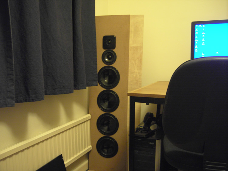

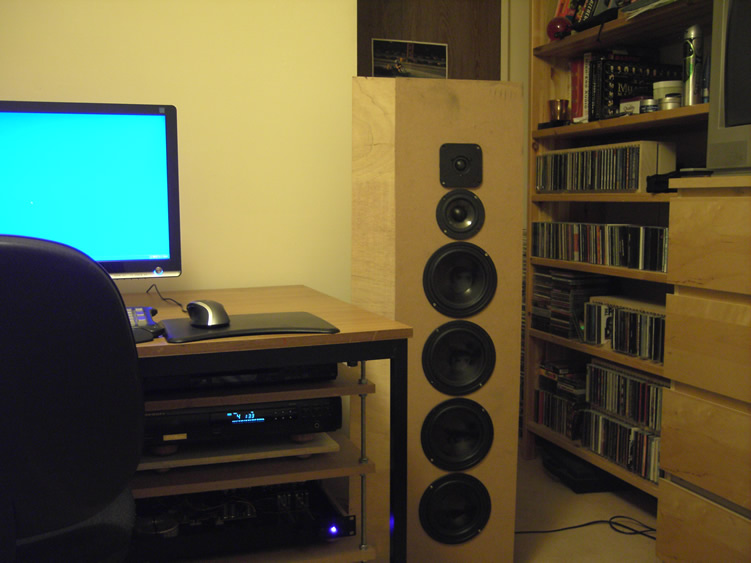

The extra width comes from some 4mm plywood I had from previous poly cylindrical diffusers I had to use in my previous (larger) room. This room's so small diffusion is less important, although I will be adding some shortly. Anyway, the sound is LOADS better now, the bass extending much, much further down. The upper bass is still very peaked, which ruins some instruments and gives a pronounced chesty punch to loud drums! Just need to wait for my 6 inductors now and see what they can do for me.
Simon

Just thought I'd add a word about overall sound quality, in case anyone's reading and wondering if such cheaply and, in fairness, quite randomly made dipoles could sound any good.
They do sound very pleasing, although the upper bass is too loud, and low bass is non-existent. This has the effect of making some material sound great or enhanced, but most songs sound a bit false and the illusion of reality isn't created. Some songs I've played made me smile and realise what I'm in for with open baffles... I've heard some music so vividly presented with a level of detail and dynamic intricacy that I'm simply not used to.
The upper midrange / very low treble (5khz-7khz I believe!) is emphasised and I will attempt to address this with careful crossover values. It makes everything sound over-sweet and coloured.
I will definitely want to go wide range + bass next time, so I only have one crossover to get right!! I'm too lazy to measure responses and do all the work to get it bang on.
Simon

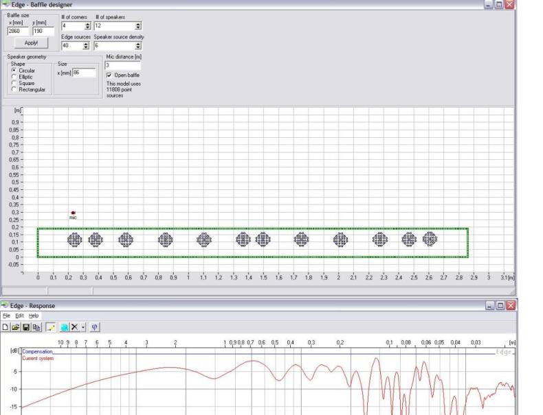

Hi SimontY,
since you are using multiple woofers ...
Just some ideas
- how to use "edge" to (not quite correctly) take floor reflections
and increase of radiation impedance into account using a
mirror baffle ...
- how to use multiple drivers to circumvent the dipole peak
- how to obtain a smooth LF rollof
Sorry for cutting frequency scale off:
First dark grey line from Left is 50Hz, second is 100 Hz.
Since you have a crossover frequency around 400 Hz,
you will not have to optimize the woofer spacing for
midrange and HF interference patterns. You can as well
check out some equidistant spacings.
Kind regards
