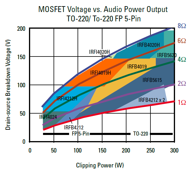

Here's the new catalog from IRF, its all inside with the new IR43xx integrated class-d "chipamp"
http://www.irf.com/product-info/selection-guide/sg11453.pdf
However, the graph is a bit conservative with their "clipping power rating" and contradic with LJM claims for L25D for 4020H of 350W @ 4ohm. Which its not archivable according to the graph
Is.If you can make your amplifier work at lower temperatures. Temperature, the active heatsink (fan). They can have more power.
On the contrary, if the temperature is relatively high, that their power will be lower than the rated output power.
The L25D rated power is 250W 8R.
If your speaker is 4 ohms, its output voltage will be smaller, you can lower powered L15D.
Reduce the voltage in the power, power unchanged, the current will be greater, more suitable for low impedance loads.
