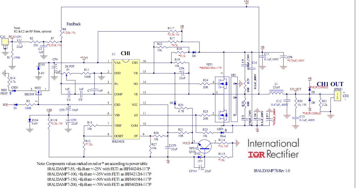

My design L20D IRS2092+IRFI4020H 200W8R
This is me a new design of the AMP. He had since the IR company demo version IRAUDAMP7S-200.
It USES the IRS2092 driver IC, and the IRFI4020H special mosfet output
Its power can do 200 W 8 R (+ 65 V). So I call it the L 20 D.
This version after four times improved. Scrap a lot of PCB to attain my design requirements.
In the test of the wave and test performance he almost and IRAUDAMP7 is same.
And before the same circuit design out, but often appear waveform distortion phenomenon.
I'm glad someone can like this design. It is very small, very beautiful. And a good voice, power is big enough.

Please refer to the IR company.
Are the same.
IRAUDAMP7S-150 =L15D
-200=L20D
Are the same.
-200=L20D
I suggest not used for any replacement.
Use + - 65 V voltage. Be better able to reach 200 W 8 R, 300 W 4 R. Output and distortion is small.

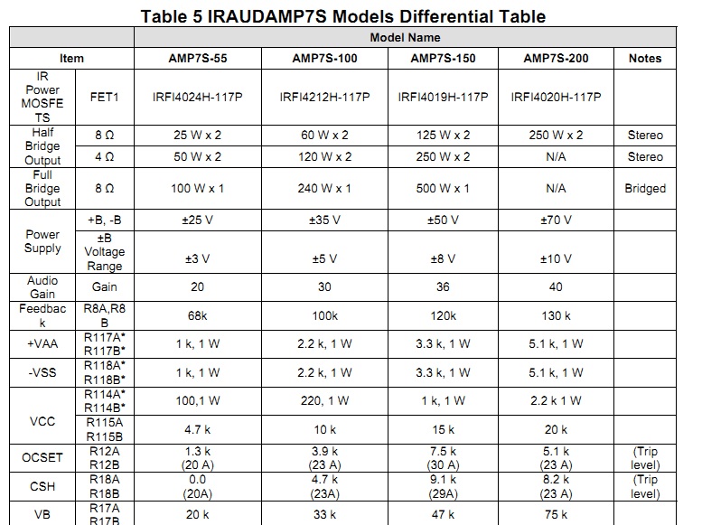

Hi ljm_ljm,
You mention above that L20D could reach 300W at 4R. But in the models table it says that the 200 shows N/A. I would like to purchase one of your boards L15D or L20D to be able to play at max 250-300W at 4R. Can the L20D achieve this?
I've seen trevmar nice writeup on the L20D board. Is the L15D just as good?
Hi ljm_ljm,
The L15D and L20D are the same circuit, with several resistor changes to allow for different Power supply and power output ratings.. Besides being able to provide higher current, the L20D and L15D should sound the same..
Okay excellent. Then do you know if the L20D in the stock version without any modifications will drive 4ohm speakers and if so at what voltage? 65 or more?
No, according to the Reference Design that they are based on, as well as the info I see on ebay about the L20D, they do not specify a 4ohm rating for then L20D. The L15D is capable of 250W into 4ohms though, with +-50V supplies, so you should probably go with them instead.

L15D + -50V 250W 4R。
it is Very good sound quality. As IRAUDAMP7 same.
With enough power.

i would like to use the L20d for bass and L15d for mid but use the same smps.
What would the most appropriate voltage be that would work optimally for both? eg 60V ??
Just use the L20D for everything.. that way you can use one 70V supply.. There is only about $5 difference between them anyway..
The difference between the L20D and L15D, besides the Power Mosfet is basically due to the adjustments for higher PS voltages and thus higher current outputs
