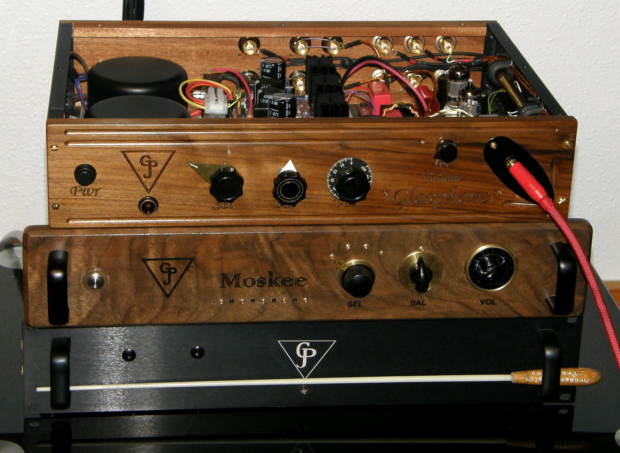

My present build is also a preamp with two 12AU7 tubes in circuit. I am using a 25 VA for the heater supply, and a separate 25 VA for the B+ supply. It is the top unit shown in the picture. Still have a ways to go, but it is functional for now.
Very nice! I was thinking of using a lot of wood in construction too, made from scratch, so however big it needs to be is how it will be made (within reason)
Where did you get the toroid covers? and is the input selector straight switches or relay based?

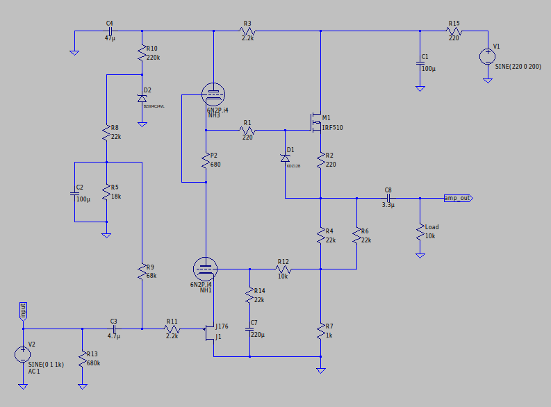

I shall start the preamp test PCB's. Maybe I should also try an SRPP in place of the bootstrap:
Distortion reports at 0.14% at 13.6Vac. Not bad, but the biasing via R8 and R5 seems to effect distortion much greater than the resistor (and bootstrap) approach.

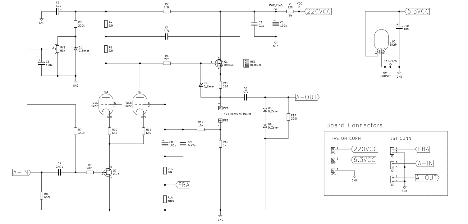

So the amplifier circuit look's good? I can't see any problem with it and 'should' support a range of tubes like 12AX7, 12AT7, 6DJ8 using pot RV1 to set the bias point of the plates.
The solid state is a compromise, but are only used as source followers and thus will contribute minimally to the sound.
