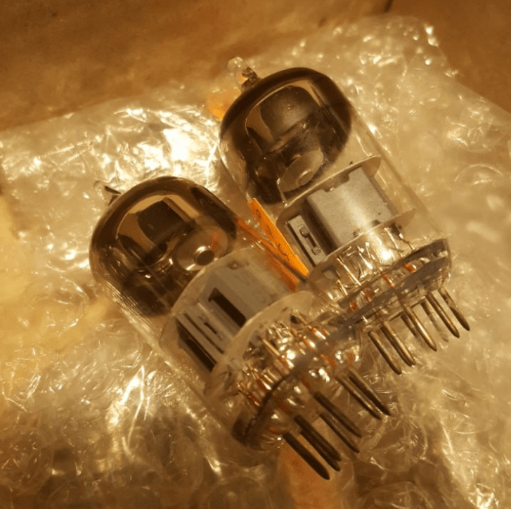

Thing is I already have a dozen or so 6N2P tubes that only take a 6.3V connection.

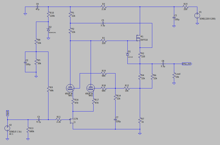

I'd rather focus on the next stage, the amp its self:
Seems like a good design to me with obvious high input impedance and a good simulation distortion profile.
I have also simulated it with 6N2P, 6N1P, 12AX7, 12AT7 and 6DJ8 with little change needed to set the bias.
Good for tube-rolling fun? 🙂
Worth a test PCB?

I don't have the models for IRF830, it be used in actuality. I don't think there will be much difference.
I may hunt for the models..
Not to over complicate things, but I wonder if a bass and treble control could be built in the feedback network around R12?
Oh no, just not in the feedback loop. No potentiometers in that area as it is asking for trouble. Old stuff had that and possibly readers recall the sound of scratching 🙂
Even conductive plastic, cermet, stepped stuff can have scratchy contacts. They usually have that as a feature.
Not enough time to check the complete design but you make decoupling caps after a voltage regulator way too high in value IMHO.
So the ripple will be to low? Or the value is that high it won't make a difference anyway?
There's also channel separation to consider.
There is practically no ripple after the regulator. There is ripple voltage before the regulator 😉

I was also wondering if I can switch the boot-strap capacitor C5 in and out while on and listening, I was thinking a dual pole relay to disconnect it from the MOSFET source then to connect a resistor across C5 to keep the voltage potential the same so when reconnected it shouldn't effect the output to much and have a smooth operation?
Funny that you should ask. On the GlassWare website, John sells a little switchboard sort of thing for just such a purpose. See if it can work for your case.
What is the best way to go about grounding and earthing? I'm thinking of leaving the chassis floating (not connected to house earth), but only connecting the chassis to GND from a thick wire to power supply GND. The power supply board would act as a 'star ground' for everything.
There will be a suitable fuse in the mains plug.
Does this sound correct?
