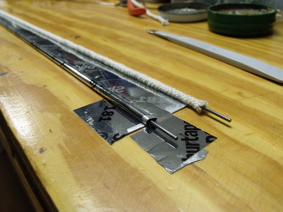

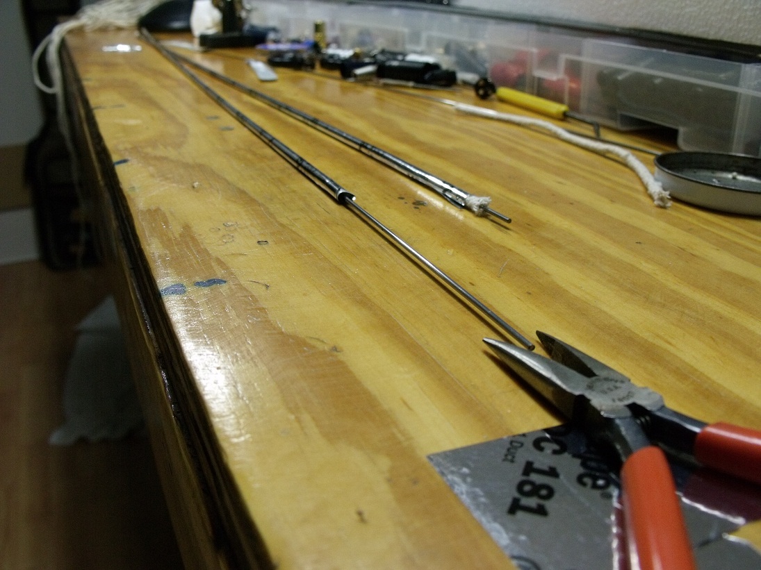

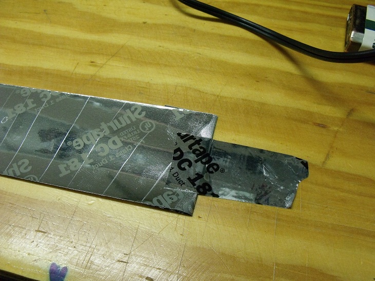

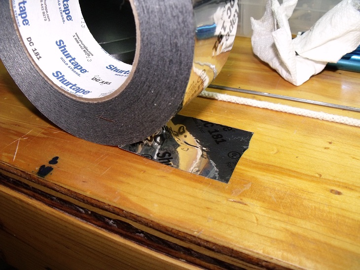

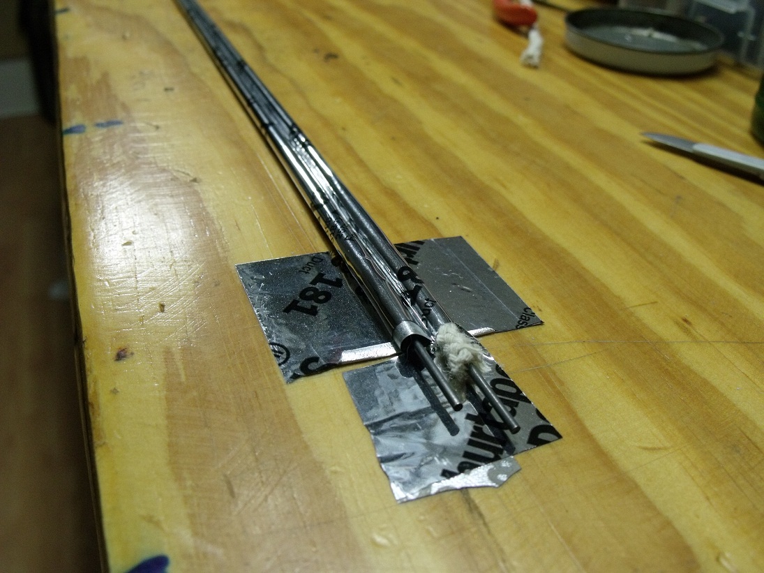

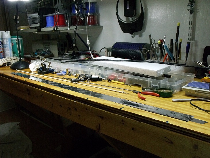

Choose the appropriate length of interconnect that you want to construct...then roll out some tape a little past the final length of cable. Fold the tape over itself, then roll it out...then fold the other end over itself. Use little pieces to "tension" the tape. Not too tight. Just enough to keep it it from crinkling.
oops forgot the pics...

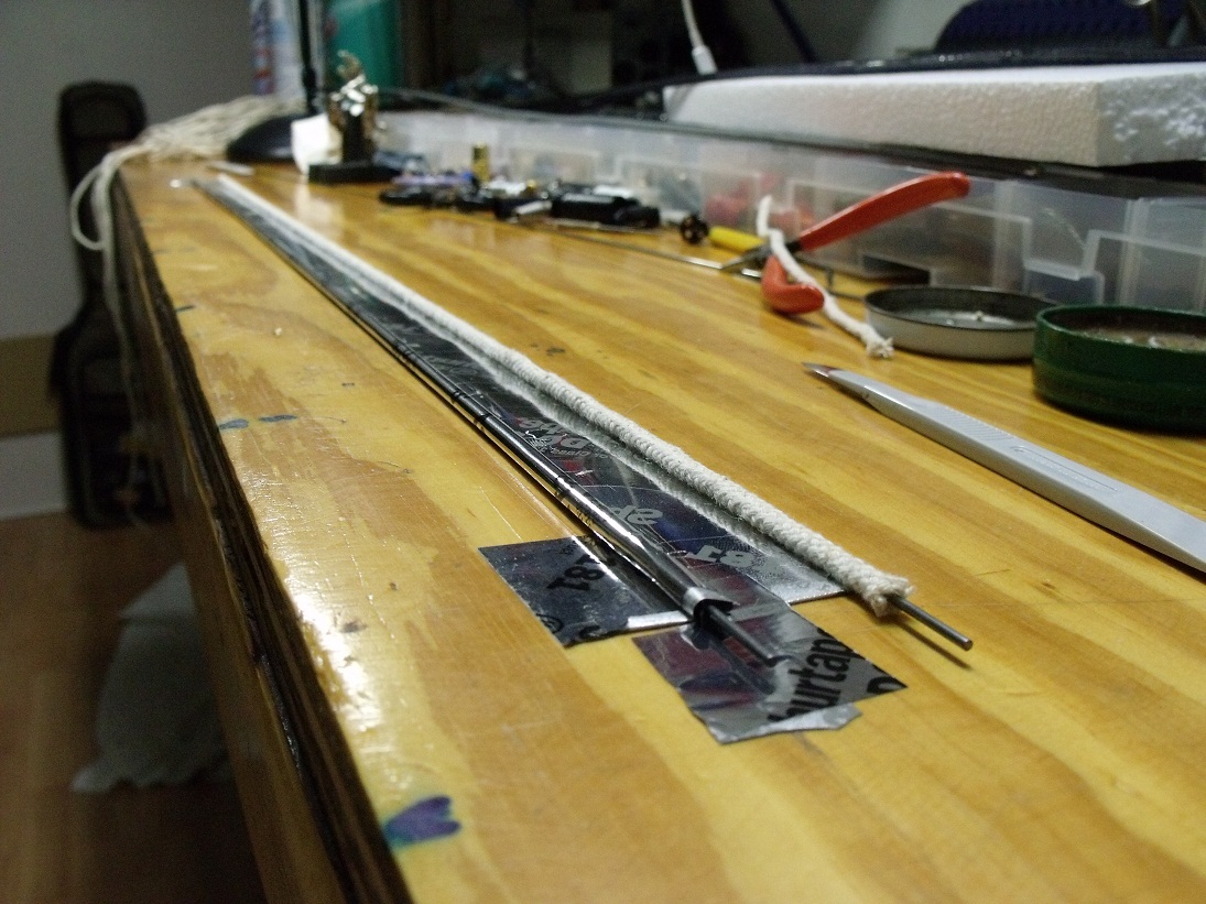

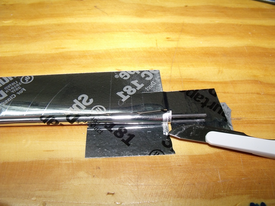

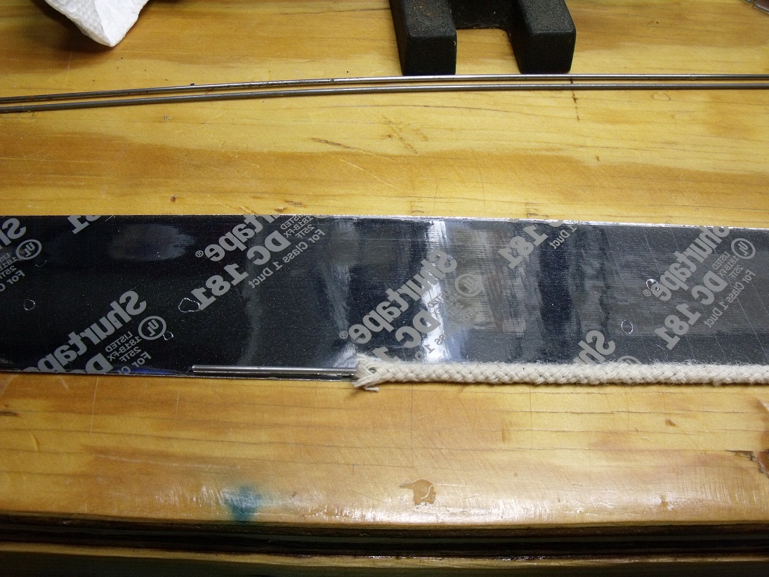

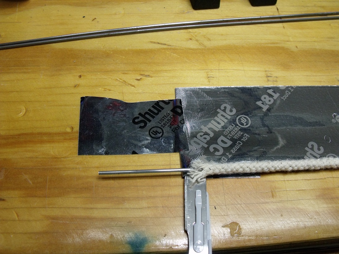

OK...so start wrapping the foil around the cotton. Prior to doing so...slice the folded tape at both ends of the run, just a few mm. This will allow the foil to wrap around the cotton...and will continue to separate on its own from the taped down end. When you get to where the tension tape is...slice a little more in that area. I use to do this process without the paino wire... believe it or not, I was successful. Adding the wire is so much easier though. Start at one end AND GO SLOWLY. The slower you move towards the opposite direction the more control you will have over how even the foil wrap is distributed along the cotton. This takes practice to get the shielding done without any wrinkles or kinks. TAKE YOUR TIME I SAID!!!!:nownow:
observe...

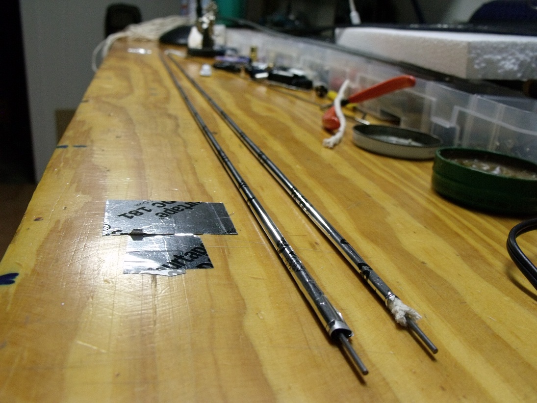

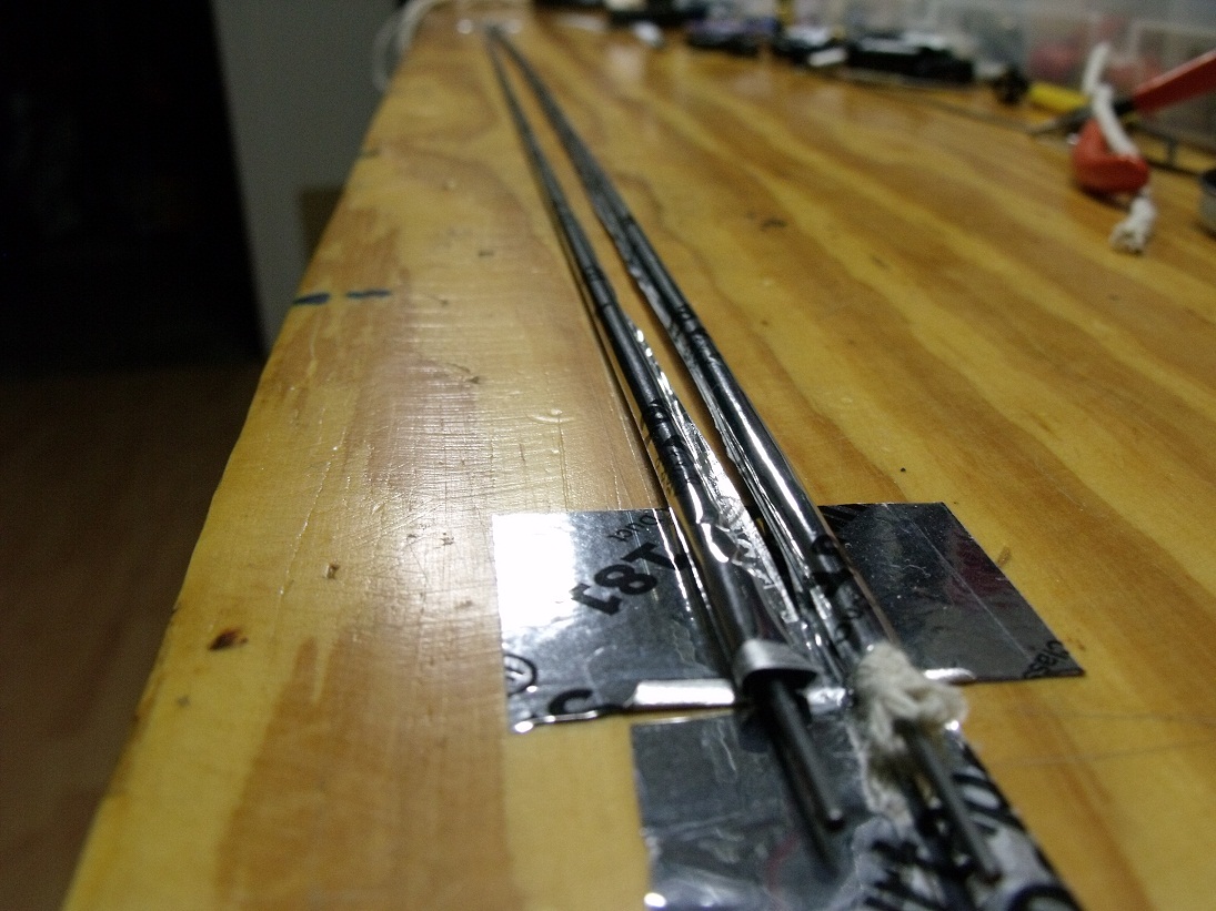

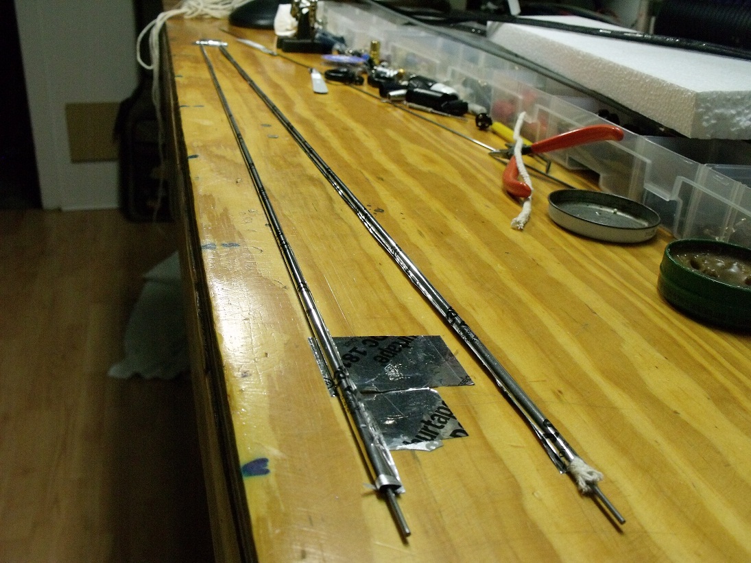

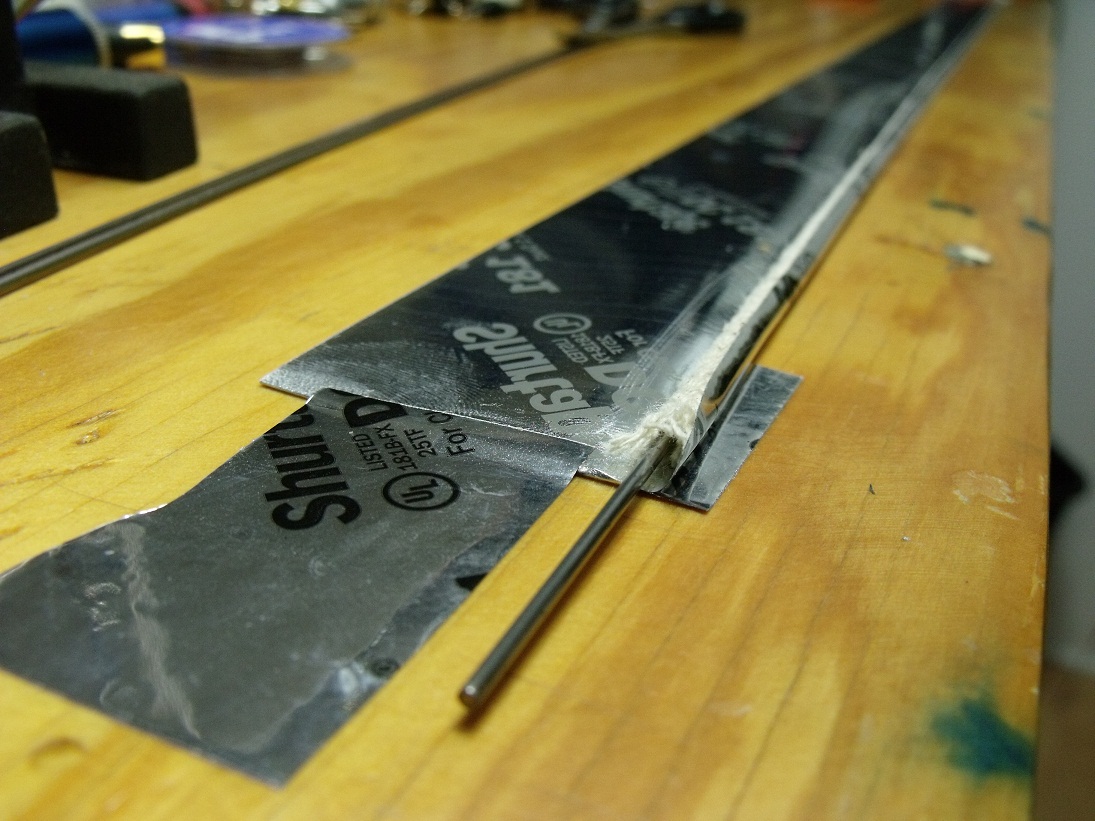

...now, when you get half way...start at the other end doing the exact same thing with another piece of cotton/piano wire strand working backwards.

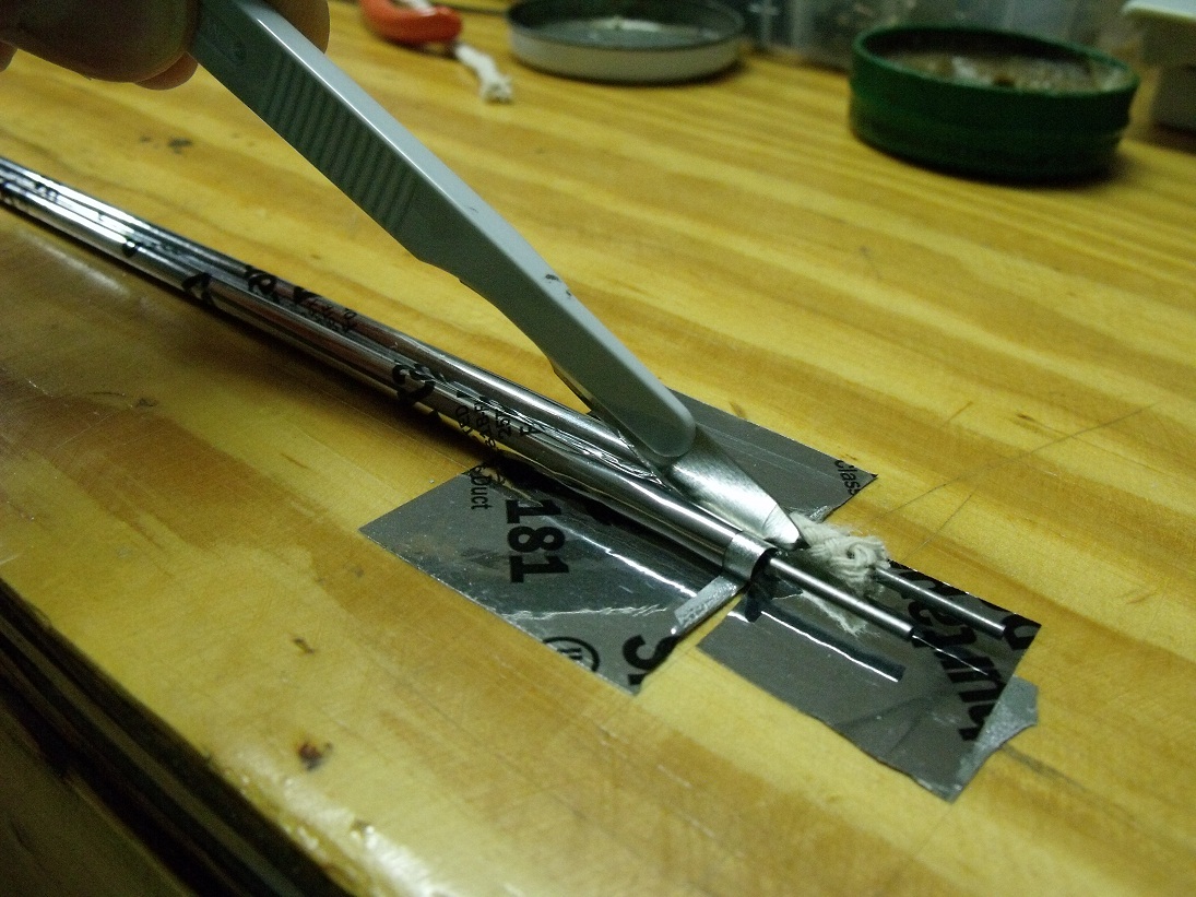

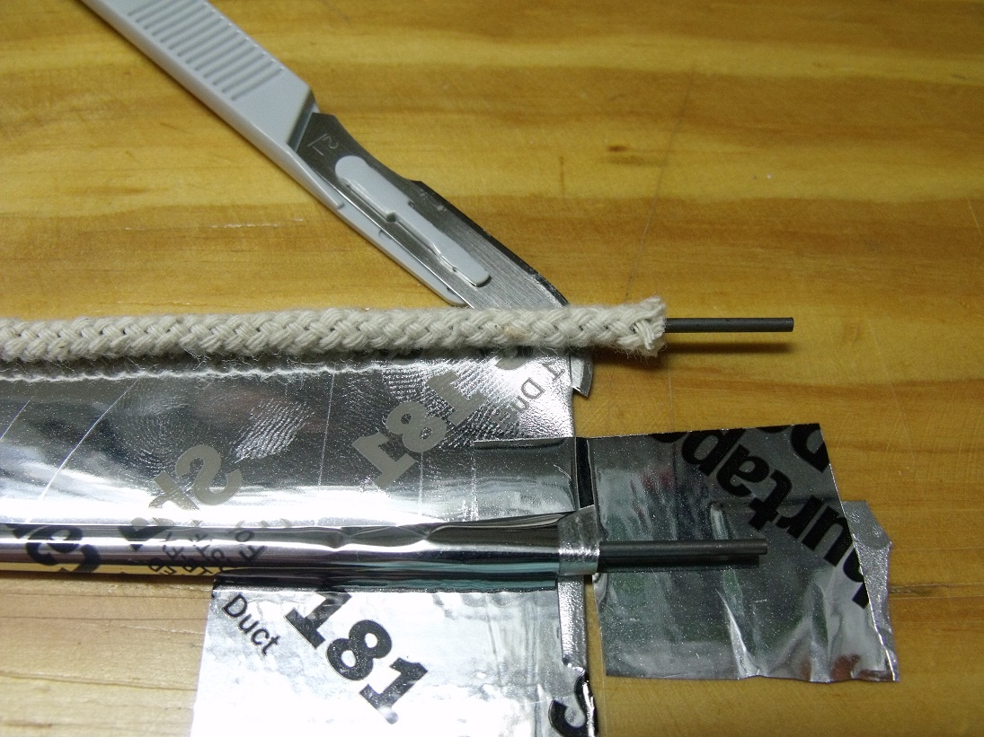

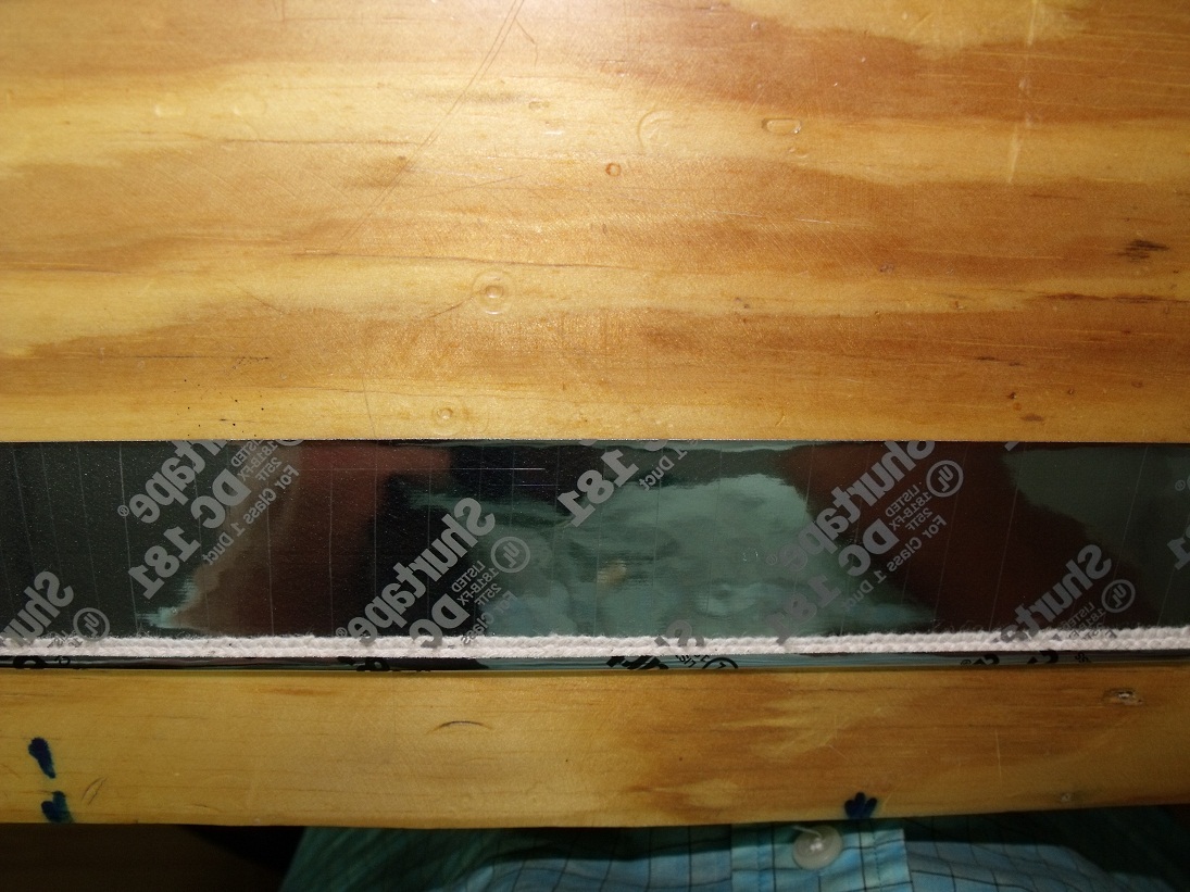

Now, use an exacto knife and slice down the middle...if you don't do this carefully, you're going to cut right into the rolled shielding and mess up the build.

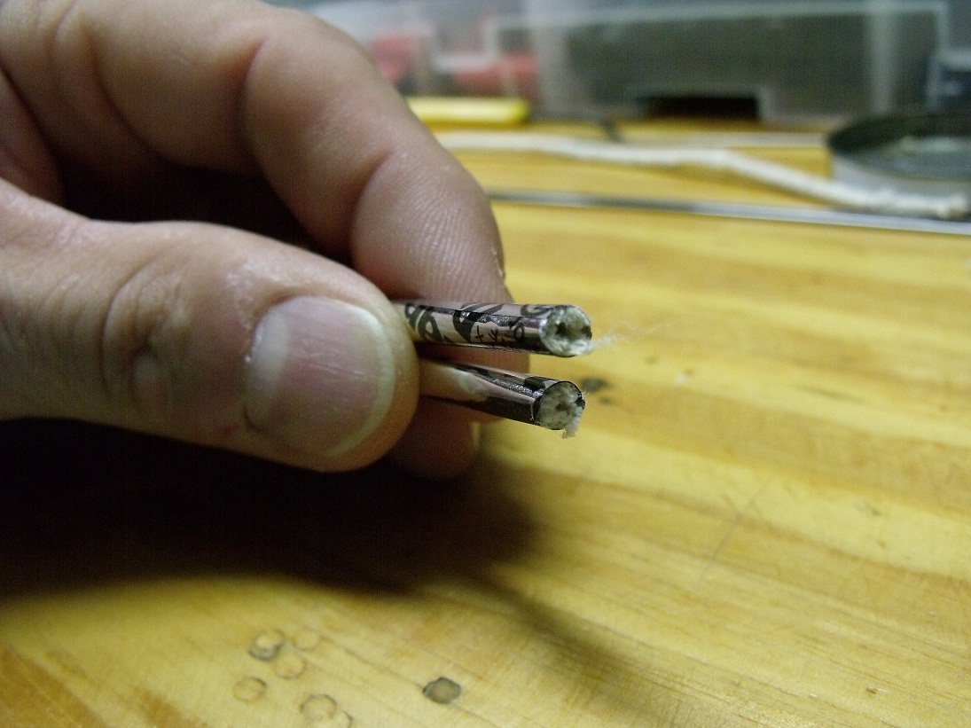

Voilà!

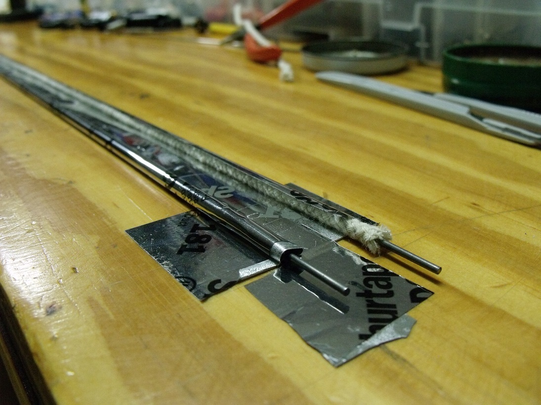

Now pull out the piano wire. If you stretched the cotton rope very tight onto the piano wire earlier in the build...this step will be very difficult. I will explain later. Now...cut the ends straight with the exacto knife. I's nice eh?

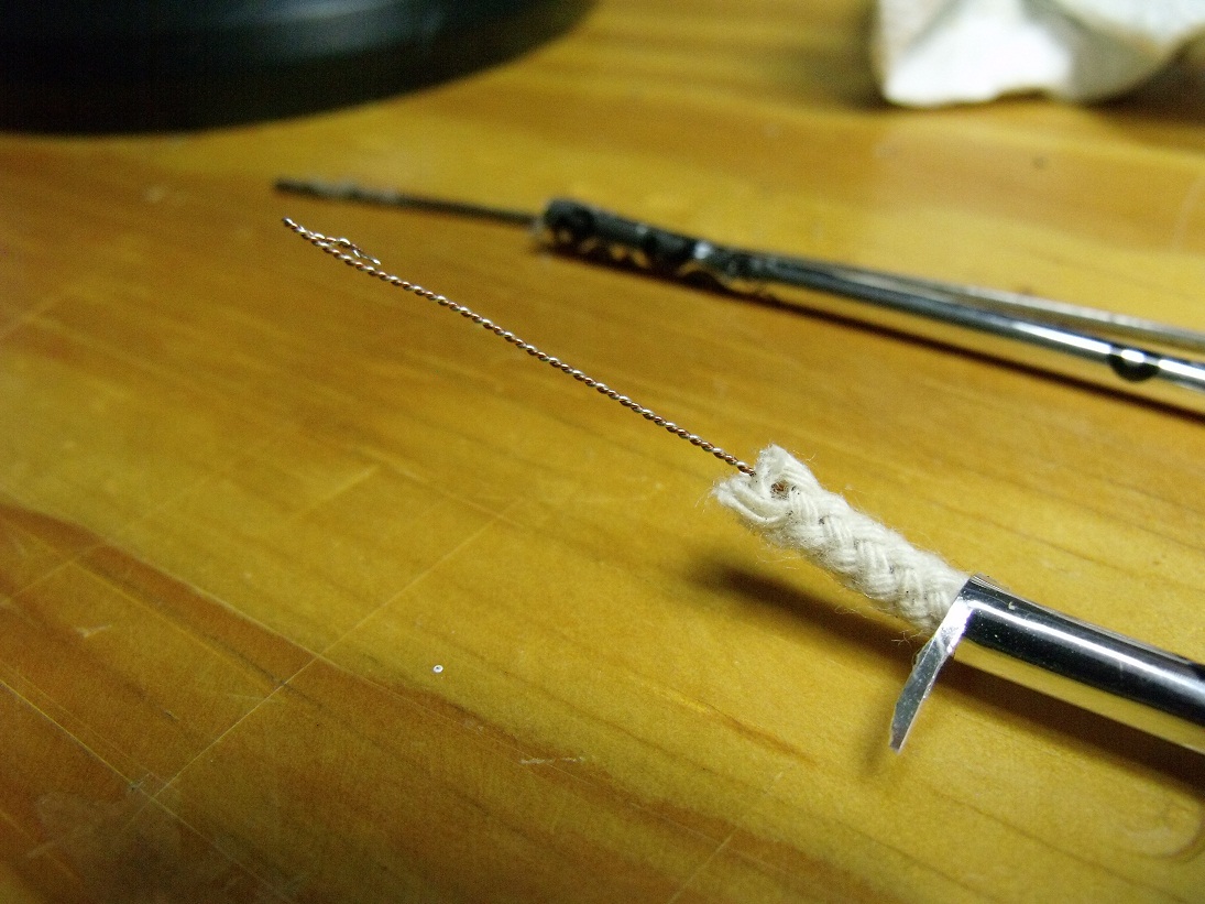

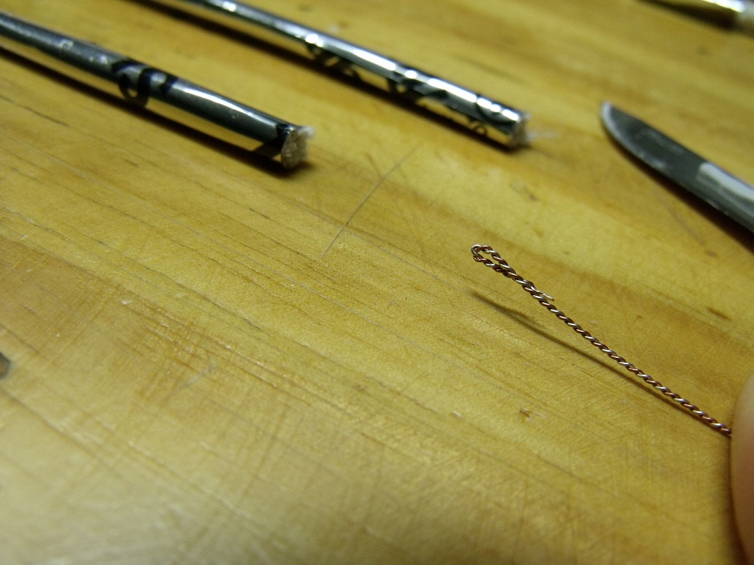

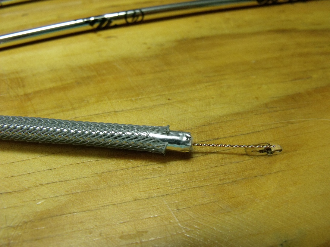

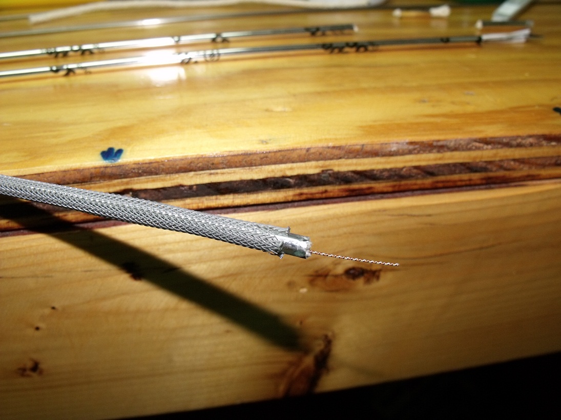

Now push your conductor through. Bend the end slightly so it doesn't catch itself inside the cotton and prohibit the wire from moving further. A 28 gauge wire will slide through very easily. Shown here is my 28 gauge silver/copper wound wires. I will show you how to do this later on.
