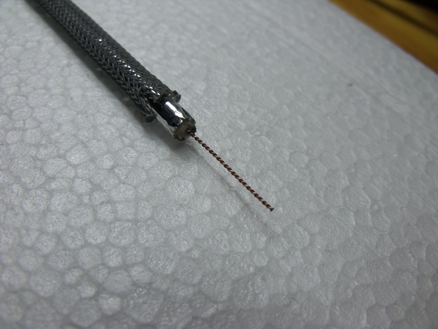

I thought about the MU metal shielding...but when I looked at the pricing, it was out of the question as far a what I had in mind. Granted, even though I did spend allot of money investing in this hobby...my ultimate goal was to make everything from materials widely available that would do the job. As much hands-on as possible.

Sounds interesting. Regarding the way I have designed mine...the shielding is substantially distanced from the conductor. I didn't want anything influencing the signal from internal interactions. Ill, be on in a little with pictures of the design.

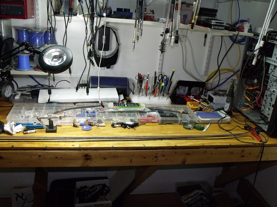

Here we go peeps...

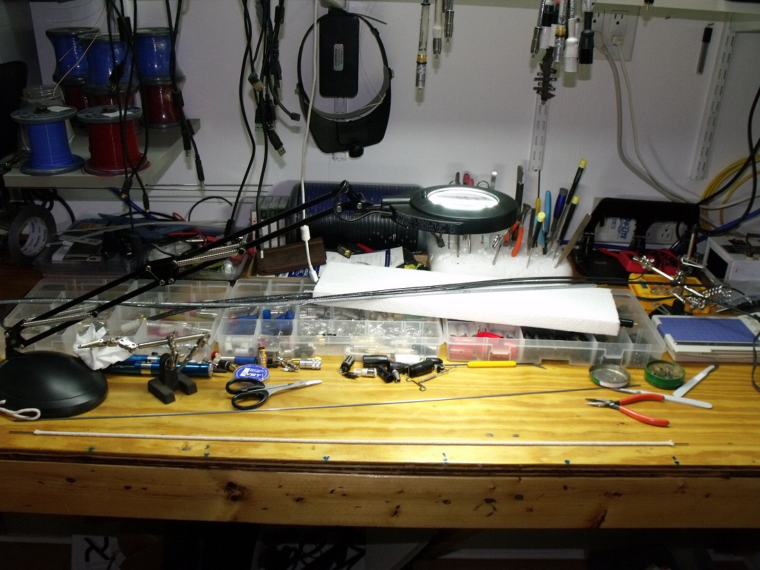

Not too many words tonight...a few pics to get things going.

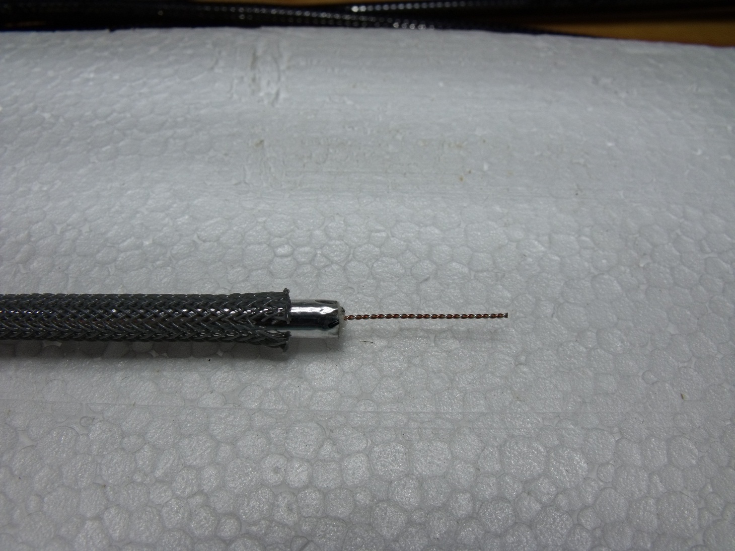

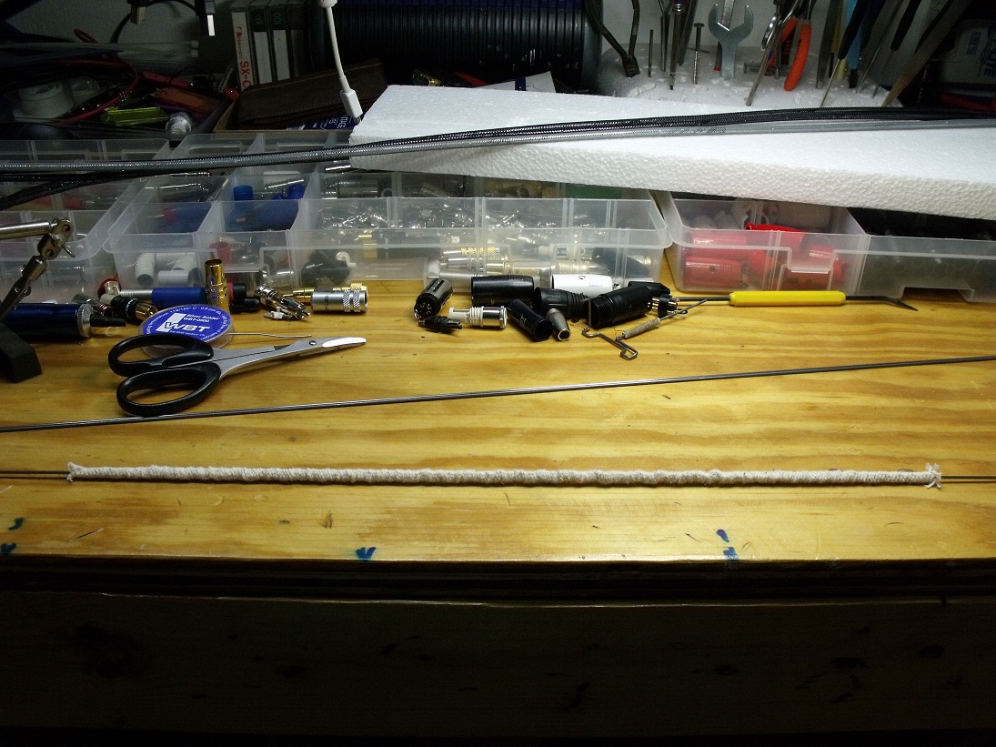

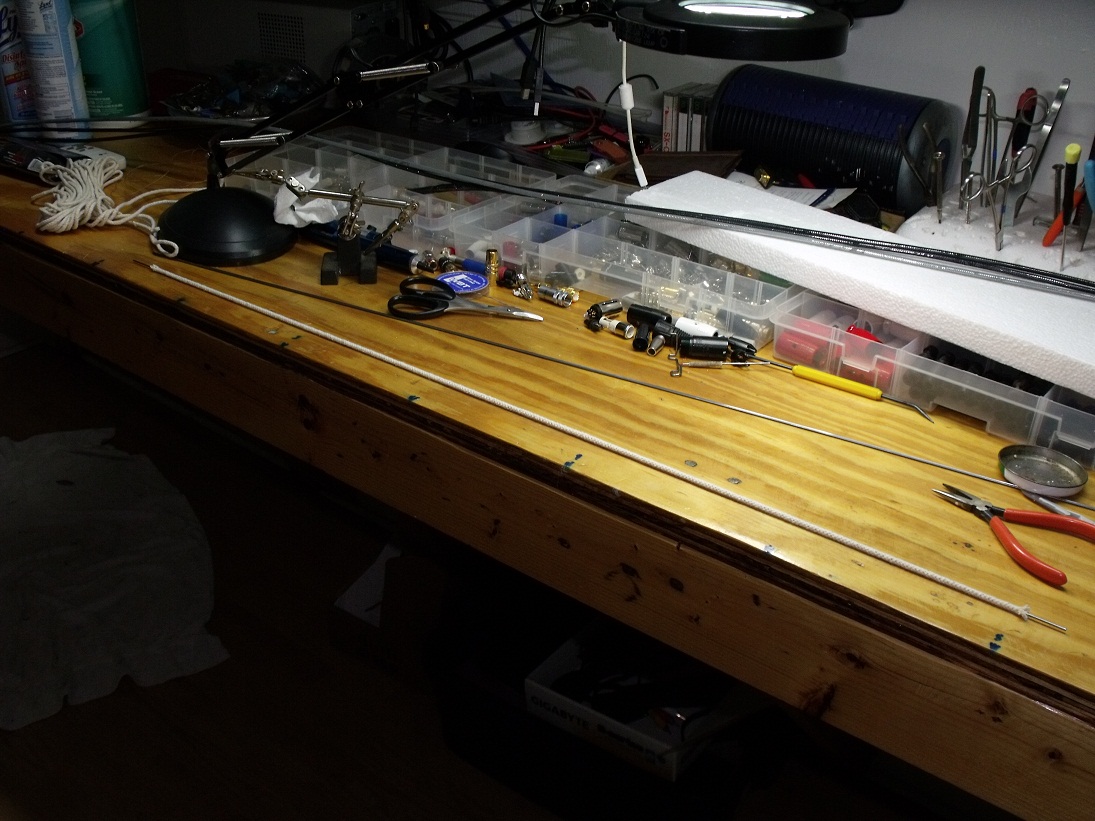

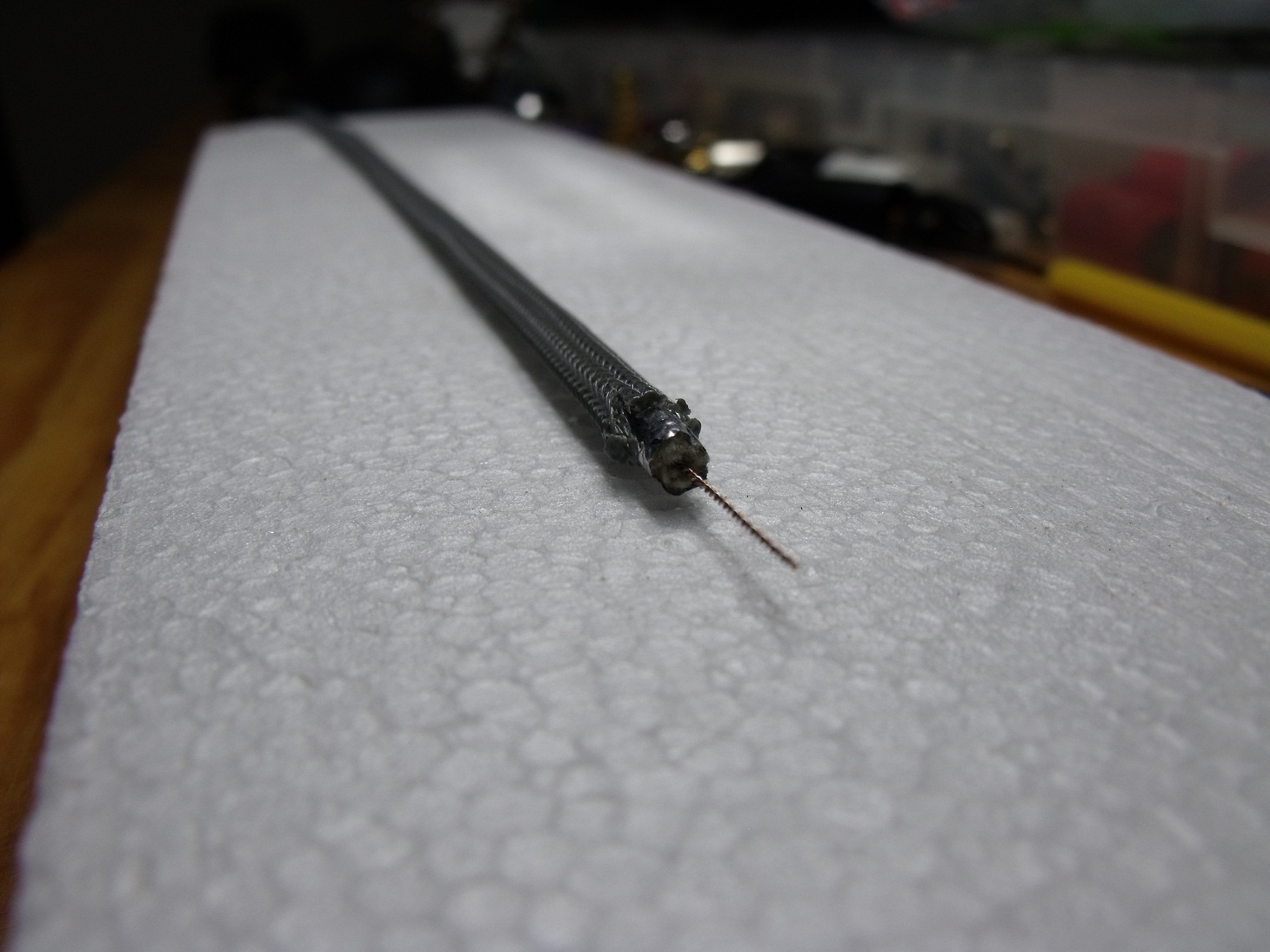

See that tube? Thats how I store the cables before adding the conductors. I have managed to make up to 7 foot cables with my technique.
Once made, I slide some texflex over the cable so the shielding does not unwrap. Once in the texflex jacket, a few days will keep the cable from unwrapping permanently.
Pretty from the outside eh??
This is the final cable prior to adding the RCA/XLR connectors. Two cables make up a set of RCA's. Three for XLR's. I will show you later on down the line how the final combination of single runs add up to one RCA. There are a few different ways to house both runs, depending on a few factors like aesthetics and handling strength characteristics.

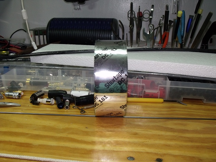

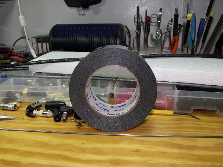

If you realy want to shield the cable Mu metal tape and copper braid is the best combination in todays EMI polluted world.
do you have a source for the tape ?

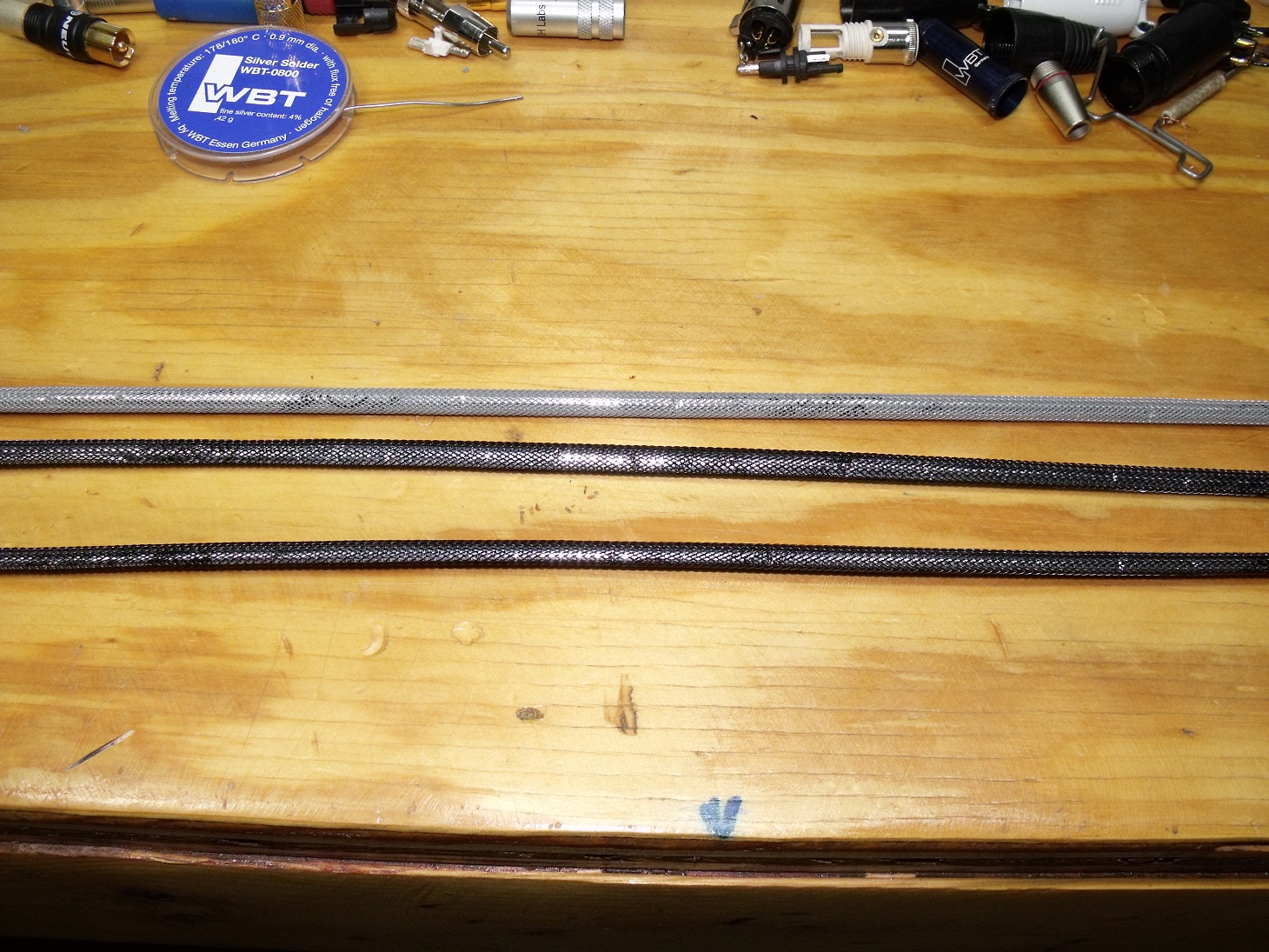

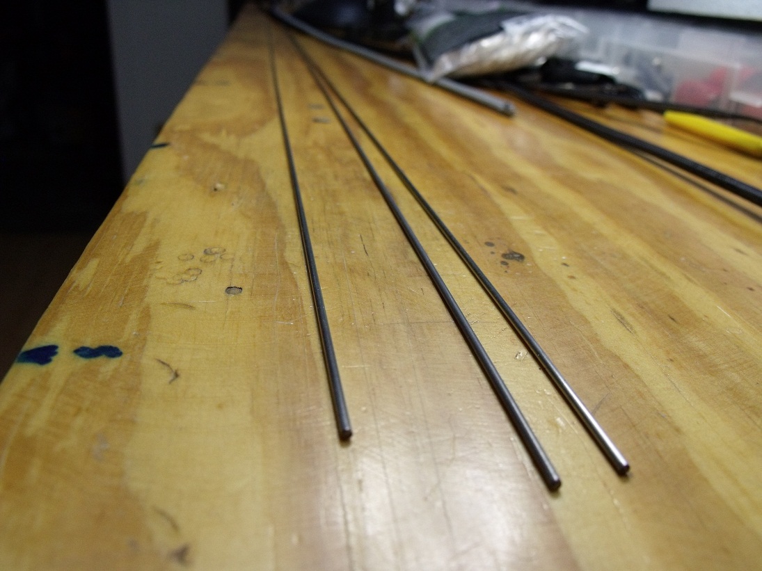

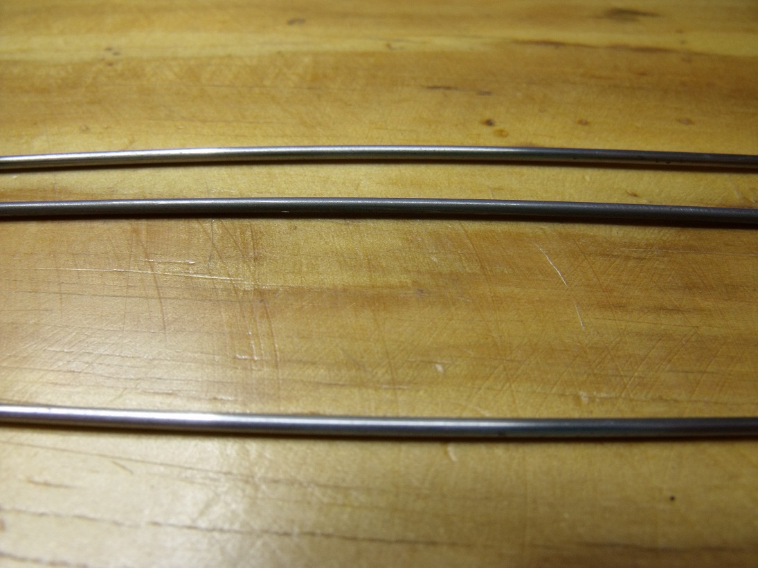

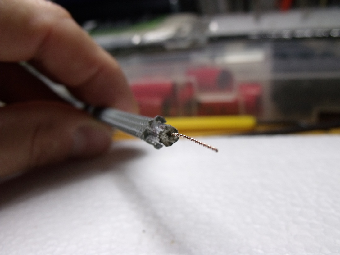

Check out the space inside the cotton dielectric. BIG. Air functions more as a dielectric here than the cotton. You will need piano wire or spring steel. I forget the diameter...I will post that later. I got these from the local hobby store. They come in 3 foot lengths. To make longer cables...I will show you how to combine 2 together to make longer shielding.
The middle piano wire is original. The outer two have been polished with steel wool and wet sanding. YOU HAVE to get the piano wire as smooth as possible.
I remember it was easy to locate online. Just google it.

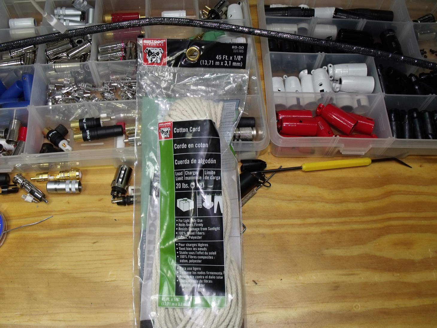

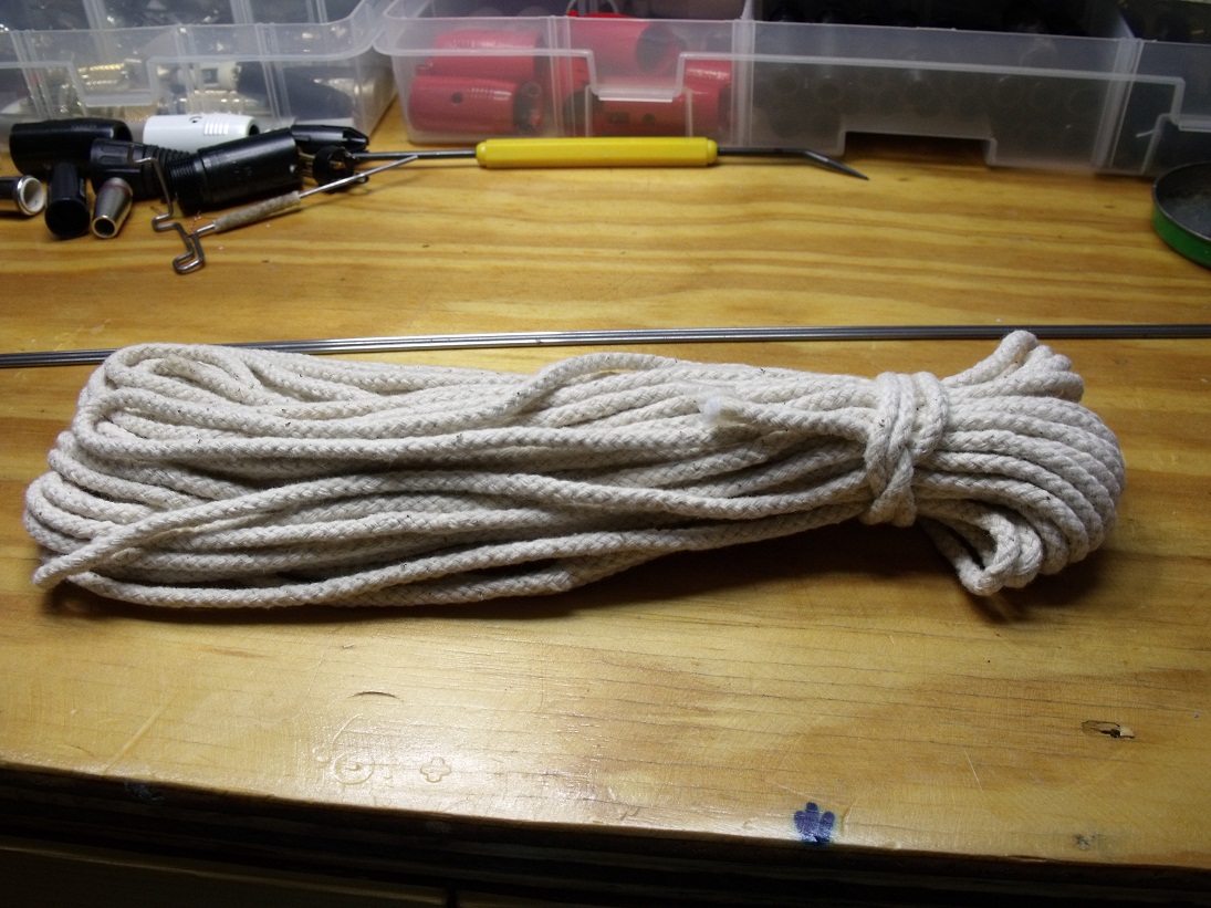

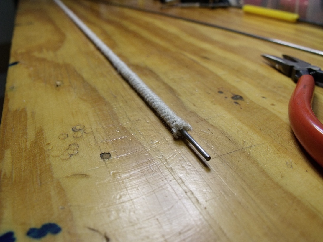

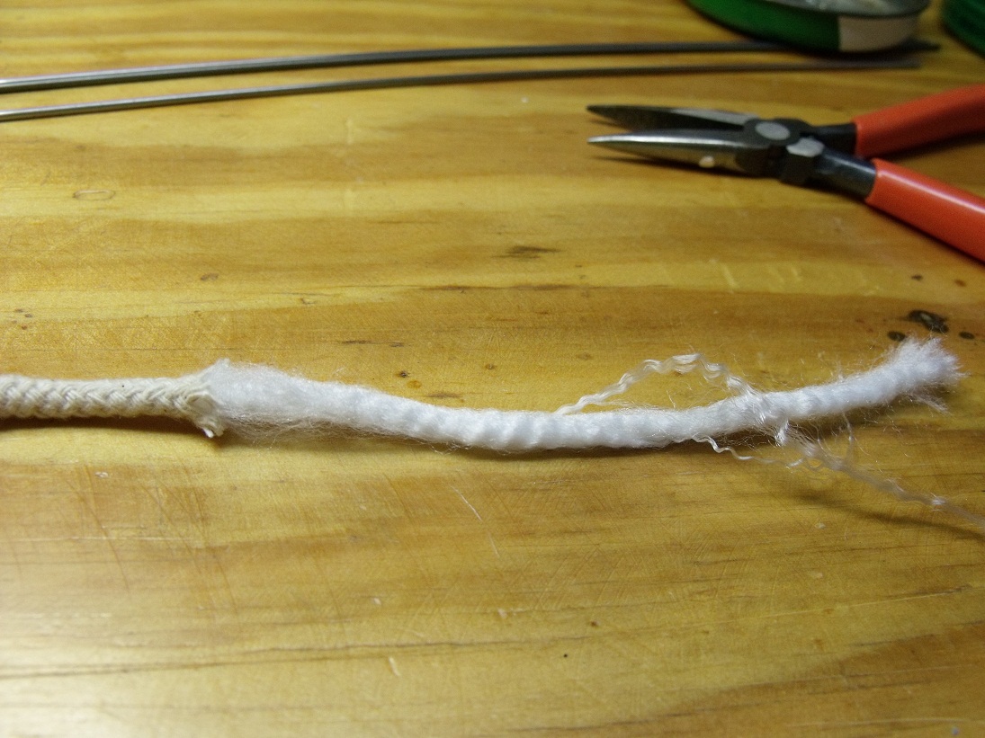

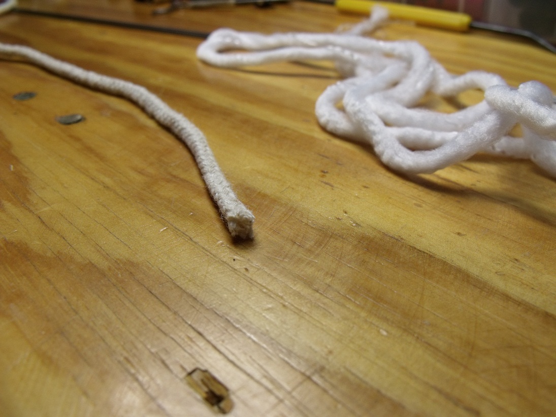

Pick up some cotton rope. It has a polyester stranded interior. Use a pair of needle nose pliers and pull the polyester out. It is easily done by pulling the cotton in the opposite direction. Once done, all the polyester is out...and you have a perfect large diameter opening.
The piano wire needs to be polished with steel wool or very fine wet sanding. The smoother you get the metal...the easier it will slide into the cotton. TRUST ME...polish the crap out of it. When you are working on sliding it in 6 feet of cotton..it HAS to be very smooth to go in.
