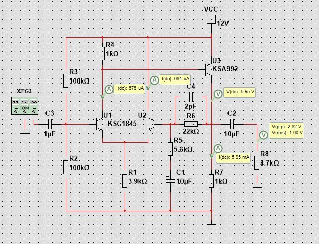

Distortion is caused by the non-linear relationship between voltage and current. Your three-transistor circuit is doing well because the current remains nearly constant. The op-amp version can do well with two more transistors for current-source biasing.THD compare:
0.00182% opamp version
0.00008% my best

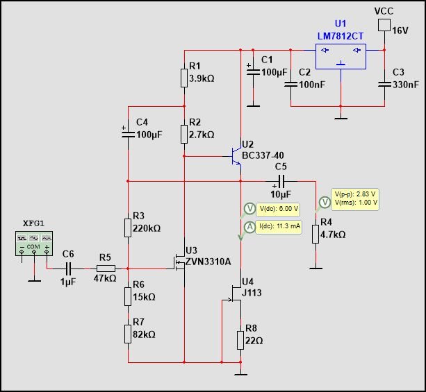

Whats the max output voltage?If we stick to 3 transistors and 12V supply,
here is the classical opamp version.
THD compare:
0.00008% my best
Thanks for your tip.Distortion is caused by the non-linear relationship between voltage and current. Your three-transistor circuit is doing well because the current remains nearly constant. The op-amp version can do well with two more transistors for current-source biasing.
Ed
But the idea of this thread is 3 transistors.
With higher number of transistors it is possible to get even lower THD. I am almost sure.
I want to see 3 transistor circuits.
It is a rather noisy with 28nV/√Hz from the input resistor, I'm sure its possible to do a lot better from a noise perspective. Have you compared the THD+N to the THD?
