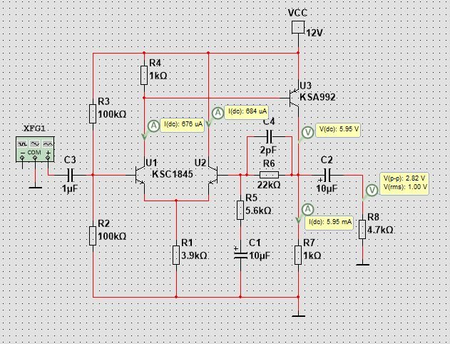

My best discrete preamp with 3 transistors
Let me start to say that this is only simulation with SPICE.
But I have no doubt this amplifier should do very well for real.
I challenge you to do something like it or even better 🙂
Design goals:
1. Fully discrete
2. Max 3 transistors
3. Voltage gain 4-5
4. Load 1Vrms into 4.7kOhm
5. Regulated 12V supply
Result in SPICE:
1. Voltage gain 4.6
2. THD 0.00011%
3. Frequency response 5Hz-300kHz -3dB

If one replace the single ended buffer U2/U3 by a push pull power darlington buffer, we came to the good known "el cheapo" topology - go to fig. 1 under
https://sound-au.com/project12a.htm
Reactions: lineup

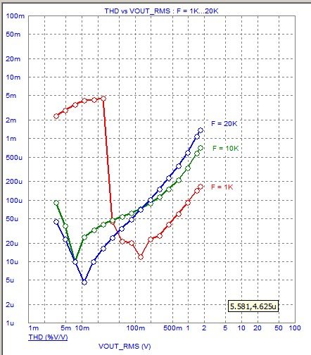

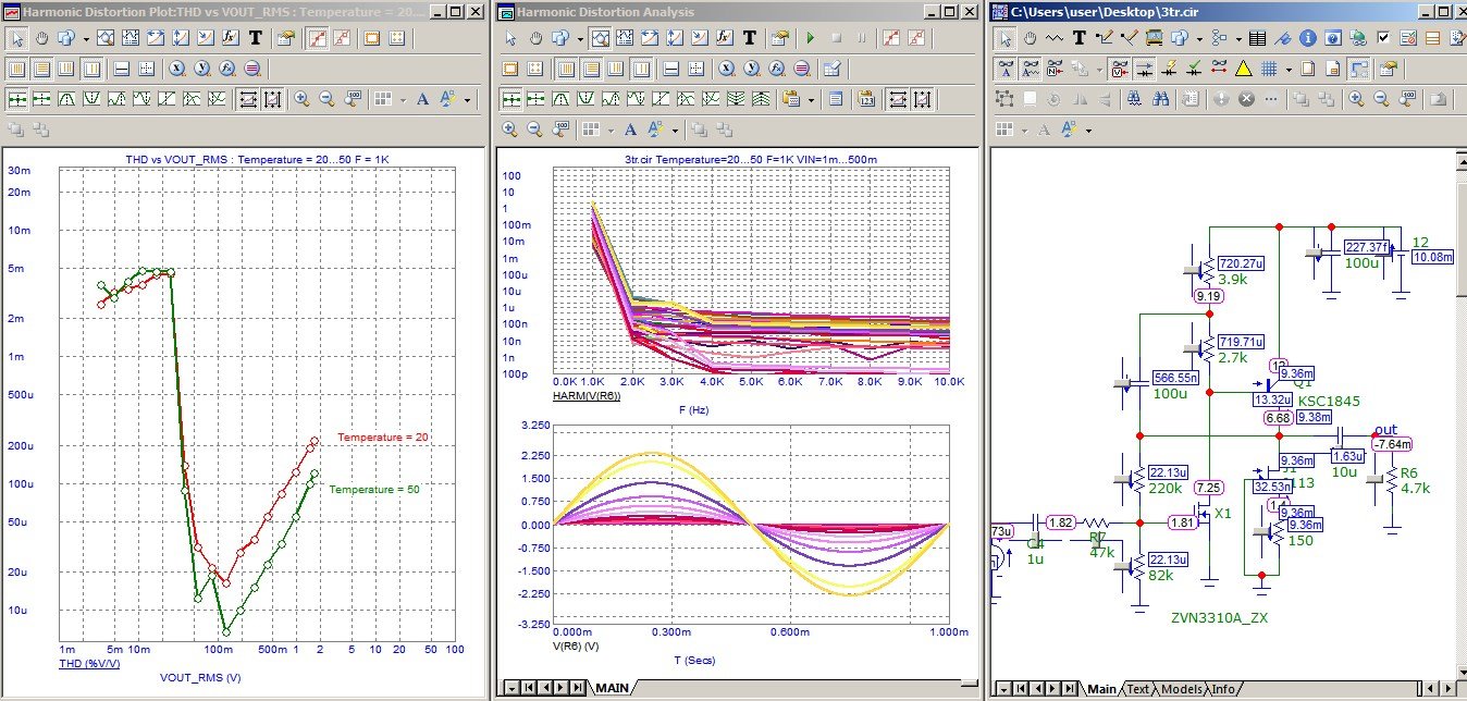

2. THD 0.00008%
Hi, colleague!
I'm interested in such simple solutions, so I took the liberty of running a simulation in MC12.
Overall, the frequency response matches well, and the distortion is low.
However, at low signal levels, there's a slight anomaly or nonlinearity.
The distortion level is about 0.005%.
P.S. Perhaps you need to play with the capacitor values.
Reactions: lineup

I assumed R3-C3 a bootstrap config, but it was not so, but intended as an overall gain setting.
The gain then is (C3 acts as a bootstrap with R1-R8 for U1) R3 / ( R2 // (R4 + Rsource) ), which is source depending.
That R1-R8-C3 bootstrap trick for U1 limits the output swing somewhat.
The dynamic headroom is not so much with a supply of 12Vdc.
Reactions: lineup

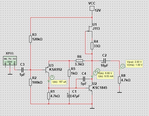

Ok, now with CFB you have little bit more THD (simulated) that is below any hearing threshold anyway. But you also removed noisy 47k FB resistor from input, and check HF response now comparing to first iteration, I bet it will go to MHz
I like last CFB iteration very much. @lineup , if you are in mood to complicate a bit; copy and mirror paste complete circuit , delete both C1 and one R5, than just connect remaining R5 to emitter of other side U3 (instead of GND). Should result in fully differential fast amp with even harmonic distortion canceled.
