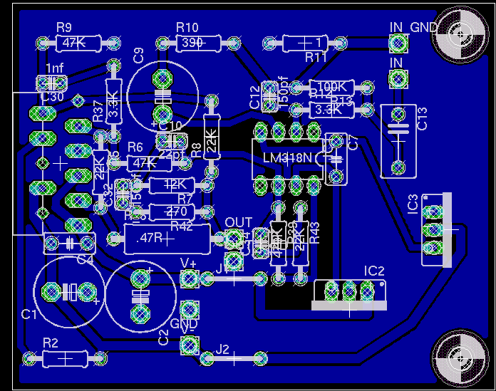

Yes, I understand you can go that route, and really it should work fine. 🙂 But I really have a couple of reasons for my PCB layout.
1) I want 5 channels in one enclosure for 5.1 listening.
2) I want a seperate PS from the amp board so that I can easily swap amp sections if that is all that has changed.
3) I don't really like "hillbilly rigging" if I don't have to. 😉
Yes those PE trafos woprk great! I have been listening to my standard NIGC with one for the better part of a week! What a steal! Those are perfect gainclone trafos.
Here is my latest iteration with the additon of LM7812 and LM7912 voltage regulators on board for the opamps.
Not finished quite yet as I still do not have some bypass caps in place for the VRs. Also I will add more pads for larger input caps.
Cheers!
Russ

Alas, it appears there are a few problems with my layout.
1) Lm7812/7912 may not be suitable as the input voltage would be close to its maximum. So I will redesign using the RCZ net as Mauro did.
2) I need to include some sort of soft start/delay circuit to elminate the turn on thump.
3) Grounding may be somewhat iffy. Still looking at that.
Would a larger value cap on the mute release pin suffice?
edit: After re-examining the PCB, would any cap on the mute release suffice?
Edit 2: After looking at the LM318 data sheets, the supply voltages are good @ +/- 12VDC. The input voltage is refering to signal input not pwr supply input.

I am not sure if the mute cap would work or not.... It just might.
I was referring to the max input voltage on the LM7812/7912 which is 35V. Which happens to be just about what the rails would be at.

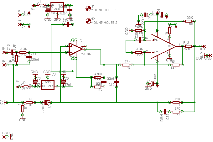

Hi all,
How to have said various turned in the thread, this circuit is a lot of nonelementary ( even if with little components ).
The matter of the "thump" is not easily that can be managed because there are 2 Opamp nesting with common NFB, and LM3886 is in configuration to bridge. The mute of LM3886 is unusable, because LM318 would go to clipping for follow the LM3886 STBY.
I have recommended to Russ to follow more possible my layout of the circuit to avoid problems of: oscillations and Ground loop.
The matter of the external Hi-cap doesn't exalt me because sets the "endless" problems described in the Thread " snubber yes or not " but it is a personal choice.
Naturally all am clear of interprets to like them my circuit, but in my layout it is "hidden" different years of technical "analysis"...
ciao
Mauro

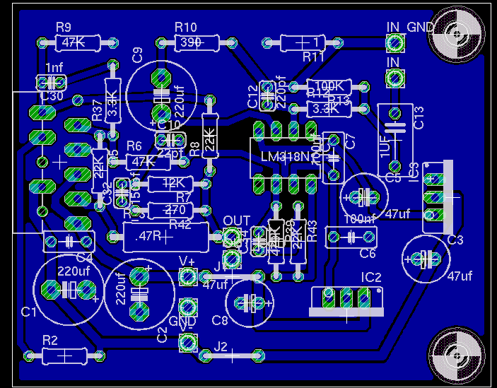

I see the 14 volt relay for the output. Is there an issue using it to handle the turn on thump?
I do not like the thumps, several amps built have switches on the outputs to allow stabilization then turning on. I use double throw with 15 ohm rsistors on one side for loading and speaker connection on other. A realy is much better, no hassle.
George
Yes, Mauro's layout with the relay handles this quite nicely. I will add the same circuit to my layout as well, only for a single channel. I was really planning to all along. I was just not sure if I would do it on the same board or as a seperate board (maybe on the PS). I think now what I will do is a single channel complete with PS on a single board. I will try to emulate Mauro's star ground on the board, I see how he brings seperate ground traces together right between the large caps on his PCB design. I will do the same. 🙂
