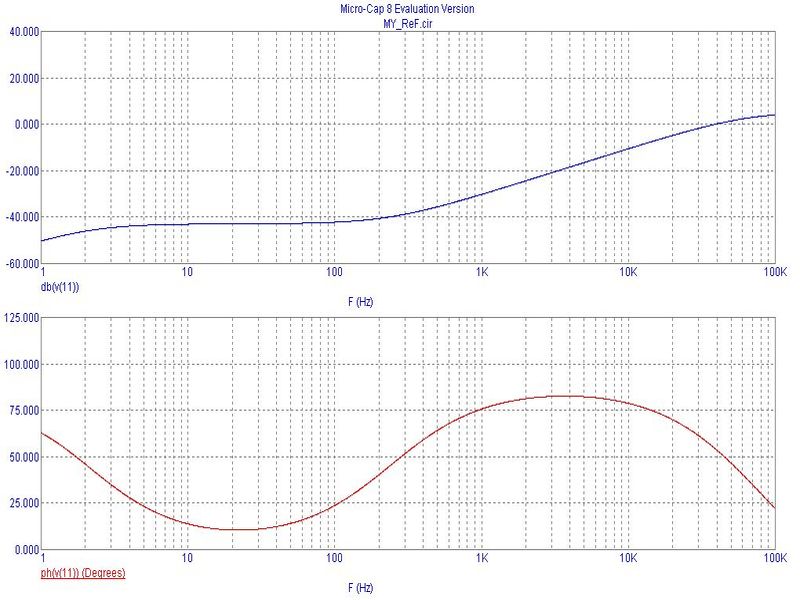

Following the study of the Graham Maynard methods for the amps analysis ,I am preparing of the changes on My_REF, to improve the general linearity and verify his theories.
For anyone doesn't follow the Thread in Solid State forum or on WW, say that is treated of inject a signal on the output of the amp, with the same technique that it uses to measure the DF ( damping factor), to analyse the behaviour in frequency and phase of the amp.
More it is constant the damping and ( over all ) more is constant the phase to all the frequencies, more ( in accordance with Graham and in accordance with me ) gets a sound " clear and equlibrate ".
Graham have works of " class A to AB" solid state, but my circuits serve to show that even a "class B Chips amp" holds the comparison.
How to introduction, I show you the simulations of the My_Ref "evolution" , till the actual state of my prototype...
Step 1. My_REF "base":

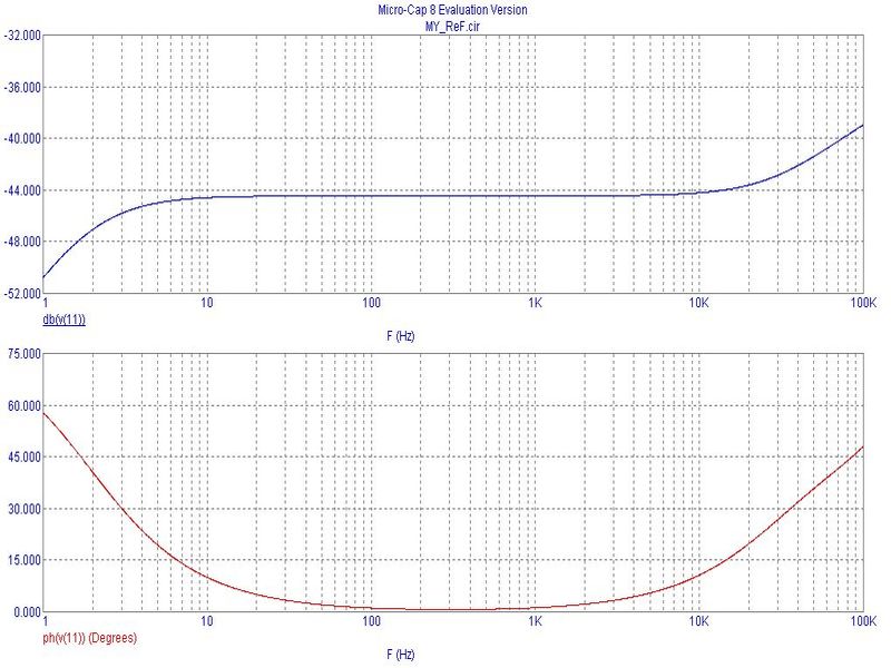

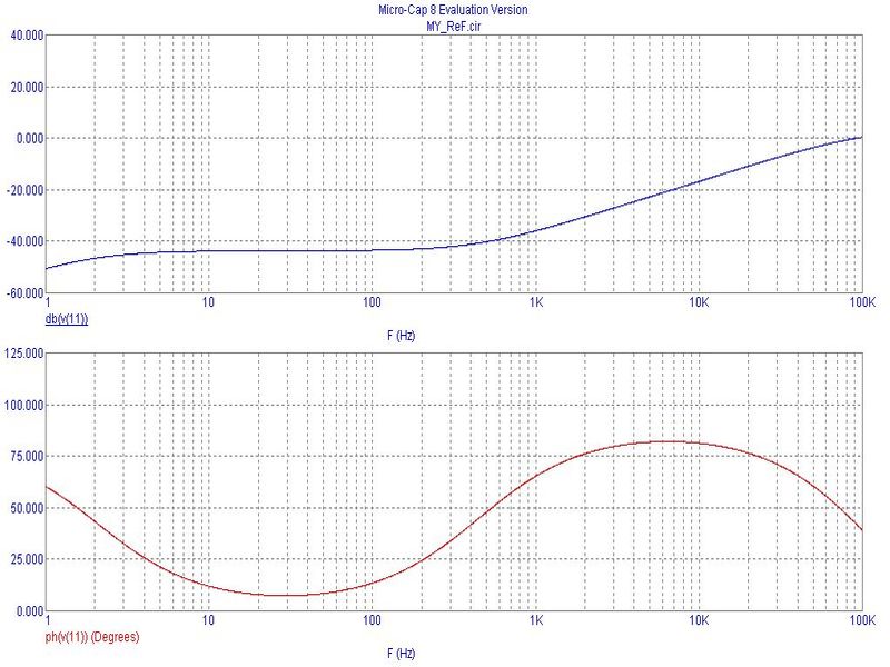

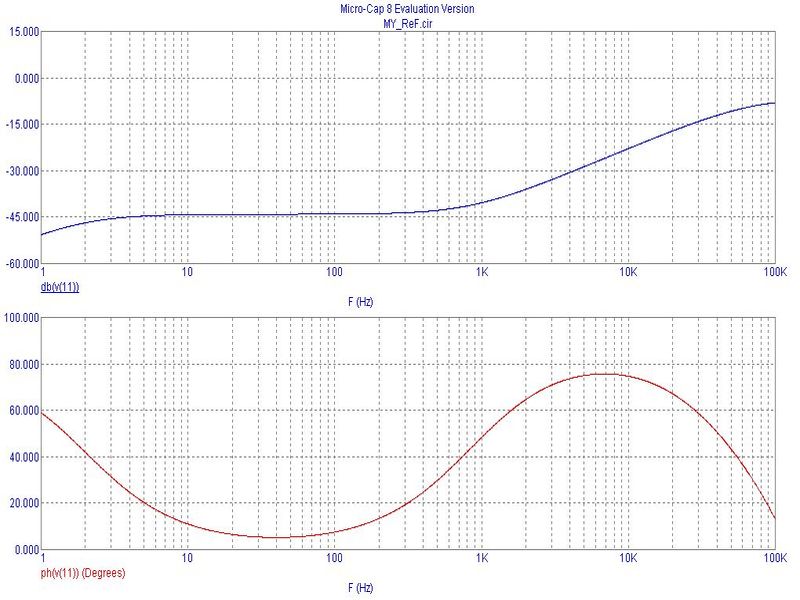

The Rev3 schematic.
R41-R42 reduces the RF "spikes" of the Main PSU ( induced by the SPKs cables ).
C30-C31 are increased to 1nF and R37-R38 reduced to 3k3. This net stabilizes the LM3886 oscillations, reducing the high frequency efficiency of the bridge.
C34+R43 and C35+R44 increase the internal compensation of LM318.
R39-R40 reduce OLG ( open loop gain ) to about 65dB, and the OL BW to about 20Khz.
C10-C25 is the Feed forward that compensates the inductive components of the output bridge, increasing the linearity of the damping.
A better description when finds the time to write it...
Ps. I Suggestion to perform this changes to experienced Diy members, in degree to perform un tests of verification. How to have always written, this circuit is "extreme" and they serve to study any combinations, and to show the level of "audio quality" that is it may reach with the Chips amps. In particular , my objective is the emulation of the class A (A/B) solid state amps...
