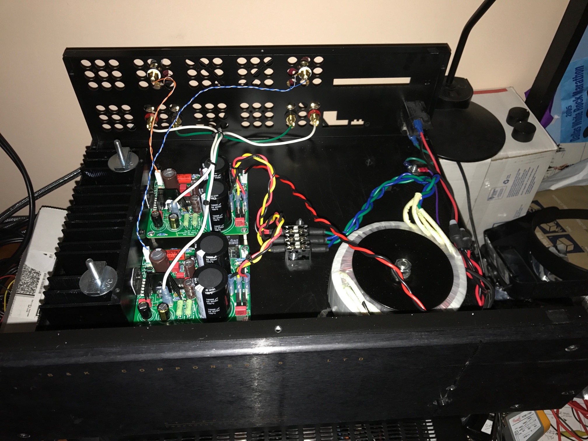

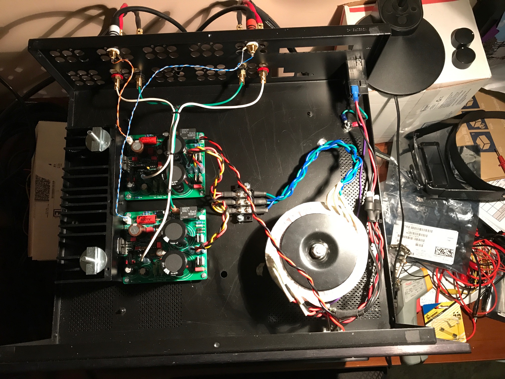

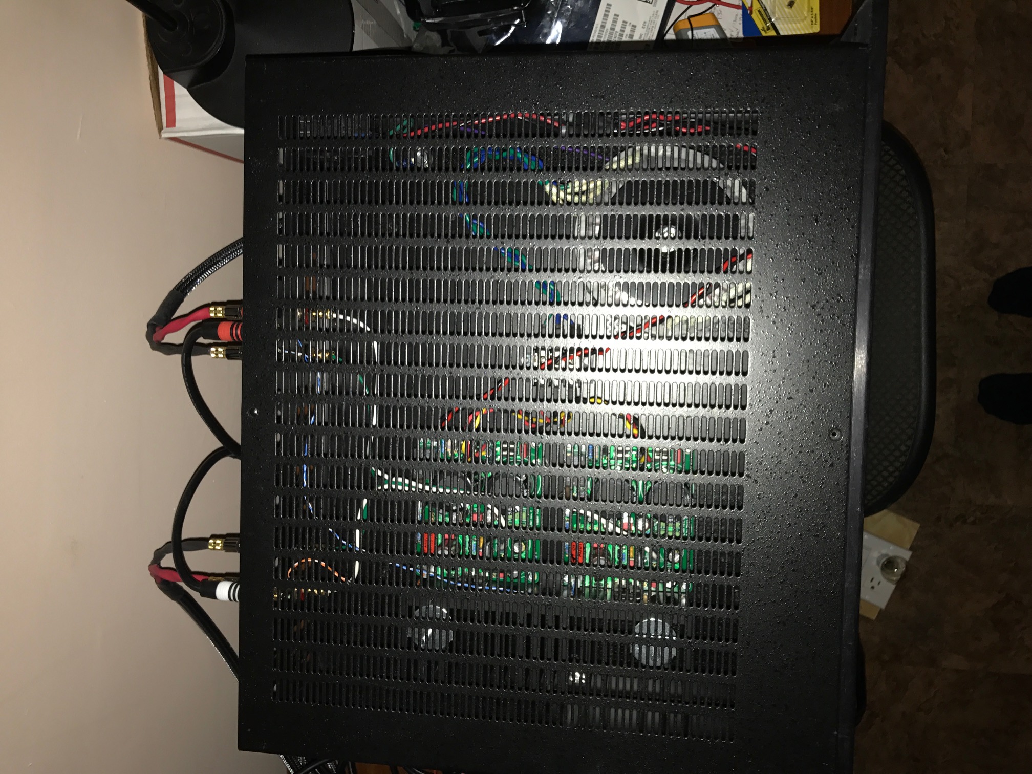

Well I finally got this little "beast" put together and working. Couple pics attached (not sure why some are one way preview and turned pulled up, oh well.).
ONE PROBLEM - I get a hum and about 0.5 VAC on the speaker terminals if I don't have anything plugged into the RCA's. Is that normal on a chip amp? This is my first LM3886 amp, but have a IRS2092 (eBay) a ADCOM and B&K Class AB amps and they are all silent without RCA's plugged in.
I measured 1.0mVDC on the left speaker terminals and -3.7mV on the right speaker terminals (w digital DMM)
I played it for 10-15 mintues 3 times on Tuesday/Wednesday making sure it was stable and not over-heating. Last night I let it play for over an hour, without any issues. Chips stay at or below 80-degrees F, heatsink is room temperature, about 75-degrees F. Even the caddock resistors, which have a huge heatsink only get to 90-dgrees. The 2w resistors only show 80-degrees. So I don't see any performance/heating issues, so it must be wiring problem.
It plays just fine and is a very nice sounding amp. As long as the RCA's are plugged in, there is very little hum (have to have ear on the speaker to hear anything) with both a laptop playing Spotify/Pandora, or a iPhone playing Pandora or iTunes. I can pause either device and there is very little hum.
I have tried moving wires to see if that helps, but I can't get any change in sound or loudness. I did verify that although the return for the RCA is isolated from the rear panel (plastic washer), it still has continuity with the IEC ground point. Is that right? The RCA return goes back to the PCB, but the heatsink, RCA returns and PCB mouting screws all show continuity with the IEC ground bolt?

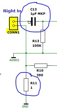

The offset on the speakers is supposed to be measured with the inputs shorted. Are you sure that the hum is not actually from your source connected to the inputs? This amp is totally silent with the inputs shorted. The audio ground is separated from the common ground by 1ohm resistors. Is your source connected to the audio ground or the common ground?

Yes - I have the RCA's connected to the Input +/- on the PCB and R11 is populatd with a 1ohm resistor on the PCB.

I think we are saying the same thing, but maybe I'm not saying it clearly. Yes the (+ or center RCA pin) goes to the "top circle" CONN1 to the 1uF Cap and (- or return RCA barrell) goes to the other CONN1 pin, through the 1ohm resistor. So I think it's correct and wired according to the schematic I have.

You did everything correctly. It has been reported in the past that with open inputs there is noise however with a source connected or input shorted it should be silent.
Nice reuse of a chassis...
This particular amp has thrown out a lot of best practice and assumptions out of the window (at least in my case). The way it is truly a differential amplifier, the concept of virtual audio ground etc. has surprised me in many ways. I may be attacked for saying this but I have no star ground, no common ground between the cross over (which had its own supply, chassis is totally isolated from any potential, I have no earth connection to anywhere) and this amp has zero issues (so far).
