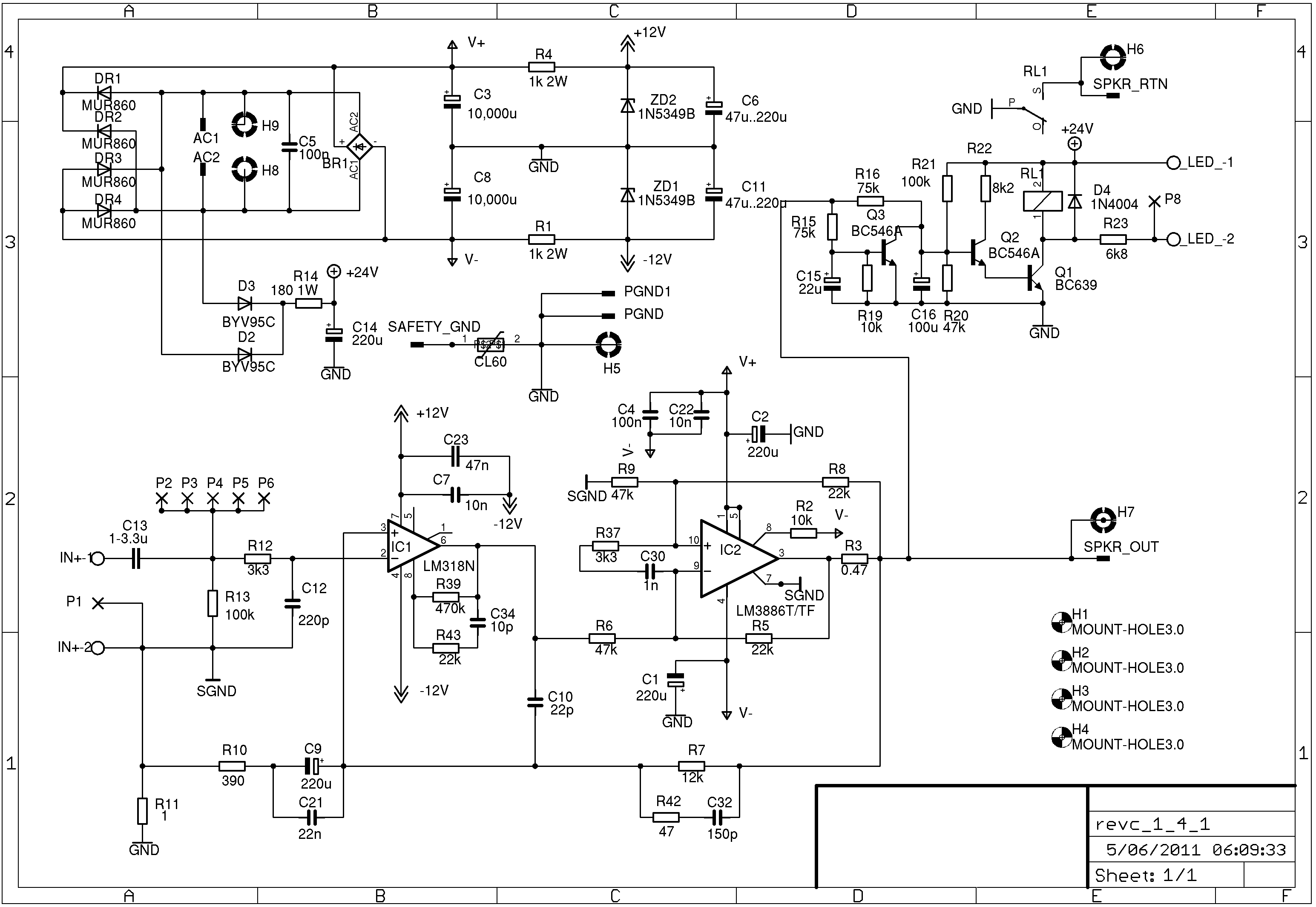

On the PCB - there is a designation for C22 (10n) - right next to the chip, but I can't find it in the BOM or schematics posted for the Rev C only the Rev A as part of the PSU.
Since it wasn't in the BOM I didn't order it, but need to know if it is necessary or optional? If optional do I leave it empty or use a jumper?

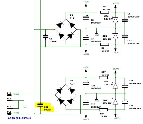

Here is a "snip" of the schematic and original BOM list, but only can find it in Ref A, not Ref C, weird. Thanks for the reply.

C22 is a bypass cap for C4 (rail to rail decoupling). Not needed if C4 is already hi quality. Most definitely DO NOT use a jumper!
I took a closer look at the schematics and C22 appears across the AC inputs to the full wave bridge, while C4 is across the FWB DC outputs. The function of C22 is to snub ringing in the diodes in the FWB when they turn off.
There is an old article called "Diode Snubber Design" by Jim Hagerman. http://www.hagtech.com/PDF/snubber.pdf that better explains why you might want this cap in circuit than I can.
The author suggests that a simple ceramic disc capacitor can be effective in this spot as some lossiness is desired. If you have soft recovery or Schottkey diodes in that bridge you might not need the cap, but it's not going to harm anything either.
Rob
Rob

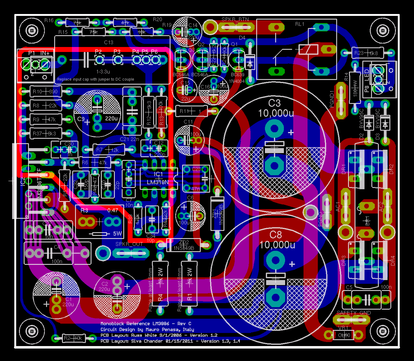

I think you are confusing C22 with C5. On the schematic I posted , C22 and C4 are clearly wired in parallel between V+ and V- of the LM3996 chip. They both run rail to rail on the DC input. This is also clearly confirmed by the PCB layout.
I assume the Ebay boards, used in this case, are consistent with Mauro's schematic.
post4525 shows C22 wired across the two outer taps of the centre tapped transformer.
Post4526 shows C22 wired as the HF supply rail decoupling capacitor for the +ve rail.
Post4532 shows C22 next to R3 and is across the two supply rails
The sch in these three posts are not compatible.
Which C22 is Bullit asking about?
I responded to the schematic attached in post #4525 by user Bullittstang. On that diagram, C22 is a snubber for the diodes in the bridge.
Since Bullittstang did say that C22 is next to the LM3886, what you said about C4 and C22 are likely correct and the board layout and schematic you posted correlate.
Actually, in the photos of the boards posted by Bullittstang is does say rev3.

I believe C4 and C22 are wired in parallel. The capacitor should be as close to the LM3886 as you can place it. So I would not populate a 10nF capacitor but would move the 100nF capacitor from location C4 to location C22.

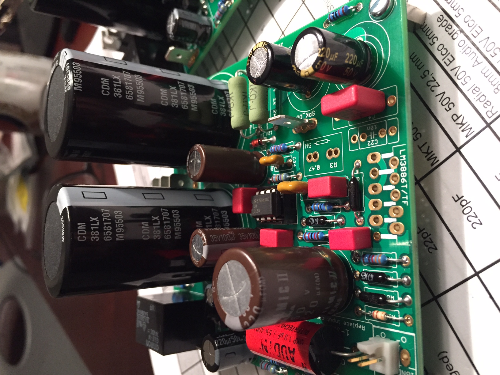

Andrew - yes you have good eyes not the exact design layout, but same circuit (I should have been more specific) I did take a pic of the board (front and back) and C4 and C22 are both across the V+ and V- supply tracks.
