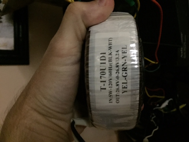

I finally got everything together and did some voltage tests. Both boards were within 0.05 volts on all tests. The LM3886TF's are not installed yet.
Toroid (no load) - 29.56 and 29.53
LM318 (no load) -
pin 4 = -12.31
pin 7 = 12.23
LM3886 (no load)
pin 1 = 40.2
pin 4 = -40.2
pin 5 = 40.2
The toroidal is rated at 26.7-0-26.7, but apparently is a little higher at 29.5. So the final voltage to the LM3886 will be higher than I expected, instead of 38Vdc I'm getting 40Vdc. I plan to run 8 ohm speakers (very easy load) and be a desktop system, so fairly low volume. Am I safe using this Toroidal at least for a few weeks to make sure the build is worth spending $$$ on a new toiroidal?

It will drop but that transformer is not quite suitable for the lm3886 , your chip will overheat , your amp will start clipping right away so I think you need to drop
at least 5 volts each rail, you could rewire the transformer or you could use an voltage regulator circuit, a little bit of heat dissipated there, or you could trade with someone. I think I have some. What transformer is this?va?
If you would use it with 16-32 ohms speakers , it might be good.

Could you point me to a good adjustable voltage converter (AC) or describe how I could use zener's/diodes or resistors to drop the AC voltage by 4-5 volts? I'm a beginner, but know electricity safety and experienced with a DMM and able to following a diagram/instructions. Just hoping to "test" this before comitting to $50 for a new toroidal.
What' the va value for your transformer?what model / brand?if it's 300 I could trade a 300va 3222 as antek for yours, let me know.

Unfortunately your transformer would not provide enough power for what I need.
You might be lucky with the LM338 regulated supply The max voltage in for LM338 is 40 V and you are just a little bit above that , P.m. me for a couple of boards
