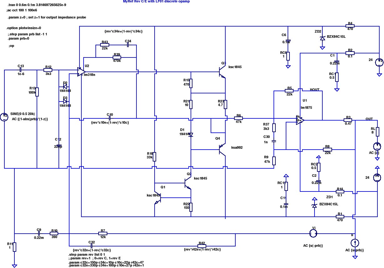

I do wish we had someone doing some spice simulations. But it seems nobody is doing it. I guess it's just like going to the bathroom, if it needs to be done, best do it myself in private.
It's difficult to simulate the My_Ref without having complete models of both the LM318 and LM3886.
Unfortunately no one has developed such models until now...
I thought Mauro and linuxguru were both doing SPICE sims.
Mauro did some sims in the initial phase of development, when compensation pins of the LM318 were not used.
LinuxGuru has managed to do a partial simulation using a LM1875 (if I remember correctly) model instead of the LM3886 and a customized LM318 model.

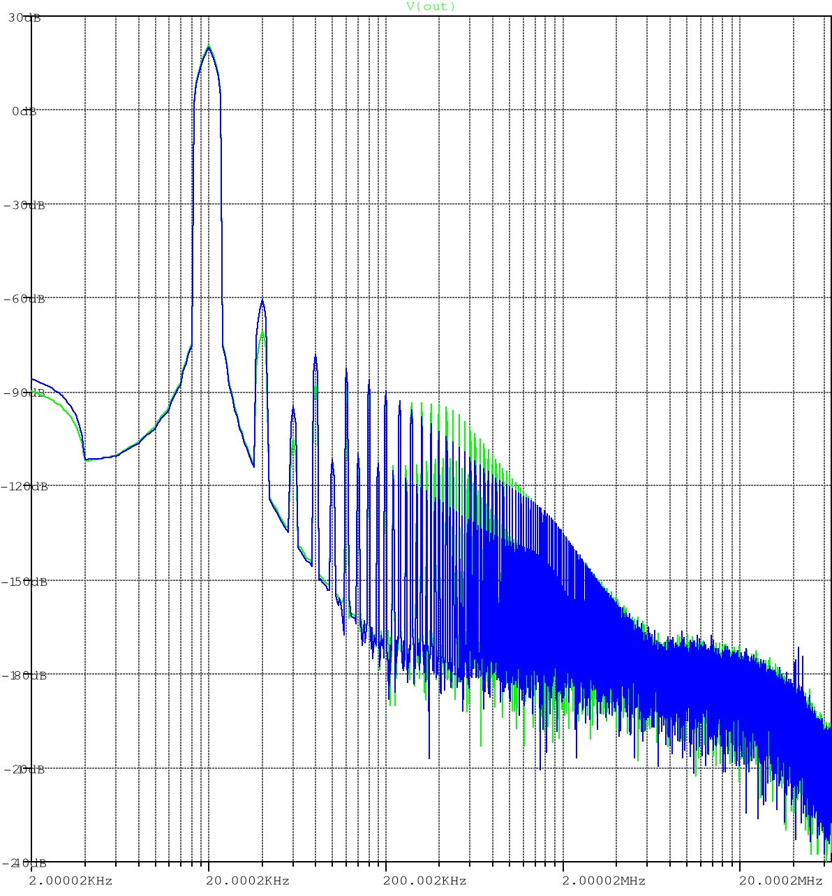

Yup, that's correct. Here's the LTSpice simulation schematic with those models, and the preliminary THD20 FFT plots at ~15V amplitude output into 8R. The FFT plots for Rev C (green) and Rev E (blue) are shown.
As always, numerous caveats apply:
1) This is not the schematic of the original MyRef - this uses the LF01/LM318 discrete hybrid module, and some other minor modifications to keep LTSpice happy.
2) The models of both the LM318 and the LM1875 may be inaccurate.
3) The THD20 plots may be completely irrelevant to the audible sonics.
4) There may be various simulation artifacts that may not be reflected in the real MyRef behaviour, and vice versa.
With that disclaimer out of the way, my interpretation of the simulation results is as follows: Rev E has higher distortion (larger C34 contributes to higher distortion, while larger C32 contributes to lower distortion - but the net effect in Rev E is higher distortion) compared to Rev C, but it's almost entirely higher H2 and even harmonics. The odd harmonics quickly drop below that of Rev C. Moreover, the cascade of harmonics in Rev E is closer to the classical Class-A linear drop-off, which may contribute to better audible sonics. The net audible effect of Rev E is likely to be greater warmth, and smoother presentation, offset against higher distortion ('coloration').
